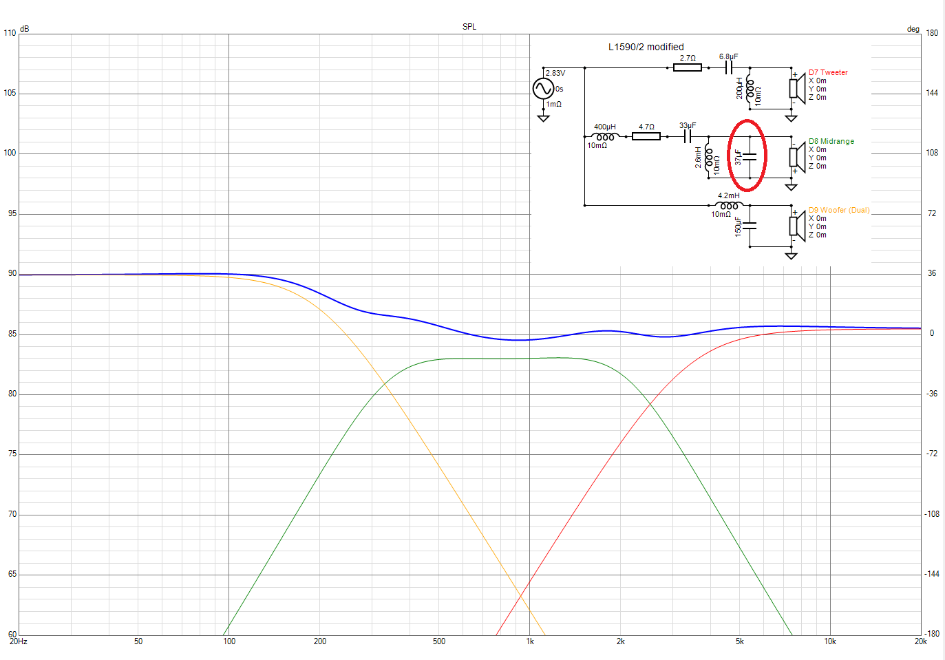

Okay, here is the simulation result of the original crossover. As you can see, there's definitely a spike on the upper midrange, around 1.5-3.5 kHz, as depicted in red circle.
I started tweaking by adding single resistors to tweeter and midrange circuits and lowering low-pass filter of the woofers. This is aimed to reduce midrange and tweeter levels.
Next, I move to tame the midrange spike. I performed by adjusting the low-pass's capacitor of the midrange. From 15uF to 37uF, the response curve has now become flat.

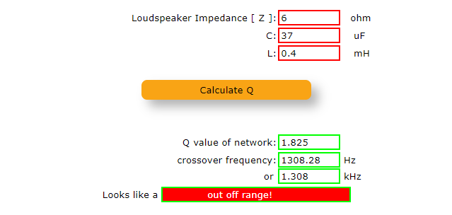

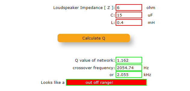

1) According to the online calculator, the original 15uF and 0.4mH filter gives Q of 1.162, whereas the modified 37uF and 0.4mH gives Q of 1.825. Both Qs are considered to be quite high. So, will it cause any problems, e.g., impedance issue?
2) Will it cause problem from using the 37uF for low-pass of the midrange in which it's larger than 33uF of the high-pass's section?
