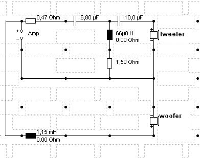

Hi everybody,
I would like to reopen this thread - thought I won't open a new one for that. I have a pair of 602 S3 and recently looked inside, willing to do some tweaking with the crossover.
To my amazement, the filter is not the usual second order ! I attached a schematic - the inductances of the coils are measured.
So:
- it looks like a first order (1 coil) on the woofer and a third (!) order on the tweeter.
- on the filter PCB, there is place for a Zobel on the woofer (R + C across woofer), but these have been ommited (on purpose ?)
Now, I know that it's rather impossible to tweak the filter without driver parameters. But what do you think, can I improve anything ?

the simple answer for the 602 S3 is you can't improve the crossover.
The crossover is probably asymmetric 2nd order acoustic
on the bass unit with 3rd order acoustic on the tweeter.
Asymmetry can help in compensating for the tweeters
acoustic centre being forward of the bass unit centre.
/sreten.
