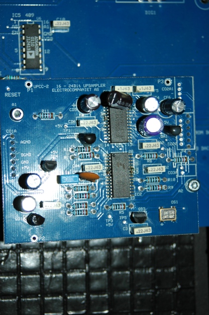

I have a Electrocompaniet ECD-1 and thinking of to do some tweking on it.. Have read some less good things about the CS8420..
Maybe bypass the SRC or changing PLL filter value, they are not like Crystals optimization! Rfilt=1,8KΩ, Cfilt=0,47uF and Crip=8,2nF
Or simply rip of the CS8420 and use CS8427 instead?
And the CS4397, have read about a mod of the CM out, pin 25. It's to put a 1KΩ to +5VA and a 1KΩ to AGND.
I have done some updating of caps and put chip caps close to the CSxxxx V in. I think it did some use to the sound, clearer and more space. But it could be the placebo effect..
Bypassing SRC
Have test to bypassing the SRC by lifting pin 27 "DFC1" (HW mod 1 -> 4), the output fq change from 96 to 44.1kHz but no sound..
Do I need to change the master clock from 24.576MHz to 22.5792MHz for the CS4397 to work with 44.1kHz?

Put some inside pictures of your device and I would guess this could induce more interest on this thread?
I have Abrahamsen V6.0 which should be very similar?
Thread in a finnish forum with pics of my device
I thought the question was rather straightforward but I include a pic of the receiver and DA board and hope it will do it

The stock is CS8420 and I want to change it to an CS8416, but it will be some work, it's not completely pin compatible.. I wanted to do a try with bypass the SRC on the CS8420 but it wasn't just lifting pin 27 and change the crystal fq to 22.5792MHz..

Have heard about an adapter for the CS8416 to fit on a CS8420 pin layout, is that true?
