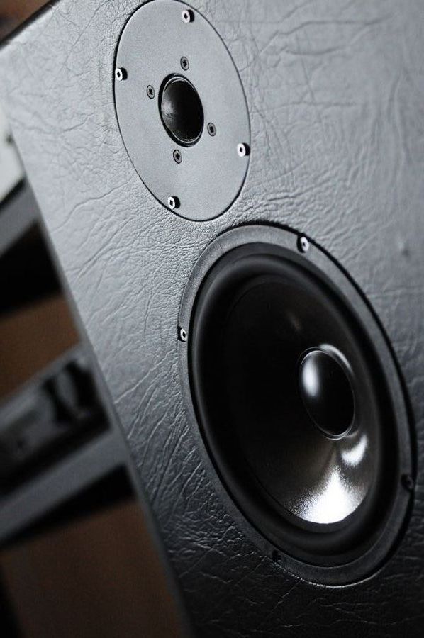

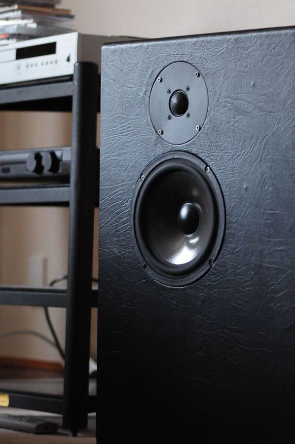

Right, I have finished building the Wrap for this project out of a mix of Ply and MDF. 18mm for sides and back. Front baffle is 18mm Ply.
The walls have been lined with sound deadening bitumus type product and 12mm foam. Which leaves the driver placement on the front baffle.....
I have had a play with the software above and to be honest I do not know what I am doing. Can someone assist by giving me some dimensions or further ideas on how to read what the edge is telling me so that i can get on with mounting the drivers.
The front Baffle is 450mm X 680MM
They are then to be finished in Rimu Veneer...
Mark
Mark

For the tweeter yes, as you describe. But Thorsten talked about both ''drivers'' which means you better avoid for the woofer to be smack half way baffle height at least, too.
Basically for large baffles and a vertically aligned 2-way :
Mount the drivers centres near 0.6 of the baffle width.
Mount the drivers close together.
Mount the tweeter distance from the top such that its
centre is near 0.6 of the distance to the nearest side.
This is assuming you want to minimise diffraction ripple,
it some cicumstances it is possible to exploit the effect.
🙂/sreten.

Ok I get...
420 x 0.6 = 252
so
centre line for the speakers is 252mm from one edge. Mirrored for left and right cabinets.
the tweeter is mounted with reference to the top and 0.6 of the nearest edge measure
420 - 252 = 168
0.6 x 168 = 100.8
so the tweeter centre point is 100.8mm down, 252 mm in from the edge. Mount the woofer close to the tweeter on the 252mm "centreline"
Have i understood correctly?

Thanks to everyone who has assisted in the design,
Much appreciated. i am very happy with them.
