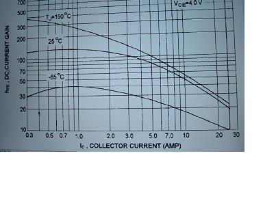

I am making an amp using outputs with this gain curve to drive low impeadence, mostly lower audio frequencies. Certainly not a HOT, but I suppose it would still require some correction to linearize. Experimenting is the best part of DIY...😀 DC SOA limits at 20A with 10V Vce and 9A with 20V Vce.

I'm using darlington pairs here (BD139+MJE13005 Now). But... Will'nt the hfe curve problem of the power transister make problems inside a darlington...? NON-LINEAR (Hmm.. thats the problem, which wasn't actually a problem for me before posting and hearing to this thread 🙂 ) current flowing from the emitter of the first transsiter to the base of second one...?
Actually, in darlington, the output transistor will act more like the driver than it itself. I would have to perform some type of analysis on this, but I imagine that it might help with linearity problems of the output itself.
I do know that this will help with current gain anyway.
quasi: What I'm saying is that in an audio amplifier, the darlington configuration is one method to drive the outputs, as compared to CFB pairs or other methods.
It seems to me that since in a darlington configuration, the overall beta is the product of the betas of each transistor so the nonlinearity will still appear even if the driver is linear in the operating region being operated in.:xeye: The input impeadence of the pair will be that much higher allowing the gain stage to correct for that nonlinearity with less current. Not 100% sure on this though, so experts feel free to correct this assumtion if it is wrong.
