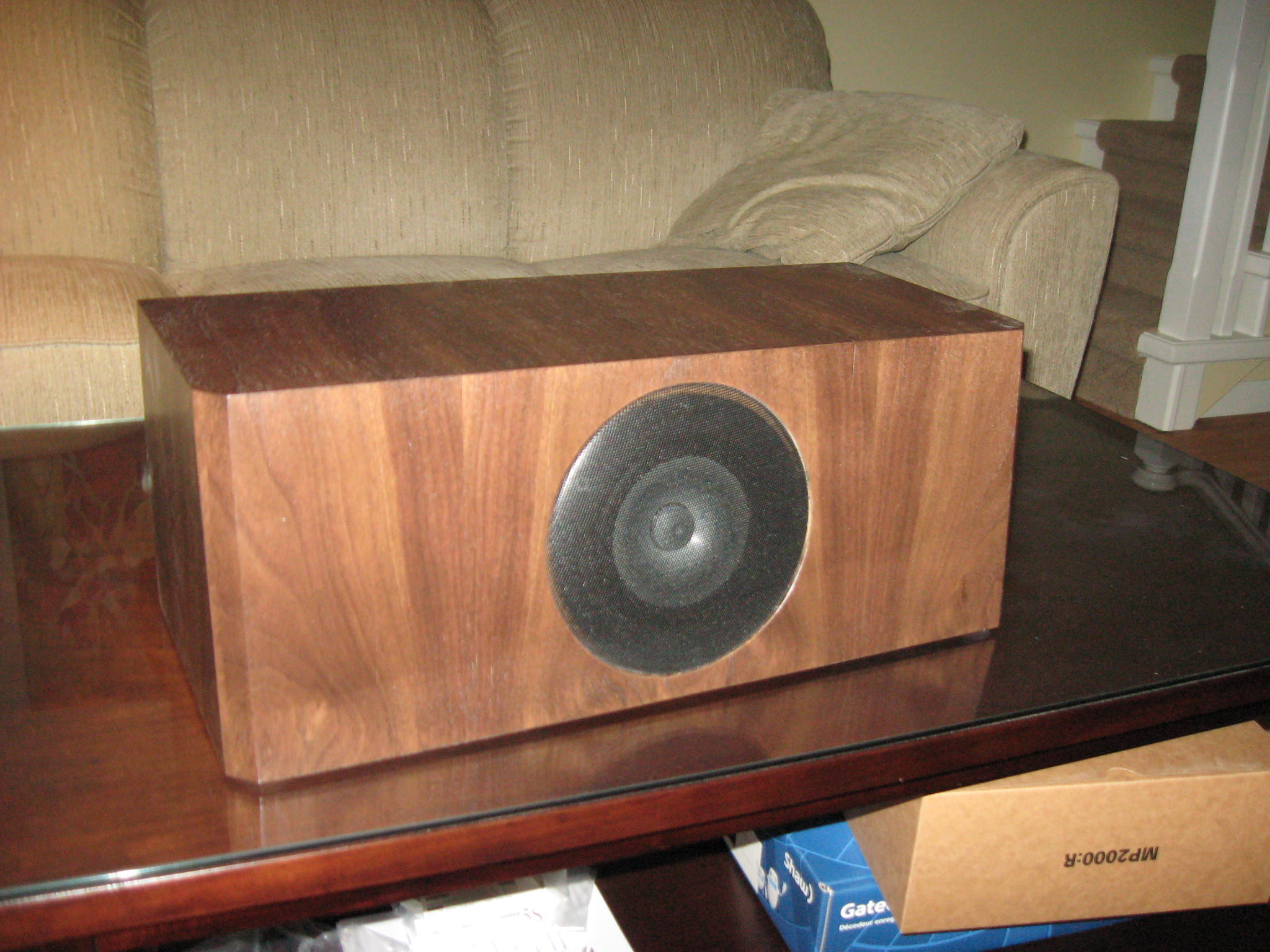

Not to contradict Dr Moose, but I've built a couple of successful front vented enclosures with the A10 - in fact my current center channel with A10P is one of Dave's designs.

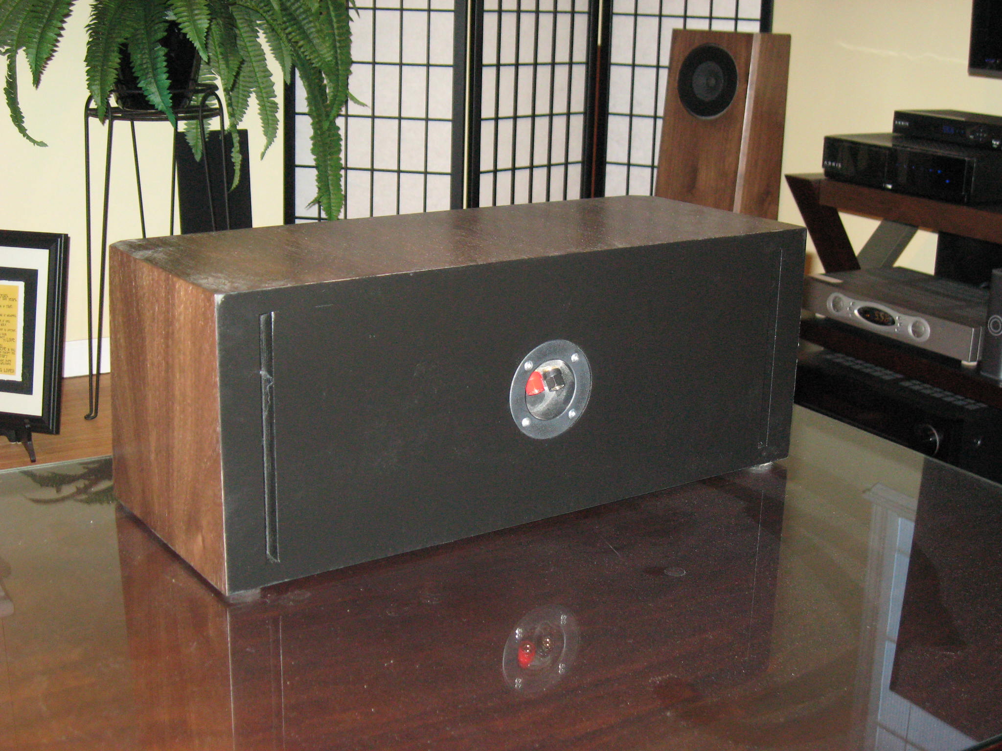

edit: just dug out the sketch from Dave for my A10P center enclosure: 496mm W x 206mm H x 229mm D. Front baffle slanted forward at 5dg, a pair of 9mm x 150mm slot ports at each end - rear vented in my case since the system is on an open stand with at least 300mm to the back wall .

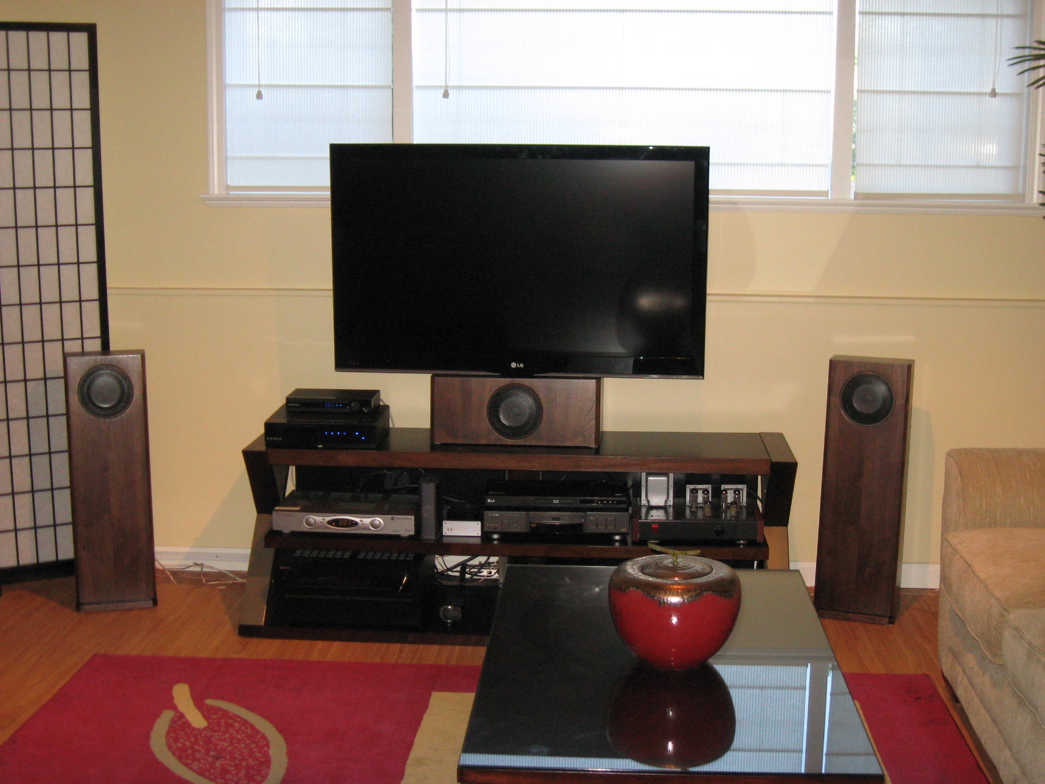

frazier - yup all home made - have played around a bit with the front row over the past year, but current configuration is:
-L&R mains - A12PW/A7.3 MTM, passive XO @ 300Hz (might even try the MAOPS in there? )
- Center - Alpair 10P or 10.3 in small vented enclosures - the10.3s are a better match to the 7.3 in mains
- Front Height Surrounds - MA CHP70 in mini onKen of some nomenclature
- Rear Surrounds - Alpair 6.2 metals in tiny sealed
- "Subs" - dual Eastech 7" woofers per side in corner mounted vented enclosures. - Probably now the weakest link for deep extension, but that's something to look forward to upgrading, I guess.
