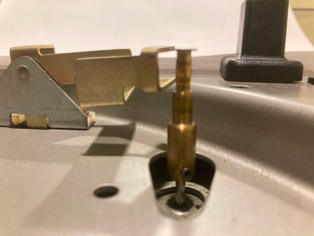

Those are very useful considerations, but is there a way to fix the speed issue on this turntable? Or at least find out what's causing the problem.
Could you attach a picture of the pulley with the belt removed? The data sticker says 50/60 Hz, an I suppose there must be some mechanical trick to change between the frequency used. Or the subplatter has a step in the diameter.

It says the 50/60 Hz switchover is done by the pulley replacement. There is also some height adjustment. I assume if the height of the pulley is too high, the belt slips down from the 33 barrel centre towards the 45, but not fully. This could explain the slight speed increase.

A synchronous motor will always run at fmains*60/N RPM, where N is the number of poles. So there's no way for the motor to run fast unless the mains frequency is off, which it won't be.
Bummer about the "50 Hz pulley". Can you get one for 60 Hz? It looks like it has a set screw holding it to the motor shaft, so it should be trivial to replace ... if you can find a replacement.
I wouldn't try to file it down. A better approach would be to get to know someone with a lathe and just make a new one.

No, don't do that. Try wrapping electrical tape around the platter where the belt runs, one wrap at a time and check the speed. Make sure you cut the tape diagonally with an xacto knife, so there's no gap or step. If that doesn't slow it down enough, than you're going to need the proper pulley.Maybe I can file it down to slow down the platter.
jeff
I tried a similar thing before. Used several layers of rubber belts. Did not notice much difference in speed. But now, when there is a clear understanding how that thing was designed - it may be easier to deal with. 👍
Mechanical speed changes are easy when carried out by adjusting the gear ratio. In this case, the 50Hz pulley diameter needs to be 60/50 = 1.2 times in order to bring the speed back to normal. That is a significant increase of 20%.
