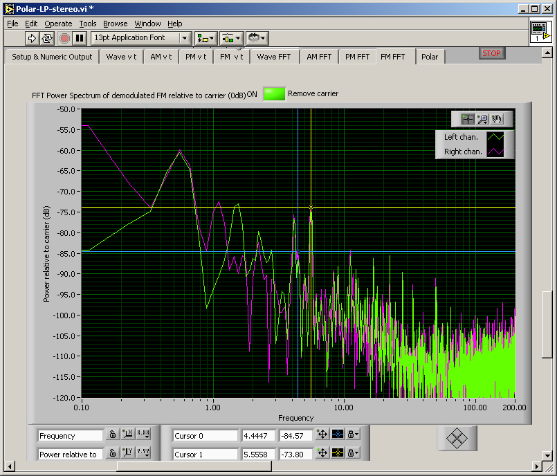

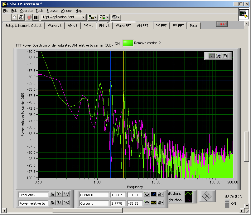

I don't understand those using undamped uni-pivots. Even if they are preferred so, this is probably due to some distortion components.
I think the point is that even it you see initial wobble you cannot be sure how this interferes with the 0.555 Hz disc eccentricity. Note that the "overtones" may be had at 1.1 and 1.6 Hz. My Moerch did not have any visible wobble even undamped but did have distortion that could be related to the 0.555 Hz disc eccentricity. With the 600 000 cst it behaves like a conventional arm when cueing and has no distortion related to this.
Well it is not that far from the subject. Knowledge of the actual disturbances in vinyl playback does help in designing the turntable and arm. It is a mechanical system with multiple resonances and those should be handled by frequency or damping to avoid that they are excited by the medium itself.
With respect to audibilty, it is a tricky question. But to be sure one could go for the known thresholds of hearing and then place that far below that threshold. If not possible, as low as it can be given the system. In this case it would be FM and AM modulation of the signals.
I'm with Thomas. There are so many known and audible sources of FM and AM in a turntable it seems daft not to use the tools at our disposal to measure and minimise them, otherwise you are chasing a magical effects box with no idea how you got there.
And I think this IS on topic as worth considering for the OP before he puts anything from 10s to 100s of man hours into a project!
