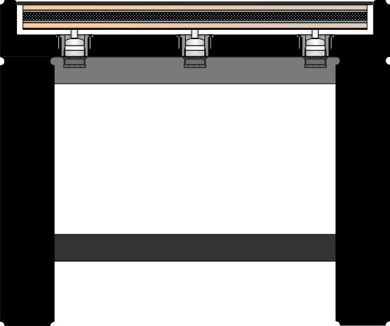

I'm building a rack to place my TT on. Generally it's a wood made stand with 4 feet filled with stand, and a shelf on top of them (simple, huh?). However, on the shelf on I will place 4 ceraballs (from Finite Element) which I already have and then on top of that a platform for placing the TT on.
For this platform, I've been working on designing a Symposium clone (like their super plus platform: http://www.symposiumusa.com/platforms.html). The general idea is a layer of rigid, closed cell foam in the middle, an then going outwards several layers of materials, the outermost being aluminum. The idea is each layer is not to far in terms of acoustical impedance from the adjacent layer, so that vibrations flow easily from the outer layers (the top on which the TT stand and the bottom that faces vibrations from the ground) inwards to the lossy foam layer, where they should dissipate.
What worries me is that although the foam is non-resilient, it still has some compliance to it, and I'm afraid it will "kill" the sound.
So before I make any stupid steps - does anyone have experience with placing such a platform under a turntable? Maybe better ideas?

And while you ponder about it 😉
Here is the idea of the design
The Ceraballs will be placed on Auminum elements that will enable to level the whole thing.

So, Sreten would you say that in my design the inner foam layer
would act the same as your squash balls, and if I make the outer
layers massive and heavy, it would have the overall same effect?
Cheers
-T
I would not say that. I've looked at the design of your turntable and
what I'd use is a massive solid slab (e.g. slate) on 6 squash balls.
🙂/sreten.
