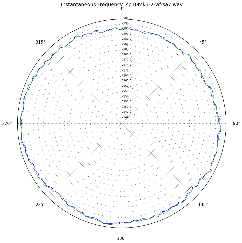

Interesting. On the polar for the MK3 there's a speed variation at 45 and 315 deg that corresponds with a noise I can barely hear at the motor - I suspect a bearing issue. I've four other MK3 I can measure so we can increase the sample pool there. Still, the R looks remarkably good.
Thanks Volken. Always wanted to see measurements of Classic Vintage Turntable. How to interpret the graphs ? I presume the test track was 3K and narrower the band the more stable the speed. Right ? Original Thorens had wow and flutter measurements was 0.05%. It would be wonderfull to see Garrrads and Lencos measurements.
Regards.
Yes A 3khz testrecord with FM sidebands first tonearm/cart freq. second motor rotational speed , then belt flutter and the cursor at 100hz motor vibration.The sharp peak is a indication for speed stability very low wow fig.

I guess heavy platter with some constant load heavier than other tonearm+cartridge criteria which affects speed stability (like spool tapes having felt disc ) can somewhat stabilize the speed. Isn't it ?

Bumping this thread again for a short question. Was there a program developed that can be shared free, used for polar plots? I have not read the whole thread, just to know if someone knows. Lucky, Billshurv?
Scott Wurcer made a program for this purpose.
Was meant to be supplied for free when I’m correct.

It was some Python script, IIRC.
Yes, it was, I have used it.
Unfortunately, I have changed computer since I uploaded the code so don't have a copy available. IIRC I used Anaconda/PyCharm to run it. Works OK and quick to get results.🙂
Found it, it was part of the TT Speed Stability thread - see here This is issue 3 of the code Scott (Wurcer) wrote.
But this wasn’t the final version, was it ?
Hans
Hans
AFAIK, I downloaded no later one (just checked the disc drive from the old computer). Scott is the person to ask.
The third issue is attached.
View attachment polarplotrev3 .txt
