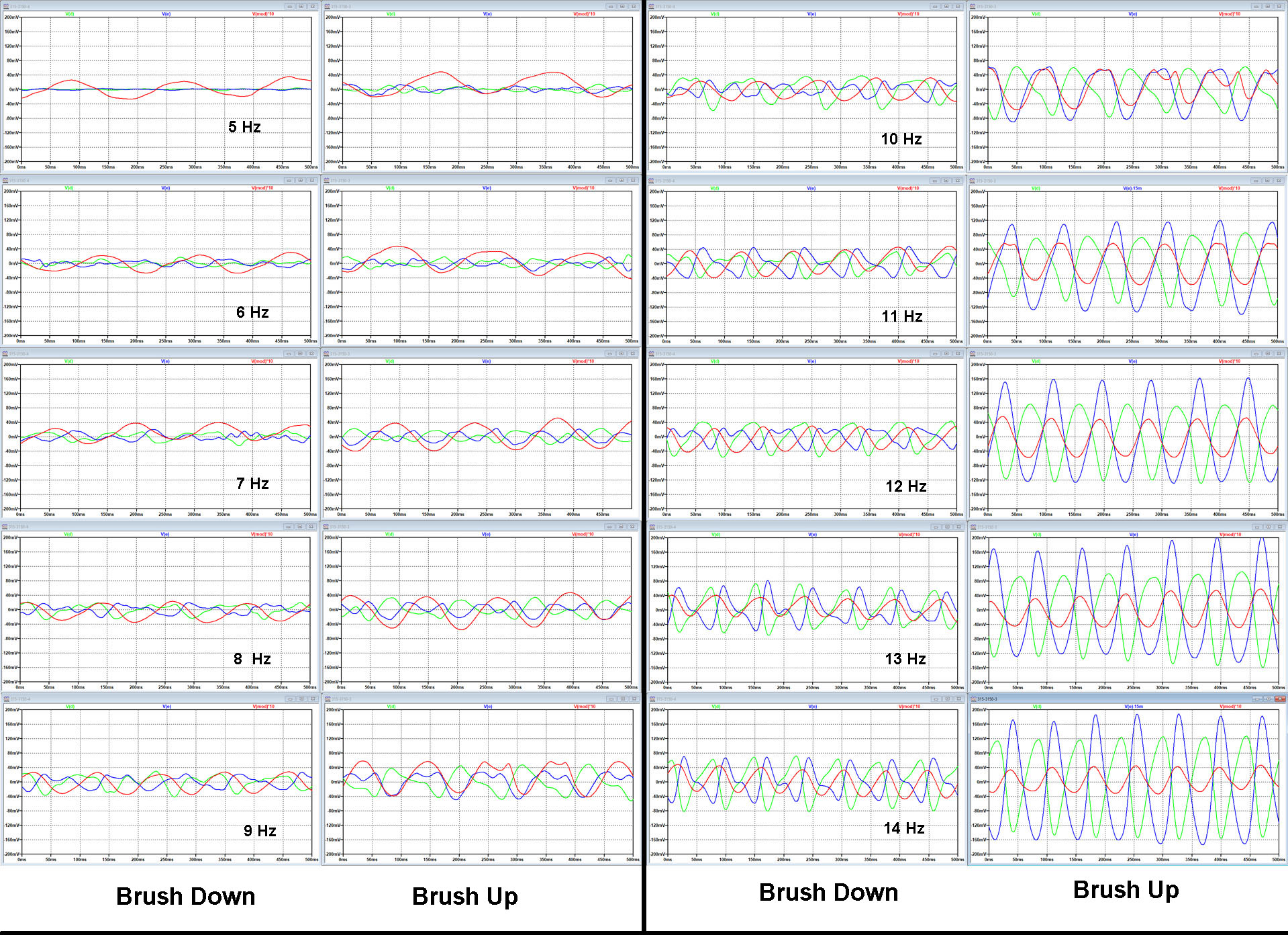

Here's my submission, in summary form, attached.
Looking at FM variation of the 3kHz carrier in the time domain, using polar plot format. For these plots, tramlines are at 0.2% spacing and all plots have same scale. Inset spectrum graphs have the same scale for all plots so can be compared directly.
All is not as clear and well as one might expect or hope.........isn't life just like that sometimes....? Perhaps the adjacency of the 2nd carrier, perhaps phase artifacts of whatever audio compression was in the youtube source file.......?

Thanks for putting everything so neatly together, results are similar.
That saves me the effort for doing the last 4 frequencies from 11 to 14 Hz.
The reason why I did this in the first place was because we had the discussion whether it makes sense to combine a 3150 Hz carrier with a sweep from 5 to 25 Hz.
Looking at our results, I think that the answer is that it does not seem to bring very much to put something like this on the test LP.
The only nice thing made visible here is that a brush effectively dampens the movement of Cart/Arm and reduces the FM modulation because of that.
Hans

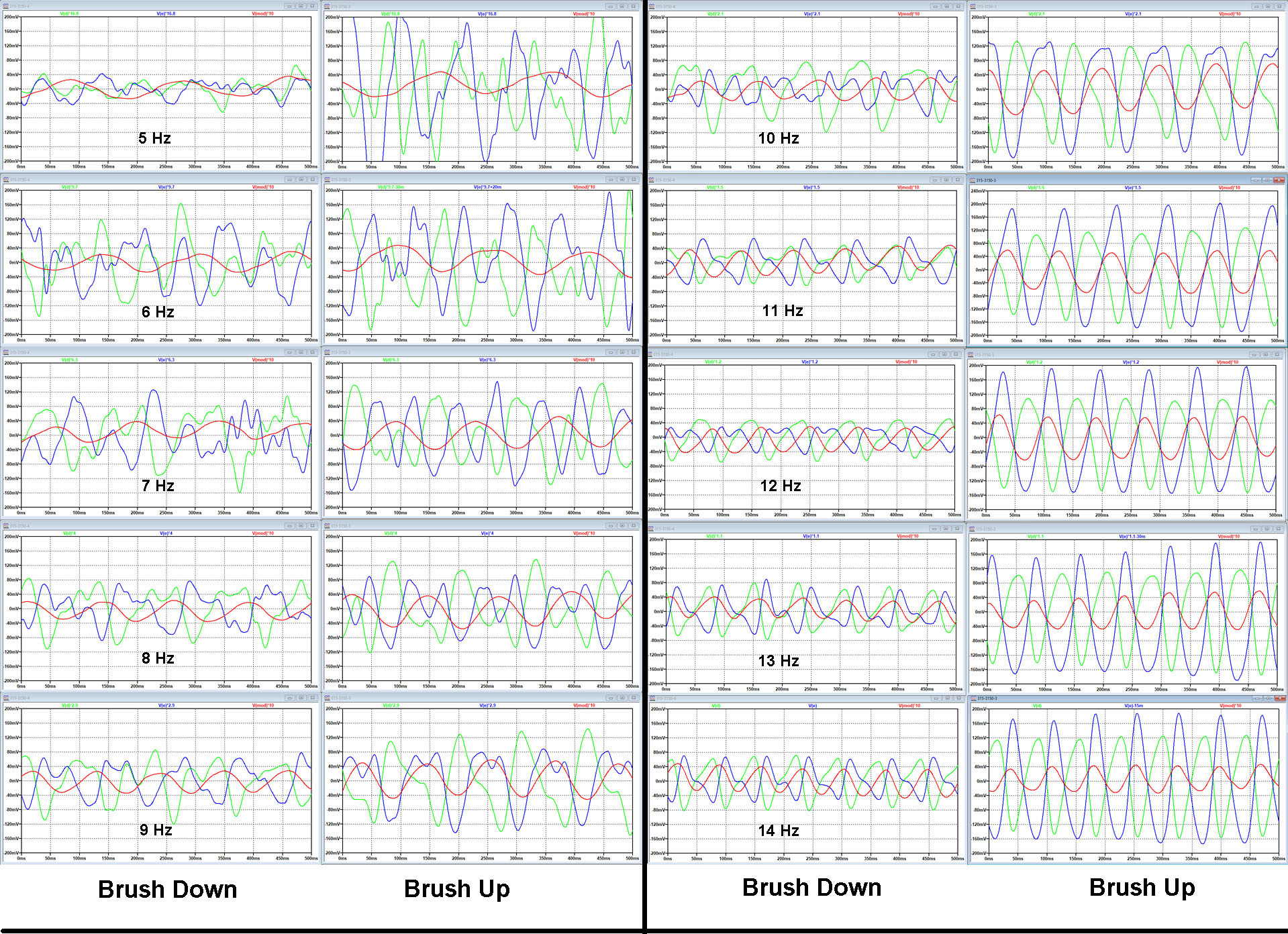

I've been thinking about this result over the past day or so. I think it's odd.
That's my feeling also, so I have already spent quite some time on further analysis.
For one thing, it was easy to reconstruct that a 18dB/oct@15 Hz Rumble filter had been used, so I corrected the files for that.
But even then, things are not that easy to reconstruct.
Waving of the input signal is almost all the time in antiphase between L and R, so the FM modulation is almost exclusively caused by vertical movement, which makes sense.
But the correlation between both is not that obvious when concerning it as a second order system with a certain Q.

In the meantime you can have a look at both images below.
From all 10 frequencies you can see the Waving of the input signal for L / R in Green / Blue and the demodulated FM signal in Red.
Image on the left is uncorrected, on the right waving corrected for the rumble filter.
Hans
p.s. so far the waving is only corrected in amplitude but not yet in phase !

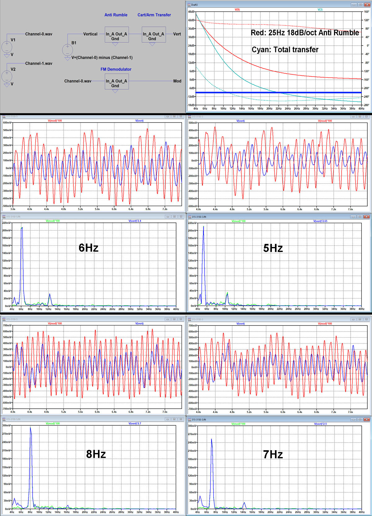

Trying to find the transfer function from relative Cantilever movement to Carrier FM modulation, I assumed scrubbing as being the most important reason and further concentrated on the Brush Up recordings only.
And indeed,waving of the input signal between L and R channel was almost all the time in opposite phase, confirming massive vertical movement.
To extract the vertical movement, both channel signals were subtracted.
Since the demodulated signal that originally FM modulated the carrier, was in the same order of magnitude from 5 to 14 Hz, it meant that the vert. waving had to be at least of similar amplitude over the same freq. range, but it was not.
The only reason could be a rumble filter being used when recording the .wav files.
So an anti-rumble filter was applied and after some experimenting it seemed like an 18dB/oct filter @ 25 Hz was the right choice.
Next step was to find the additional transfer function between the anti-rumble corrected waving signal and the FM demodulated signal.

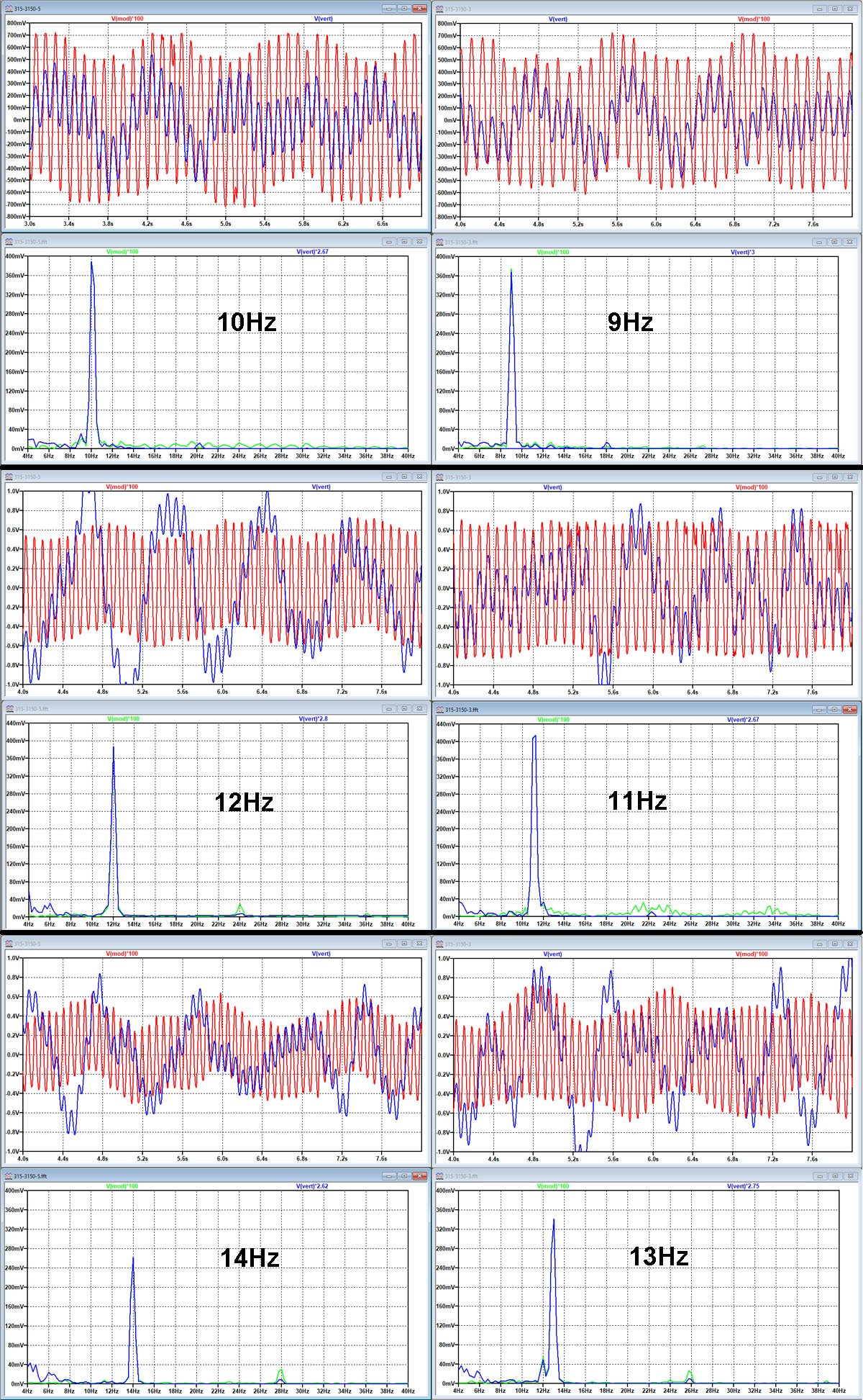

Again a number of attempts showed this transfer function could be realised. See first image below for the Circuit and also the Bode diagram showing the AntiRumble filter alone in red and the complete transfer function in Cyan.
The 2 large images are further showing the spectra of the vertical Waving in blue called “V(Vert)” after having applied the complete transfer function,versus the spectra of the signal “V(Mod)” in red, being the FM demodulated signal from the 2990 Hz carrier.
Spectra are computed from the time signals directly above, taken from 3 LP revolutions or 4seconds at 45 rpm.
The used FM demodulator, could manage up to +/- 0.7 % FM modulation, way above the auditorythreshold of 0.1%.
And because V(mod) exceeded occasionally of this hard limit, there is some extra noise oflow magnitude in the spectra of 10 and 11 Hz.
These noise artefacts are not really important for this analysis. It does in no significant way affect H1 and H2 of the signal V(mod).
V(mod) in all spectra is multiplied by 100 and V(Vert) on average by 2.7 to get their respective H1's at equal amplitude.
The deviation from this factor 2.7 for the frequencies from 5 till 14 Hz is +/- 0.5dB, so the constructed transferfunction fits remarkable well ! But the harmonics from 22 Hz and up are too low, so the total transfer should stop at-10dB instead of the used -20 dB, a difference of a factor 3, bringing the higher harmonics right where V(mod) is now. That’s why the blue line is drawnin the transfer function graph, to show where the attenuation should really stop.
For the lower frequencies from 5 to 10 Hz, their H2 lies exactly on top ofV(mod), so up to 20 Hz the transfer curve is correcting properly.

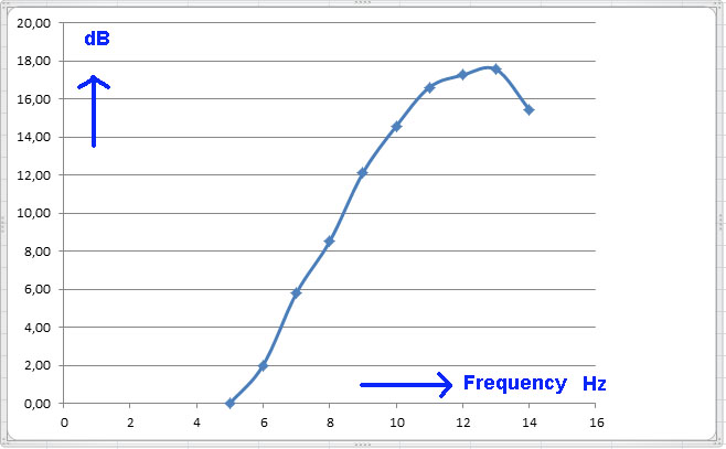

Conclusions:
  • It is possible to construct a transfer function from the vertical waving, correlating completely with the FM demodulated signal.
  • The Anti Rumble filter was guessed to be a Butterworth filter at 25Hz@18dB/oct. Although this can’t be far off, the total transfer was spot on until 20Hz.
    Changing the Anti Rumble transfer will immediately alter the additional transfer function in order to keep total transfer function unaffected.
  • Assuming for a moment that the AntiRumble filter is correctly chosen, it is easy to see in the transfer graph that starting from 6 Hz, the effect of vertical Waving on FM modulation gets gradually lesser up to a factor 3 as from ca. 20 Hz and beyond.
  • This is thus a good reason trying to let Fres at 10 Hz or even higher.
  • The transfer curve calculated here makes it plausible that Fres for this specific system lies somewhere around 13Hz, calculated from the amplitude of Vmod, multiplied by the attenuation between total transfer curve minus the Anti Rumble curve.
    Graphically this results in the third image below, showing the transfer curve of the cartridge from 5 to 14 Hz. Unfortunately there is no info above this frequency, so it is impossible to tell what the Q of Fres of this Cart/Armcombination is.
    And of course this is still assuming that the Anti Rumble curve is correct.

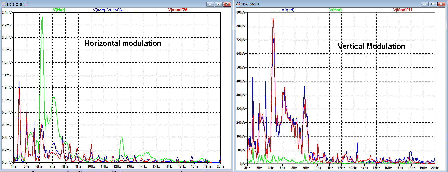

Here are two original wav files for my arm/cartridge resonance frequency tests. Please use your software to analysis them. For lateral resonance, the lowest frequency is 6 Hz on the test lp. My arm/cartridge resonance frequency is around 4-5 Hz, so it does't show. Pilot frequency is 1 kHz.

Jim,
Here are the results for your system.
In the lateral spectrum you see a very large peak in green, slightly above 6Hz, being Fres.
The demodulated FM signal in red, is almost exclusively caused by the vertical waving.
In the vertical spectrum, Fres vert in blue is also at slightly above 6Hz.
The demodulated FM signal in red is again almost exclusively caused by the vertical movement.
Hans

Hans,
So, why is that? FM is only caused by vertical movement even for horizontal module. What does this mean for my arm in reality?
