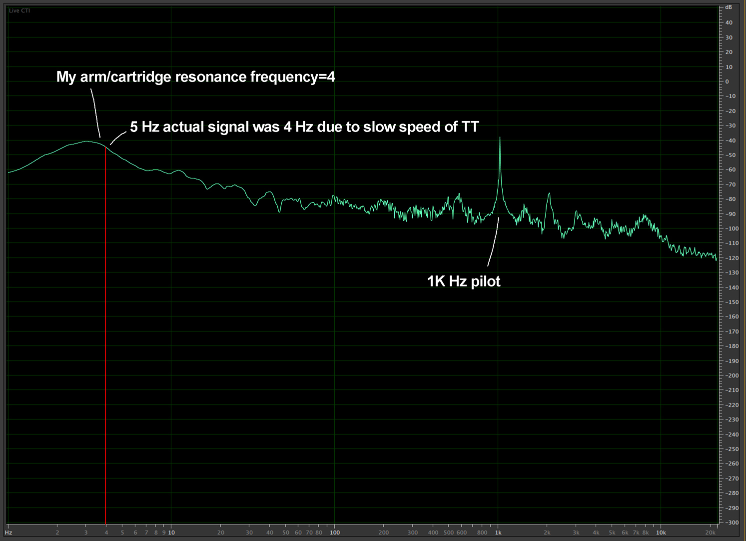

arm/cartridge resonance lateral 17 Hz - 5 Hz band 2 - YouTube
I recently tried to put a 3150 Hz sweep into time/frequency waterfall to see if I can use waterfall to judge stability of TT speed. However, its resolution is far lower than LD’s software. I used Arta measurement software. It is a free try out software.

Hi LD,
Here is a screen capture. The track I used was band 2 from side two of HiFi News Analogue Test LP. It is a Cartridge/arm lateral resonance test sweep 25-5 Hz(L+R)+ 1K Hz pilot tone. You can see from the screen capture that both my arm/cartridge resonance frequency, about 4 Hz and 5 Hz from test track are overlapping each other. It caused mis-tracking. A series of peaks by the 1K Hz are 2nd order harmonic frequency and 3rd order harmonic frequency, etc.
Jim

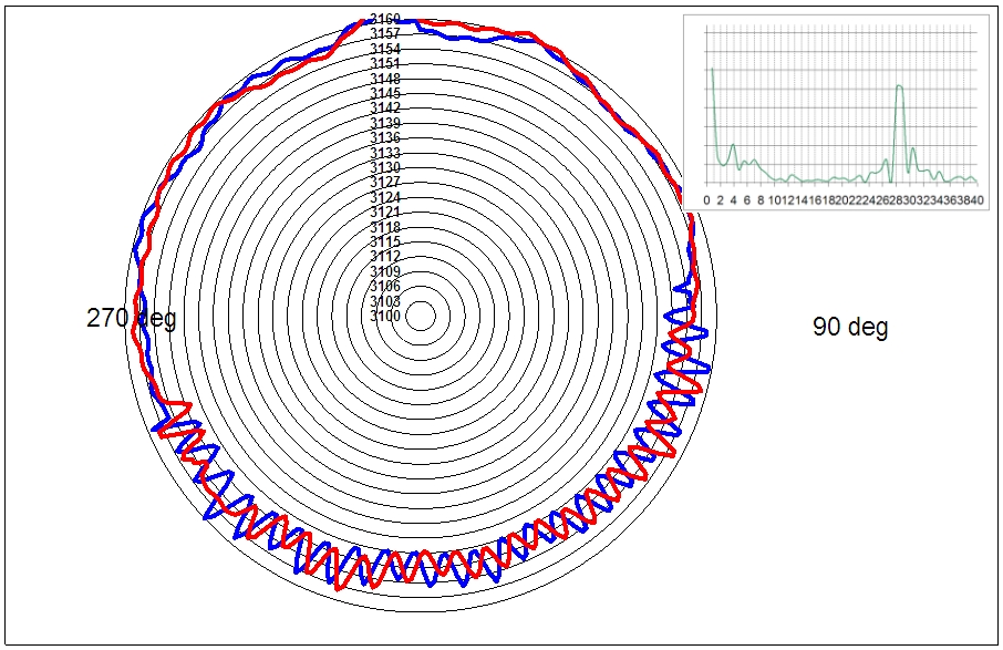

I was wondering if most motors more or less cog why it doesn't show in polar plots ? If any drive system (Belt/Direct Drive/Idler) is turning the platter and since platter has inertia does it affect cogging in a positive way ?

Cogging doesn't show up to any great extent in a healthy TT of good pedigree because it typically isn't there IME. One can generally see it in the FM spectrum inset, but almost always swamped by other effects as we have discussed here.I was wondering if most motors more or less cog why it doesn't show in polar plots ?
Doesn't matter what drive type, one is hard pressed to tell from just trying to find effects of drive cogging in the polar plot: it's barely there (typically) and swamped by other infuences on pitch stability.
All drive types are capable of providing stable platter rotation, IME, and would be splitting hairs to say one general type is better than another - at least for a good healthy example.
Here's an example of drive cogging in a faulty idler wheel TT (Lenco IIRC), it shows up nicely since it only affects part of the platter revolution. It's still possible that this TT was considered 'normal', because the extent of the fault isn't that great, but should still be audible I think.
