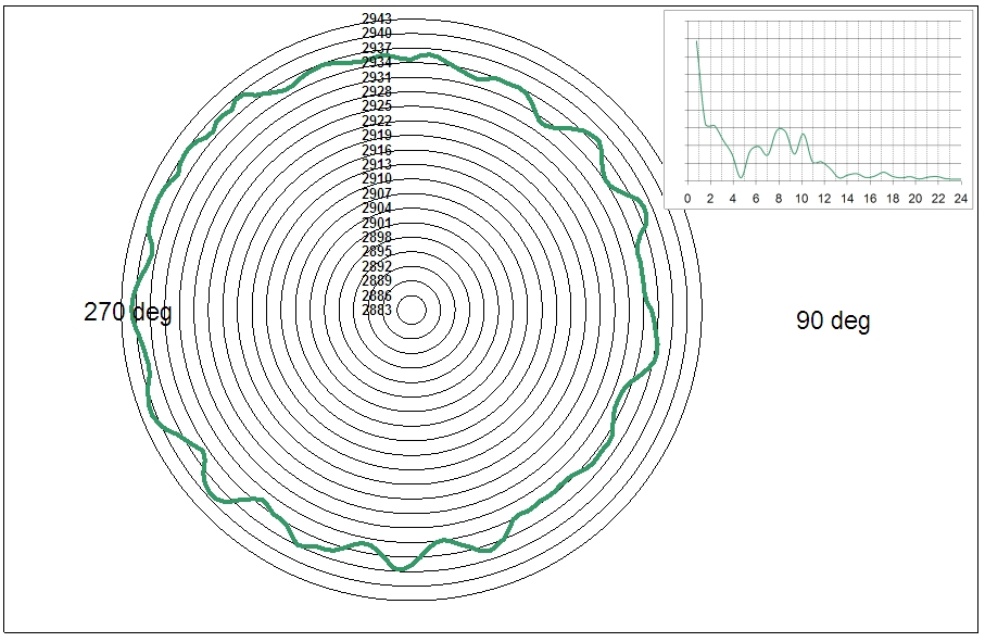

Meantime, here's another good example from the archive. This is from a Micro Seiki SX-777. Red and Blue traces are for 2 consecutive revolutions.

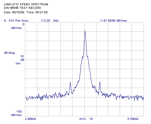

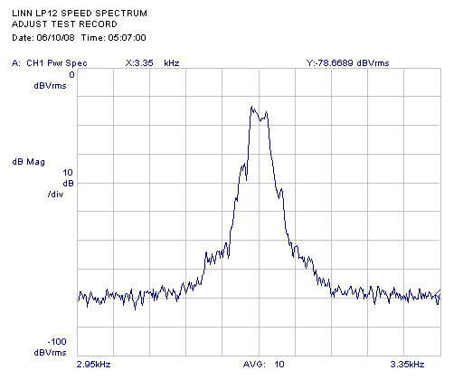

Thanks, Volken - that's interesting.Interesting subject I did a compare between two testrecords Adjust and a DIN W@F testrecord both 3.15khz center freq. span 400 hz on the same turntable Linn LP12 with SME 5 tonearm. Both after carefull centering the record.
I venture the difference might be due to different warp/vertical run out, or to different stylus-groove friction between the test records?
Stylus-groove friction isn't steady, it varies with time in a 1/f flicker noise like profile about an average value IME. This variation causes variation in skate force in an offset arm, and in downforce due to VTA on all arms. This is a stimulus that can cause the headshell to move which is a source of FM or pitch variation. What happens next depends on the cart-arm resonant system, and how much damping there is around.

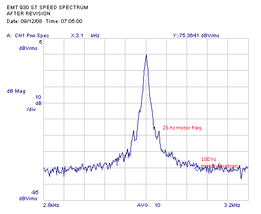

These two speed spectrum measurements shows that the test record is very important , and indeed it shows the tonearm/cart freq. and the 100hz motor vibration .
Pitty enough I have no records from these I use the spectrum measurements for revision work before and after .

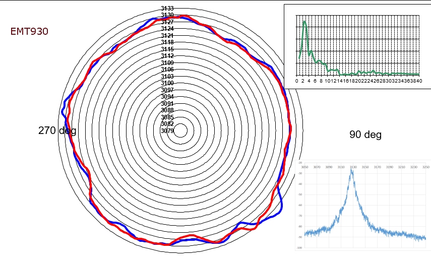

Here a EMT 930
Hi Volken, I have an archived 3rd party 3150Hz test recording from an EMT 930, it's polar plot is attached below.
I think one can see that for this example of a EMT930, there was something big going on at a few Hz, but the 25Hz drive component was there but not prominent. It does show up in the amplitude spectrum, but not so much in the FM.
Also inset in this is the conventional spectrum, which also only hints at a 25Hz component.
I don't know what cartridge was fitted, unfortunately, but the cart-arm resonance isn't prominent either in this case.

That's not even vaguely round, is the 930 idler driven?

Yes the EMT 930 is idler drive. It's very well respected and was part of the EMT studio family that has serious heritage. I also have a test tone recording from an EMT938 in the archive that I can dig out..............That's not even vaguely round, is the 930 idler driven?
I have the hifi news test record, badly centered and poor pitch on the 3150 cut. Acquiring a good din record of an optical disc as per regas dev unit is on the cards.
How round the polar plot appears depends upon the radial scale, and I set it to deliberately see the variations. I always use 3Hz as the spacing, because that is said to be the threshold of most people's ability to hear the difference. I try to keep the plots consistent, so there are 18 radial lines and the peak excursion clips the outside.
What we generally find, IME, is that TTs with excellent sonic reputation don't necessarily have good pitch stability when looked at this way - often far worse than those considered good or mediocre..... which is interesting and surprising at the same time perhaps?
