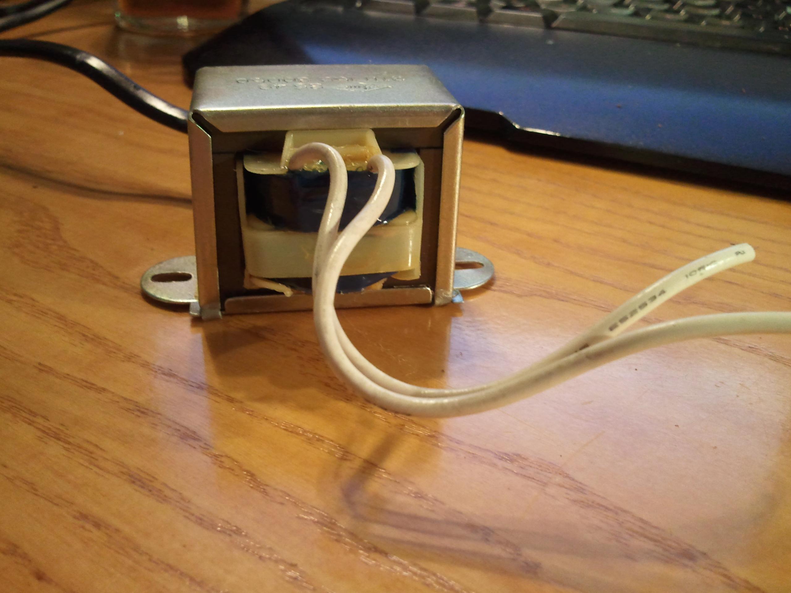

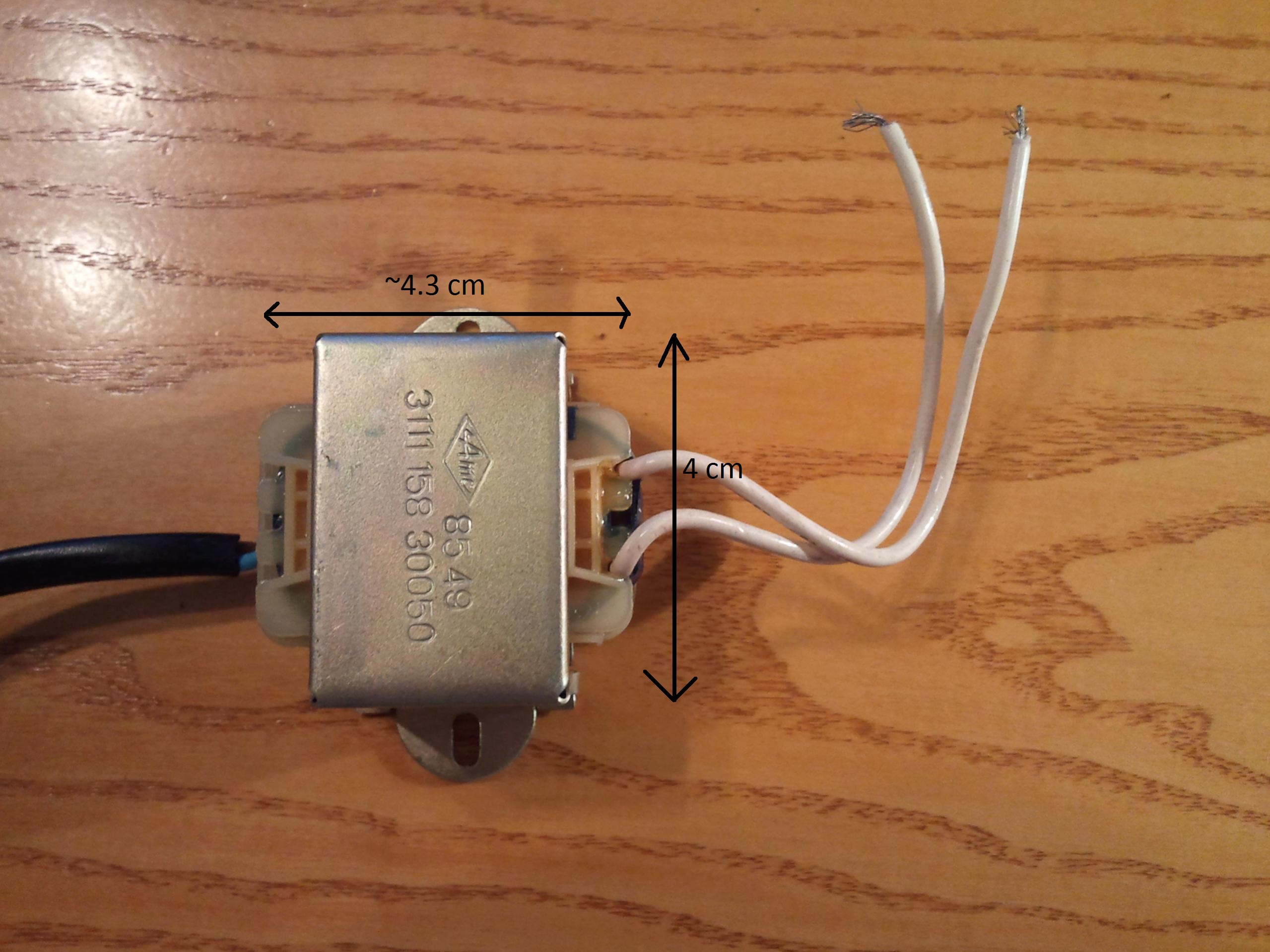

1)The fuse blows only if I turn the on/off button to ON. If I remember right, when I used a new ON/OFF button, when I connected it, while it was still on OFF (I'm not sure if it was off or on), a sound of "blowing" came from the button. After that, everytime I change the fuse, regardless if the button is off or on, it is getting burned.
2) What you mean? :dunno:
3)I connect the AC to the powerline and then I use the two white cables to measure it. But I don't really understand if it is that what you're asking me.
Sorry, but I have to talk in english for years and now it is a bit difficult for me to talk correctly.
Remove the on/off switch completely. Make sure nothing but the power transformer is connected to the power supply board. Check the board around the switch for short circuits, solder bridges and such. Power on again carefully.
If the fuse doesn't blow, the 8V regulator seems to be the faulty part.
Rundmaus
Then remove the 8V reg from the board and put a power switch back in. Connect nothing else but the transformer, as before. Check carefully for shorts and solder bridges in the regulator area. Power on carefully.
If the fuse doesn't blow, get a new reg.
Rundmaus
EDIT: Make sure that the pinout of your replacement switch is the same as the original switch! A different pinout might mean that switching it on shorts the rail against ground.
Afterwards, use your meter in the 20VDC range and measure across the large cap on the PSU board. You should see approx. 15V there.
IMPORTANT: When measuring the powered unit, do not touch anything. Best to use clip-leads and connect the meter securely before powering on. Then connect mains/power on, read meter, power off. Disconnect meter only *after* disconnecting mains.

Seems so. Transformer is still capable of blowing the fuse, seems ok. Fuse only blows with power switch on. Doesn't blow with switch removed.
Either a wiring error in the replacement switch or a faulty 8V reg.
