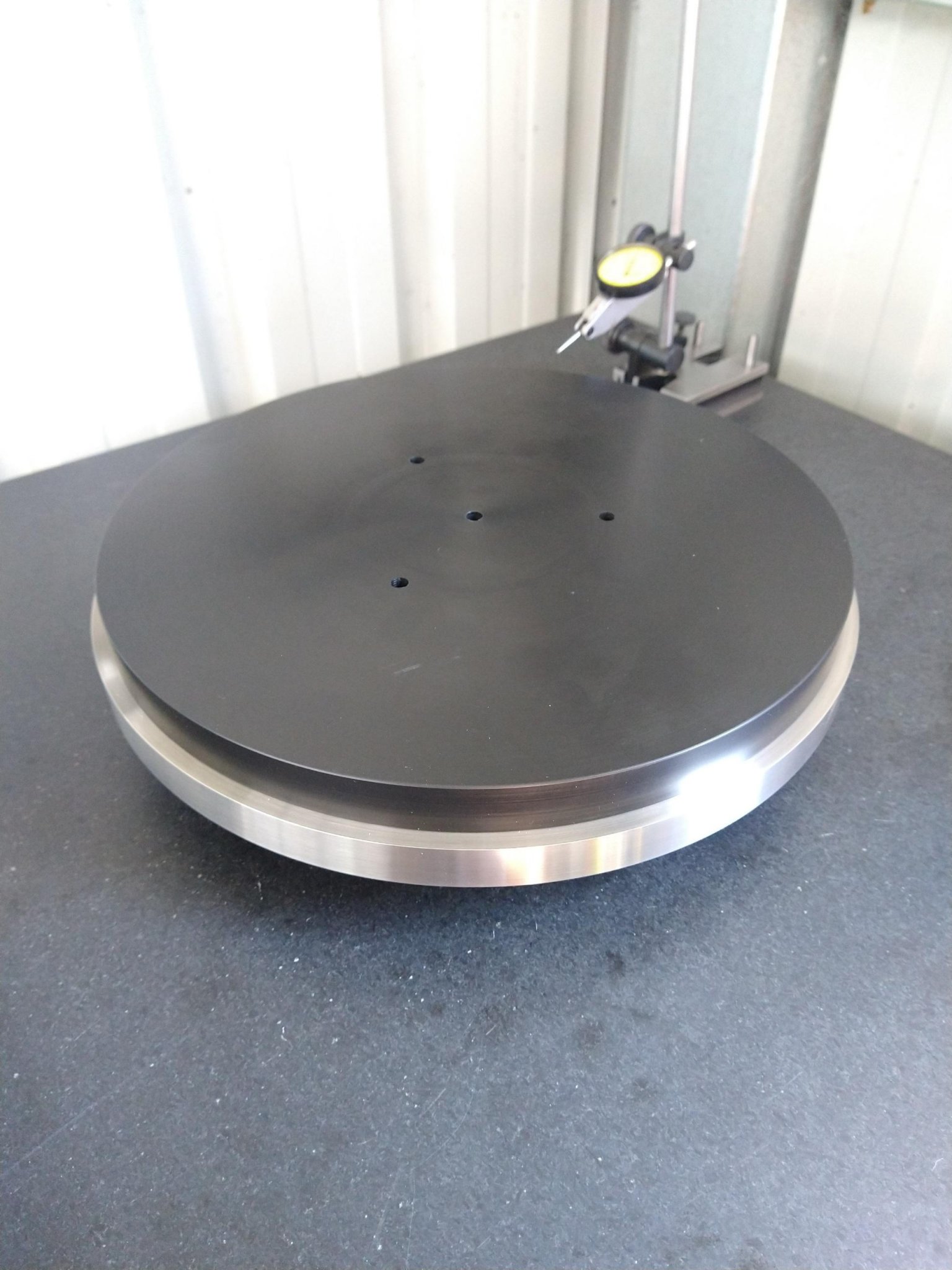

What I did is NOT a mat. I bolted 20mm POMC to the top of a stock platter. I have found if the POM is not fixed to the platter it eventually warps because I made them from 20mm sheet. Round 300mm OD POM $1000AUD a meter, where as 300x300x20mm sheet is about $200AUDIt is all very cool and interesting, but where we -- average mortals can get those mats 🙂 Thanks for sharing though!

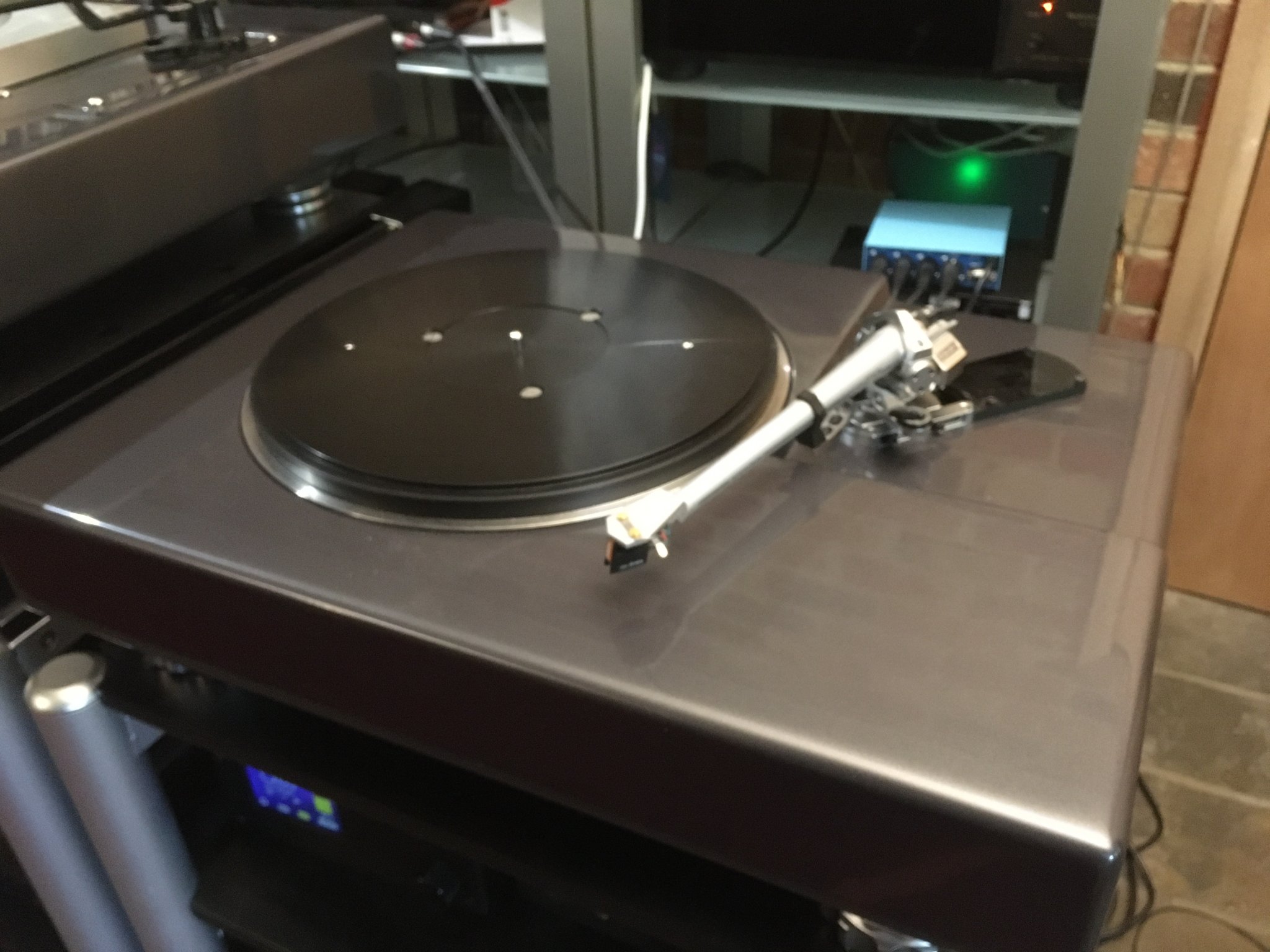

@ warrjon, how did you accommodate the extra 20mm of required arm height and how might that change in arm mounting affect the measurements?

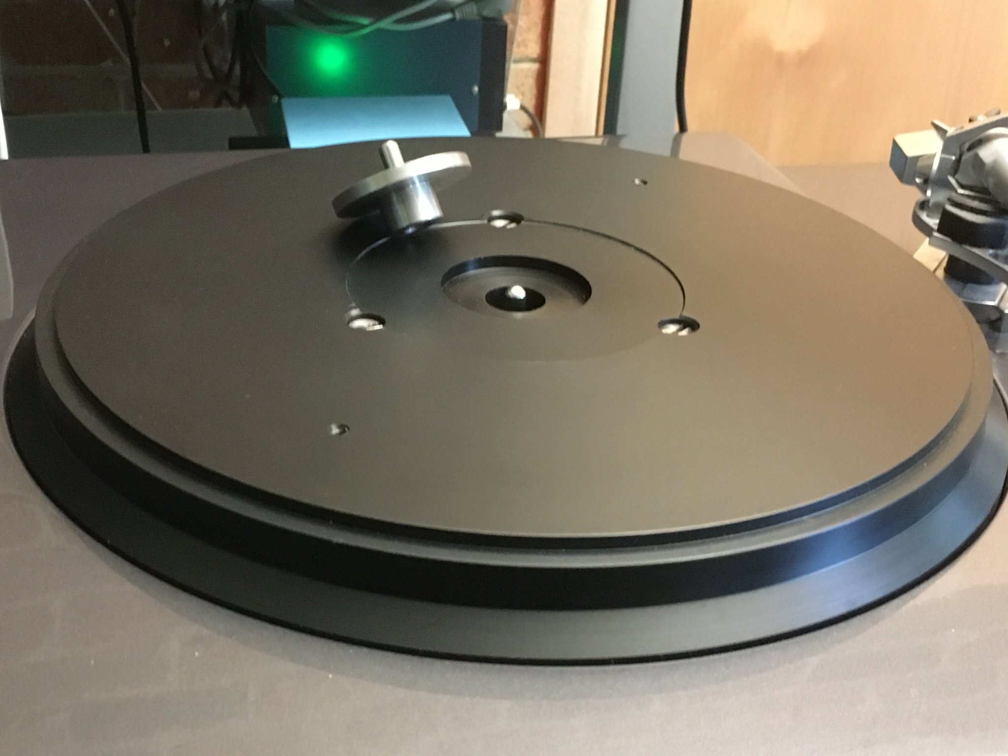

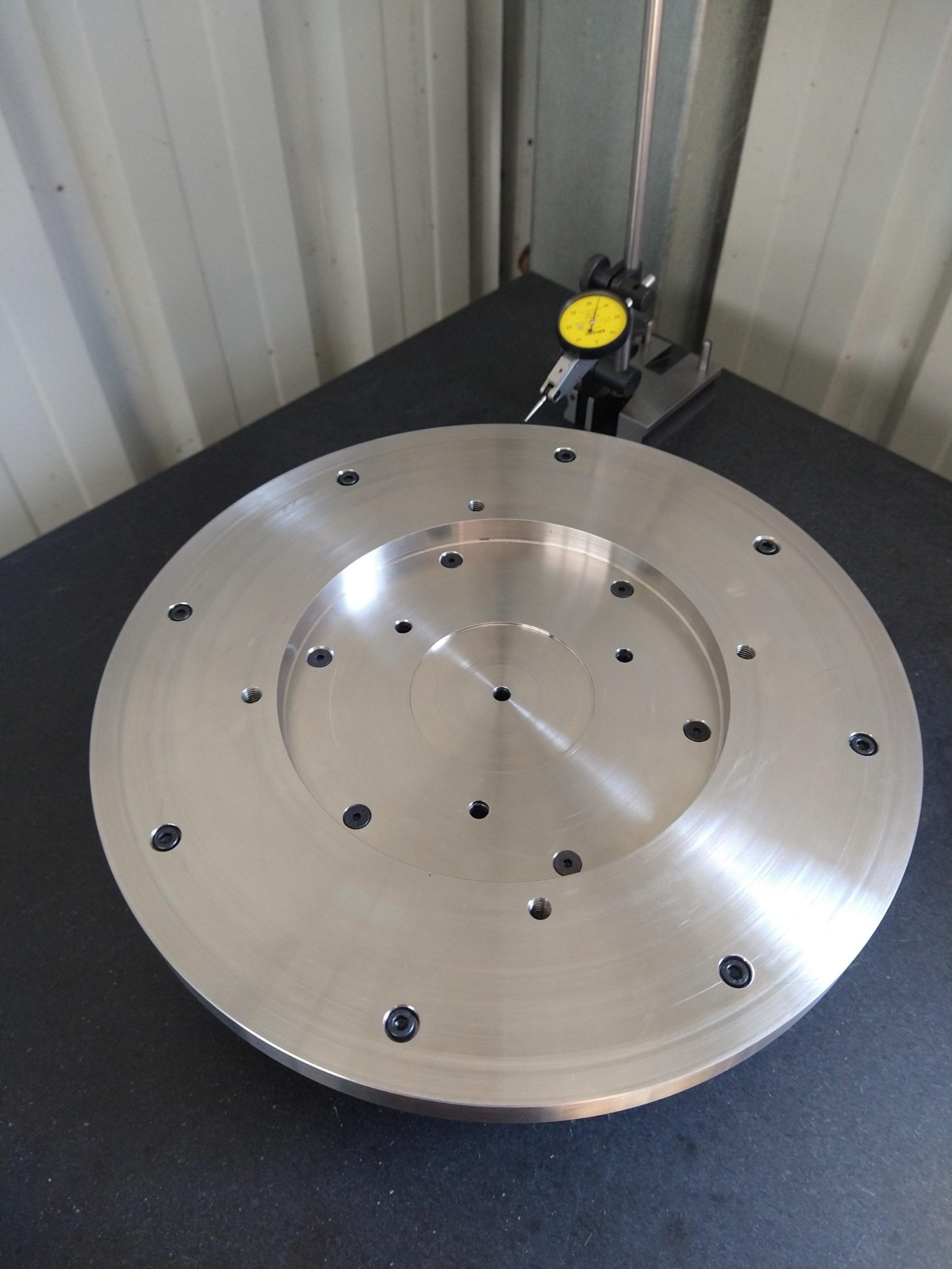

20mm height adjustment is well within the range of most tonearms. This is how the platter warrjon built for me looks.@ warrjon, how did you accommodate the extra 20mm of required arm height and how might that change in arm mounting affect the measurements?
It has since been superseded by a 40mm POM/Gunmetal version that is superior but requires more intricate machining. Fitting a plain POM disc on top of a stock aluminium platter is much easier to achieve and very effective.

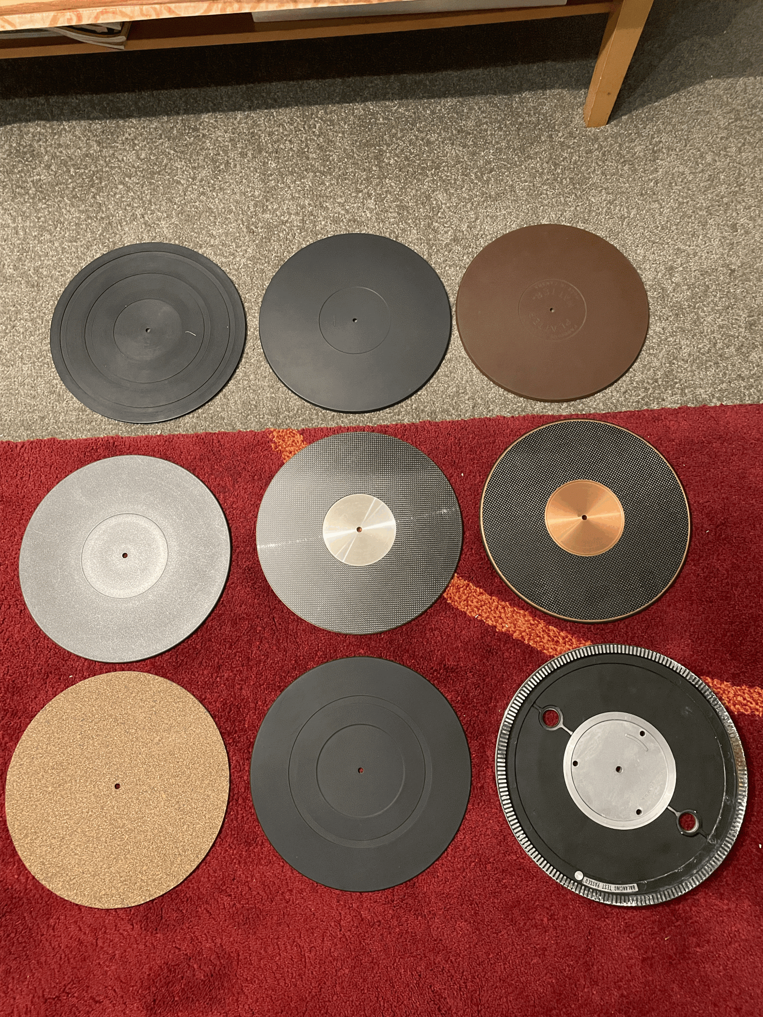

I believe I qualify as a turntable mat obsessive. The small selection shown are:
Technics SP10 mk2 OEM, 6mm rubber
Thorens 125 mk2, 6mm rubber
Platter Matter, 6mm Sorbothane
Boston Audio, 5mm Carbon Graphite
TTWeights Ultimat, 6mm SS/Carbon Fibre
TTWeights Ultimat, 6mm Copper/Carbon Fibre
DIY cork/rubber
Technics OEM 3mm rubber (similar to SL1200)
Technics SP10 mk2 rubber platter damping pads
I have used an SP10 mk2 in modified guise, almost daily for over 2 decades. Quite early on, I found that it sounded different depending on what the LP was sitting on. I never liked the grooved OEM mat. The large channels are purely there to facilitate removal/placement of 10" and 7" discs. Also, in many of the samples I have encountered. the rubber OEM mat and under platter damping has stiffened greatly and even cracked. The Thorens 125 mk2 mat was an improvement and fit the platter recess almost perfectly after a small outer lip was trimmed. I realise the OP is concerned with the SL1200 but my experience is that underneath platter damping does not effectively eliminate platter ringing, which is primarily due to material selection and manufacturing compromises.
