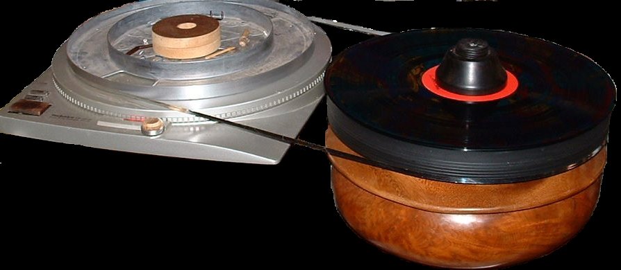

I'm starting to be interested. I've just got a cartridge for my TT and I can hear the motor from my Technics in the cart.
My motor has feedback speed controlled at 33 RPM with high torque and low rumble of Technics SP series turntable. It can pull my VPI TNT Jr. platter from dead stop. I don't have to put alot of tension on the bell with 12 inch pulley. This put much smaller side load on the turntable spindle.
