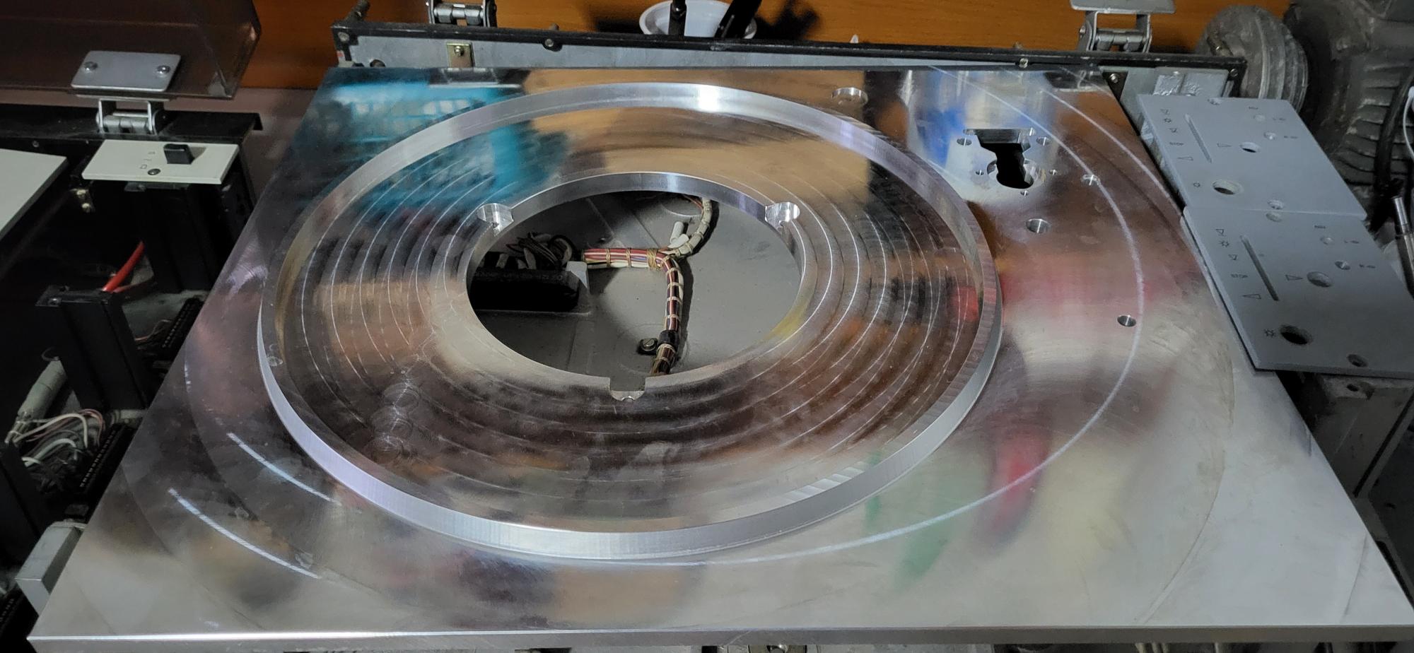

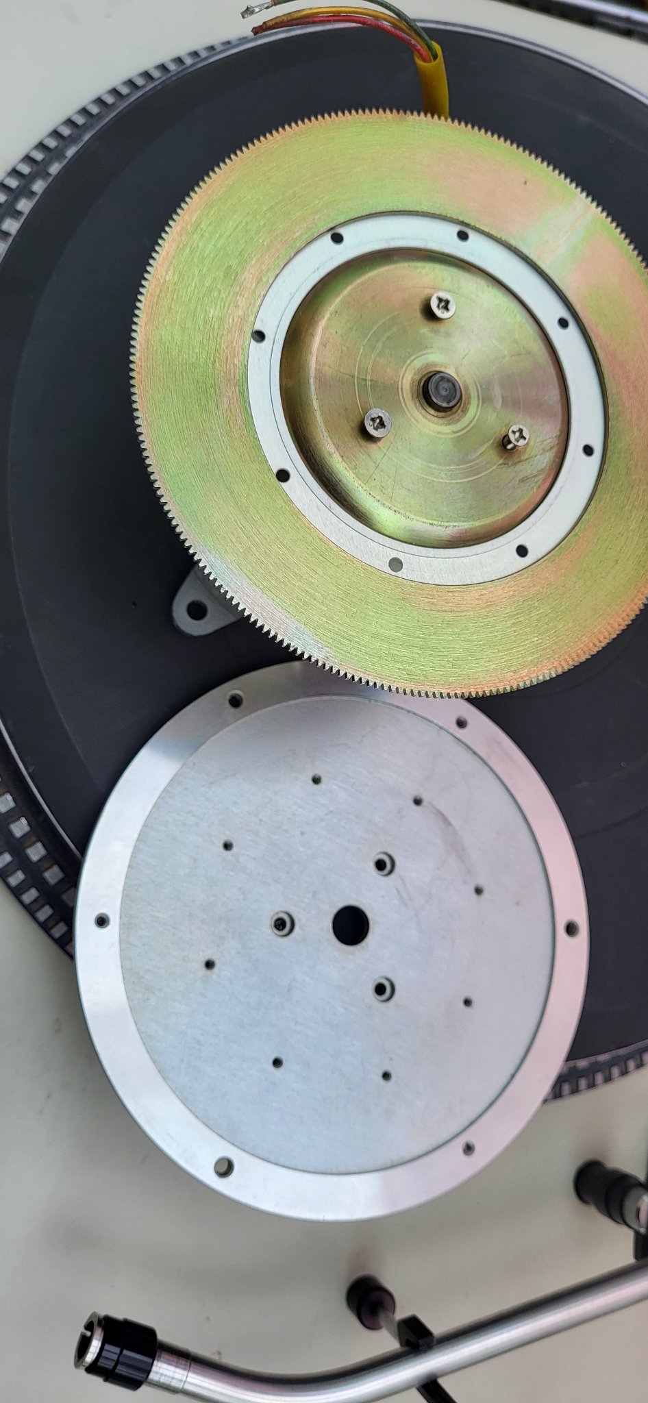

Might be of interest:
Everything can be made at home if you have a small workshop.
Just 3 professional studio turntables.
Asynchronous motor direct drive. Own arm construction.
Works up to a 5kg plate! Plinth is self-made and everything.
If you are interested I send pictures of many solutions as ideas

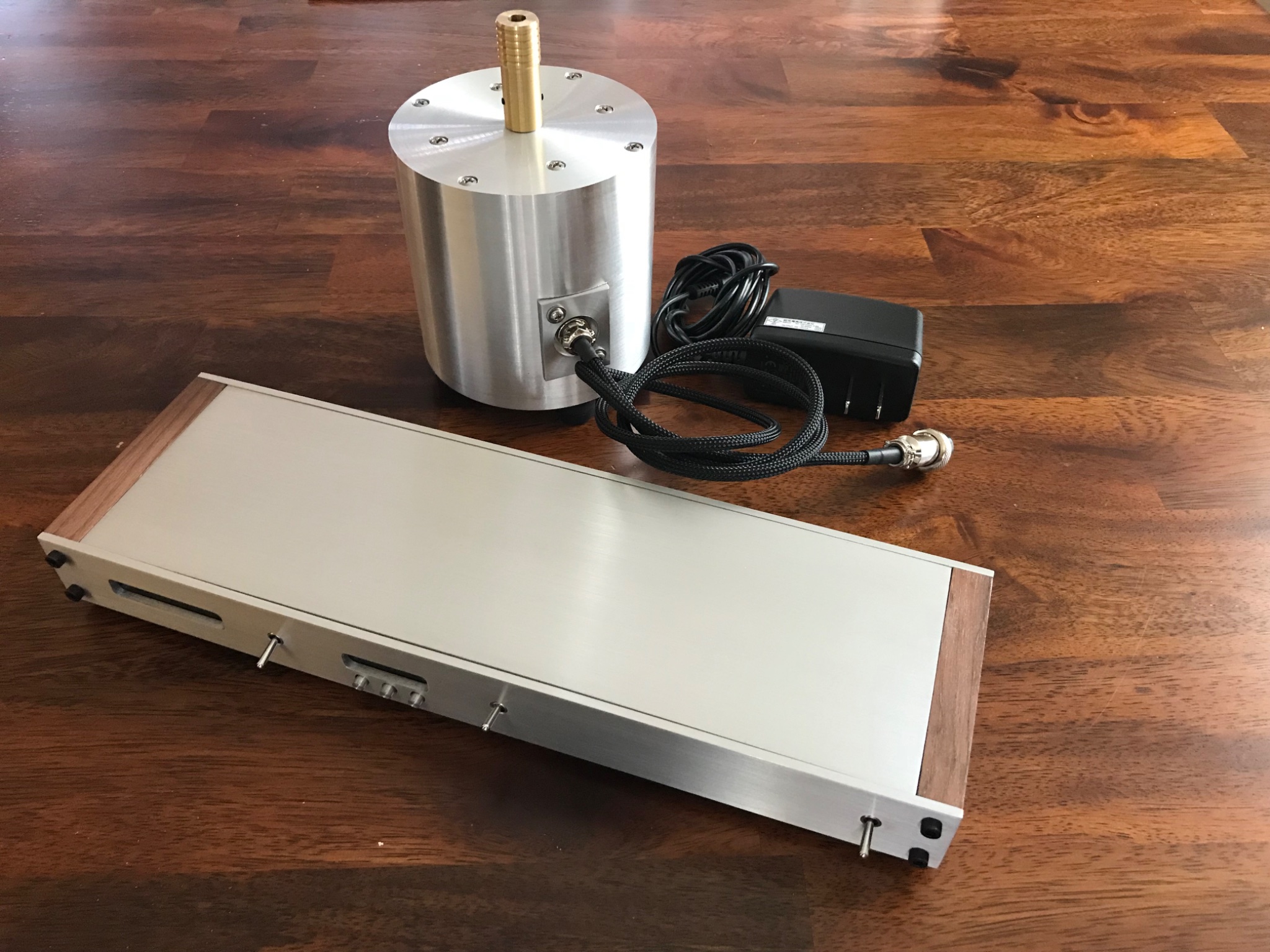

I tried getting the Total Eclipse a few years back. I placed the order, pre-paid and waited for months on end…it never came. I called and they still didn’t have an ETA on it so I canceled the order. I hope they’ve straightened out their supply issues or whatever the problem was.
I ended up building the SG4 project with the Anaheim 3 phase motor. No feedback speed correction, but even with belt creep during warmup (about 30 min) the speed shift is usually less than a few 1/1000th on my Roadrunner.
I’ll be using that in a secondary system soon.
I eventually found a NOS 20 Amp Eagle/Roadrunner package for sale and bought that for controlling any other tables I had plans to build.
I still have a Pheonix Falcon controller sitting on the shelves because I didn’t have a motor that required less than 5 Amp I was interested in using.
I’ve got a few VPI Hurst motors and a box of various Dual motors from 1019s and the like (not sure of current ratings).
If you were interested in it and want feedback speed control you would need to get a Roadrunner for that feature.

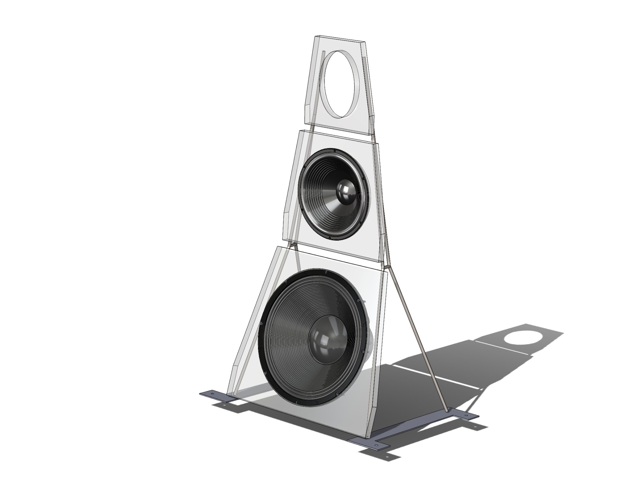

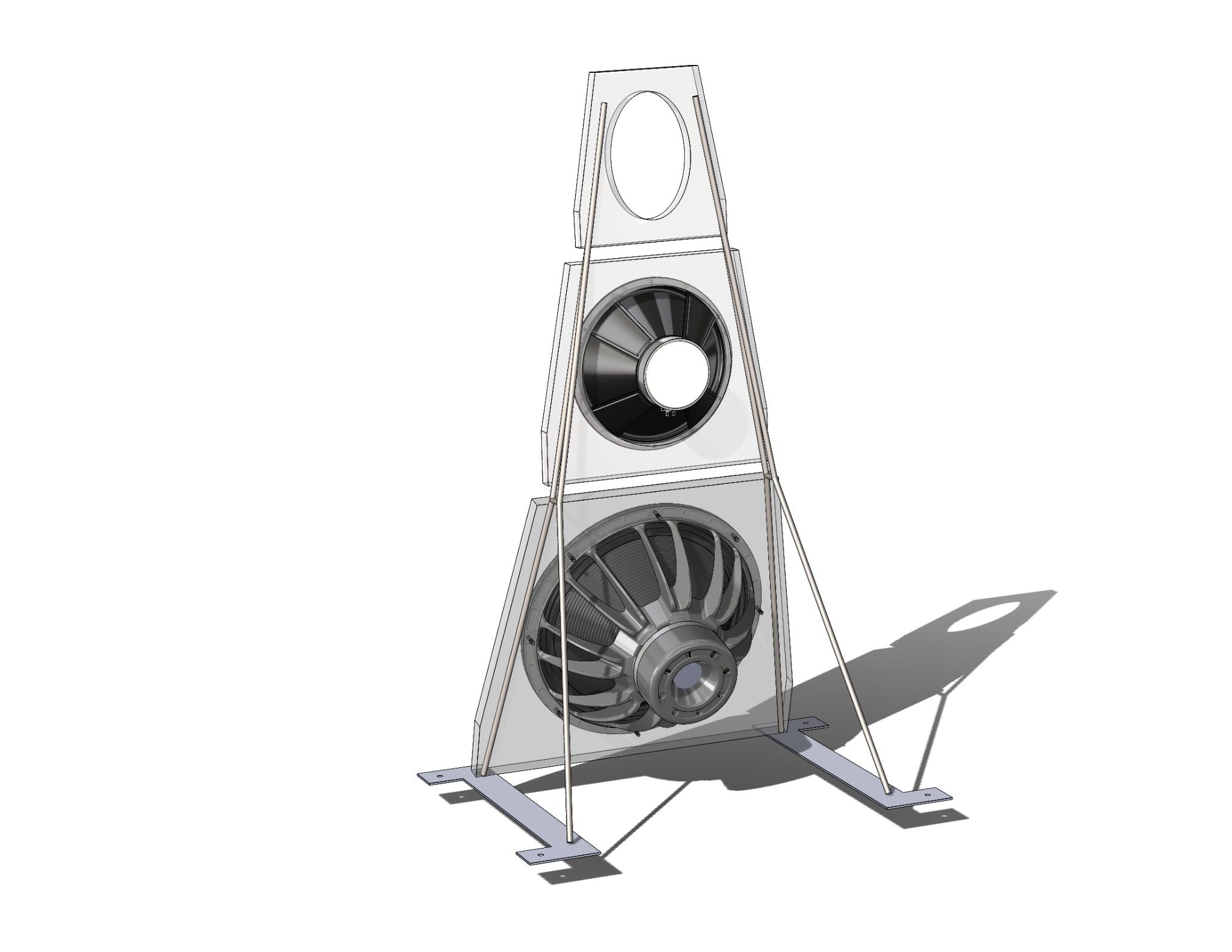

I got the 096 and I would say they are exactly what I was after, at a good price.
I'm working on a new frame with the same goals, something that looks and works good long term but also has flexibility to try different types of baffles... although I'll be limited from going much bigger on drivers due to the frame position it is made for an 18", 12" and the 6" sonido, so still tonnes of drivers I could try that size or smaller.
It's going to have a removable frame extension at the top, to use a tweeter or no tweeter or up or rear firing tweeter depending on future experiments. I figured why commit if I'm not sure yet...
