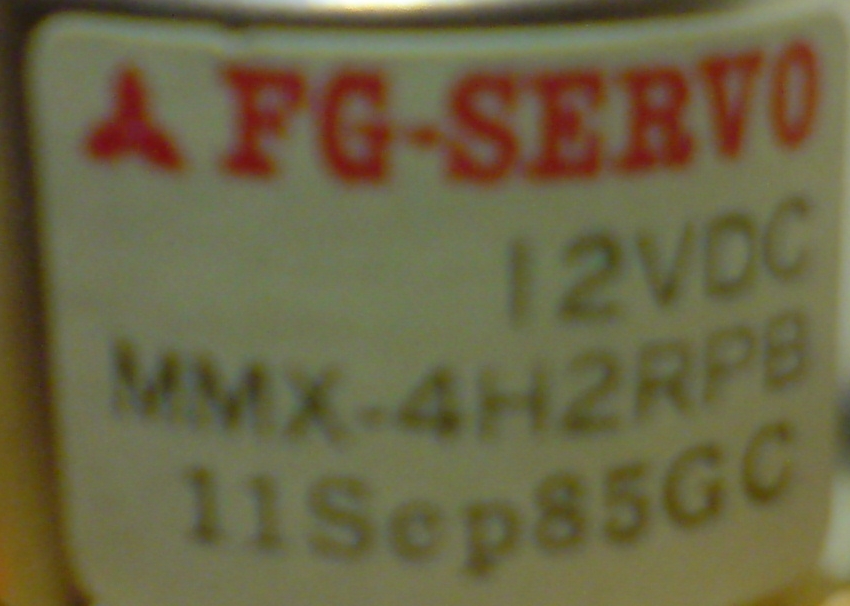

The logo comes either from the brand Matsushita or Mitsubishi (see attachement) - both companies do no longer offer such brushed dc motors.
Ask by follow brands for a cross reference list and currently produced replacement type for your above showed model:
List2 : Motor Models for Typical Applications | MABUCHI MOTOR
MITSUMI - PRODUCTS - PRODUCTS INDEX
If you haven't success, ask additional by B&O for a data sheet copy from the origin brand and send it to Mabuchi or Mitsumi - then there one employer find out a suited replacement for you and you can order it by digchip or Farnell.
The most critical values are the mechanical size (outer diameter and screw hole management) and the RPM value so as the direction (CW or CCW).
