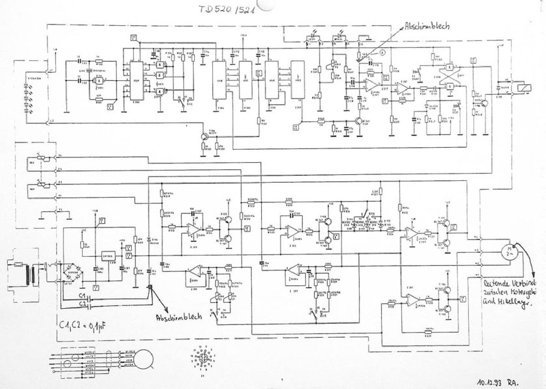

You may be interested in the attached schematic for another Thorens turntable, the TD520. This was a kind of hi-end version of the 300 series and could take 12 inch tonearms. I have one running my own design linear-tracking air-bearing arm.
The design appears to be pretty much the same except there are a couple of extra op amps for the speed adjusters (as buffers I believe).
All the stuff at the top appears to be for the synthesised strobe light (wall wart connection so no mains I guess).
I can't find any source on the web that has a shot of the schematic that is actually legible, unfortunately!
Once again, many thanks for your explanation. Much appreciated!
