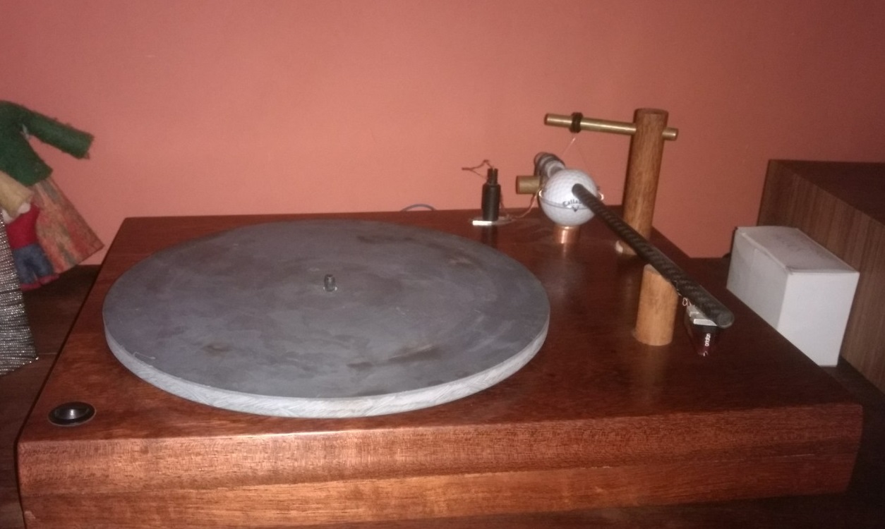

Hi, I have recently fitted a new DC motor, speed controller, and PSU (cheap wall wart job I had lying around) to my DIY effort turntable and I have ended up with a very annoying very high pitch noise coming through the speakers as soon as I switch it on. The sort of high pitch that not everyone can hear, my wife can't. It doesn't change with motor speed, and it doesn't go away when a record is playing. I can filter it out using the high filter switch on my amp (1970s vintage with a low and high filter presumably for turntable issues!) But then I loose some of the top notes on the records and they sound a bit depressed.
Anyone experienced this? Or can point me in the direction of a solution? Or at least the location of the problem?

I include some photos of various parts of the turntable:
1. general view

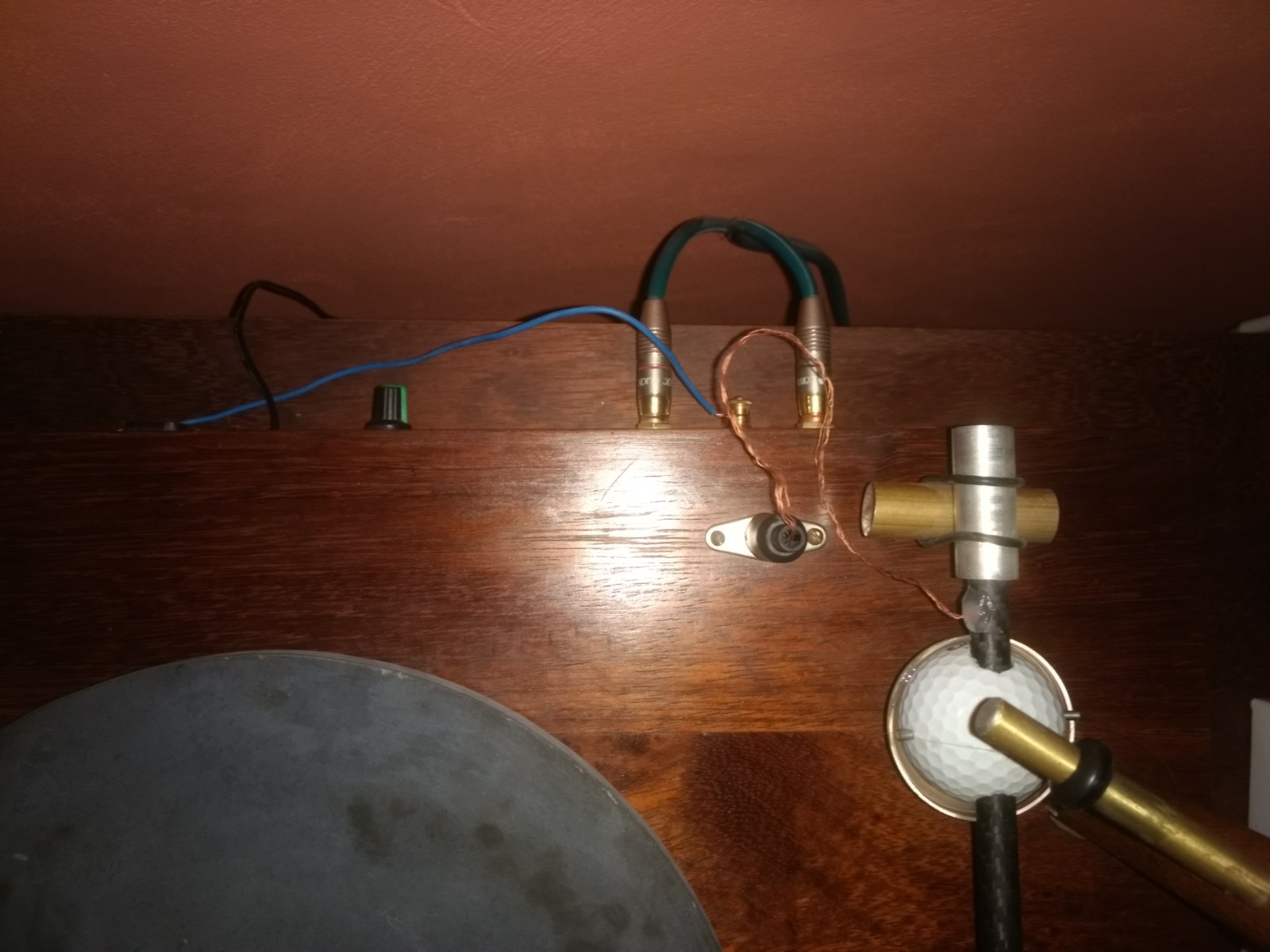

2. audio connection side

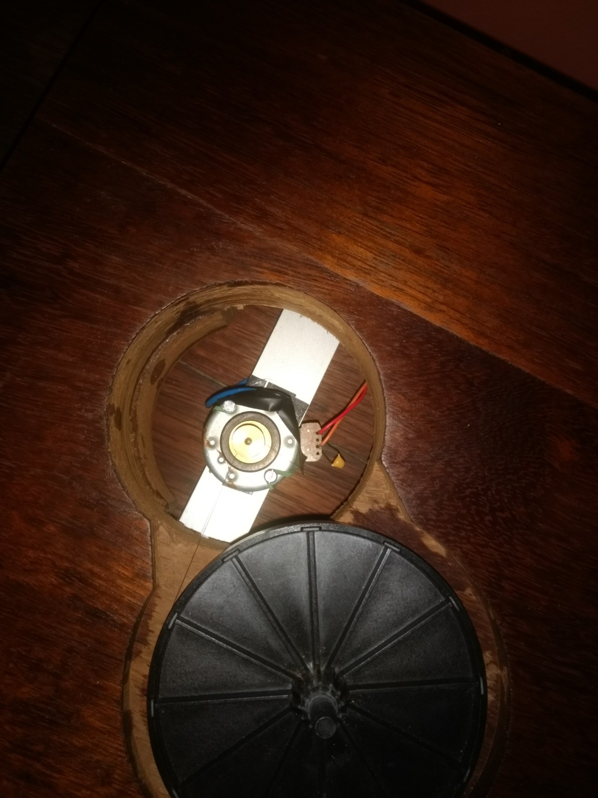

3. motor from above, blue wire taped to the motor is earthing the motor case to the ground terminal on the back - I was experimenting with earthing an this arrangement removed all back ground noise except the high pitch squeal.

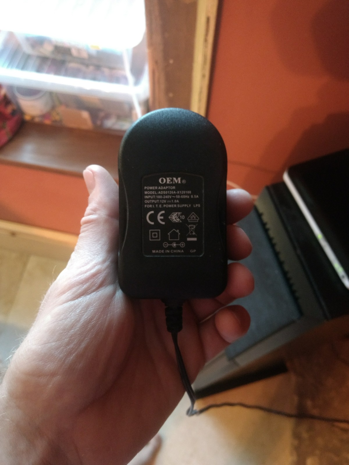

4. the PSU
5. the motor, speed controller and power cables from below. I have soldered 1 uf capacitors between each motor terminal and its case to try and remove the high pitch noise. It doesn't work!
Also, if I hold the motor still, the noise is still present.
So I think it points towards either the speed controller or the PSU - I don't think its motor noise.
Is there a cheap way of proving the PSU is the problem - i don't really want to buy a linear PSU only to find it wasn't that.

As Your arm isn't all metal, I would wrap some braid on the cables for shielding and would connect them to system ground.
I also see a lot of cable hanging before the arm.
You could also try some ferrite stuff (old VGA cables / computer PSU) around the motor wires or even shield the motor like the laminate stuff wrapped around tape decks motors.

Assuming that you don't want to try building a specific DC supply controller for your motor, you could try just getting the maximum separation you can between the signal cables and motor electronics.
I've had some experience with this on my Heybrook TT2 where I'd been tolerating a buzz, hum , rice krispie noise that was only present when the motor was running, and only audible close to the speakers. But it really began to get on my nerves.
With the arrangement of phono pre, preamp, and power amp I had to have the phono cables running within a few inches of the motor supply board and mains lead. It was a complete pain (I had to reposition the TT supports), but I rearranged everything so I could have the phono leads head in the opposite direction to the motor and completely away from any mains/motor cabling.
The result was complete silence.

A brushed DC motor may still have a controller with PWM output. If this is the case, and it is the source of your noise, I don't know if a cap across the output will be sufficient; it may require an LC filter. It may be easier/better to just replace the controller with a regulated DC output type rather than PWM with a switching frequency in the audio range.
Ben
Its very likely to be the speed controller. You need one with ultrasonic PWM, and that's not universal by any means.
