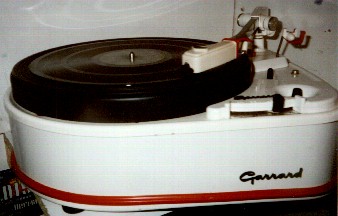

A reggae sound system operator Jah Shaka (the king of soundsystems) has used a Garrard deck for about 40 years to play out on his many many KW system..apparently the garrard turntable has a great bass response and was the favoured deck of many a soundsystem in the day.
I plan to use a turntable for playing records, not backspinning, scatching, beatmatching etc, so i dont have any need for a 1200, just a player that can handle the vibrations given off by 18" scoops!

Garrard 401 used to be a popular DJ turntable, and is more likely to be able to withstand the abuse than a suspended subchassis turntable.

The reason may be that production stopped before you were born! However, an awful lot were made, and they are still very popular Hi-Fi turntables, particularly amongst DIY types (I have a 301 and a 401). Rumour has it that there are now more 301 and 401 in Japan than in the UK.
