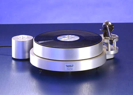

Hi ijp,
I think the Clearaudio Innovation design is a great model for your DIY project. I have a thread drive turntable that offers a couple of variations on the Clearaudio layout that you may want to consider. These differences would make it a little easier on you from a fabrication perspective and offer some sonic advantages as well for a DIY design. The Acoustic Signature Final Tool that I have puts the motor in an enclosure separate from the platter and bearing --- easier to isolate the motor noise and vibration that way. It would make your woodworking easier too (if you're planning to use lots of wood in your build), in that you could just build a simple round enclosure for the motor if you wanted, and a simple round base for the bearing and platter.
The tonearm mount is an outrigger arrangement that bolts on to the bottom of the platter base. Again, simpler to fabricate than a completely integrated base that holds motor, platter, tonearm mount.
Your key components are the motor and bearing.
I'm sure there are other threads in this forum that cover possible options and recommendations for those components.
I would let your woodworking creativity drive a lot of your choices around how you want the enclosures to look. I would go for the simple round design, but you might want to do something a little more creative based on your skills. If I did a wood base, I'd strongly consider ebony. I like the look, it machines well on my lathe (metalworking), and my sense is that it's denser than most wood, making it a better analog to the heavy metal foundations that most people like to use for their turntables.

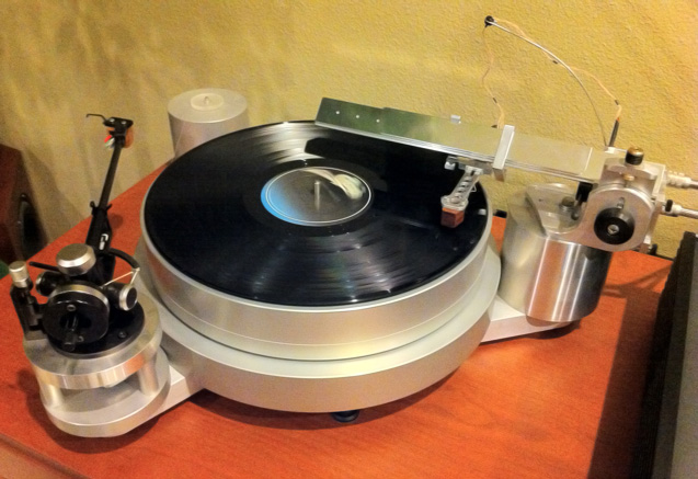

Acoustic Signature Final tool
ijp
The turntable in my original message is manufactured by Acoustic Signature, a German outfit. I bought one and have modified it a bit. I fabricated a round tonearm mount for the Graham tonearm in the attached photo, then more recently, I built a new outrigger arm and tonearm mount (the big round cylinder) on which the Trans-Fi Terminator linear air bearing tonearm sits (great model for a DIY tonearm project too!)
Since it's a manufactured table, I don't have drawings, but the platter is 12-3/16" in diameter. It's just a hair under 2" tall.
In terms of getting the motor and spindle bearing lined up, and getting tonearm-to-platter geometry set, the answer is to build adjustability into the design:
The 3 spiked feet underneath the platter base on the Final Tool are adjustable. This allows you to level the table, but would also allow you to precisely set the relation between motor height and platter spindle bearing if you wanted. The outrigger arm on which my tonearm is mounted to the platter base with bolts has slots instead of just holes. With the slot, you can adjust the effective length of the outrigger to set your tonearm pivot wherever it needs to be for the tonearm you want to use.
