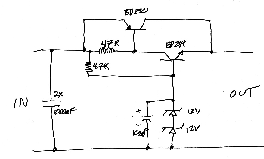

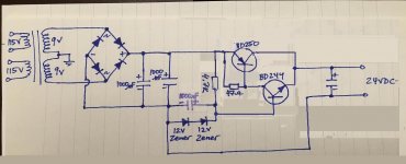

Need help to double check this schematic so no boo boos happen. It's rather complex and somewhat strange. It will be powering a turntable's motor. Thanks guys.
The unmarked capacitor is 4.7uF electrolytic.

You'll struggle to get a clean and regulated 24 volt rail from an input of around 25 volts DC (18vac * 1.414) using a linear regulator.

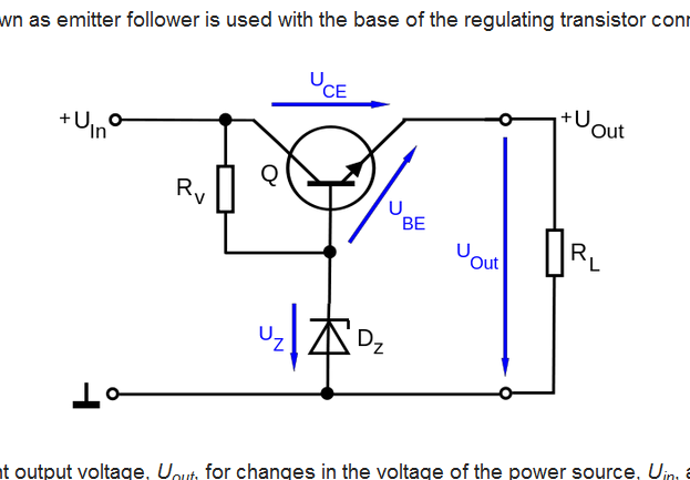

This looks more like an active ripple filter with zener limiter that stops the output going above 24 volts or should the input happen to be a bit higher.
Except the input voltage isn't high enough to get it to regulate well......
Just calculate the zener current and available base current to the NPN device. Ultimately though, I suspect non of this matters for its intended application as a motor PSU.
