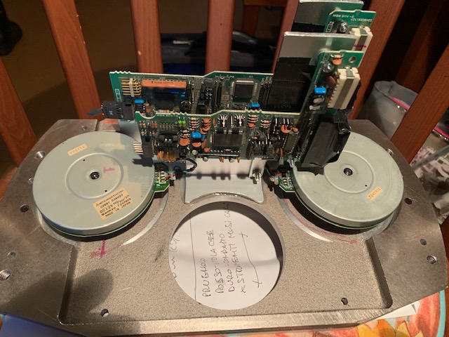

each motor have its own brushless controller, I have checked their individual speed and they are pretty synchro.
It is an area worth investigating. Even small differences in the speed may render the idea of the two motors useless.

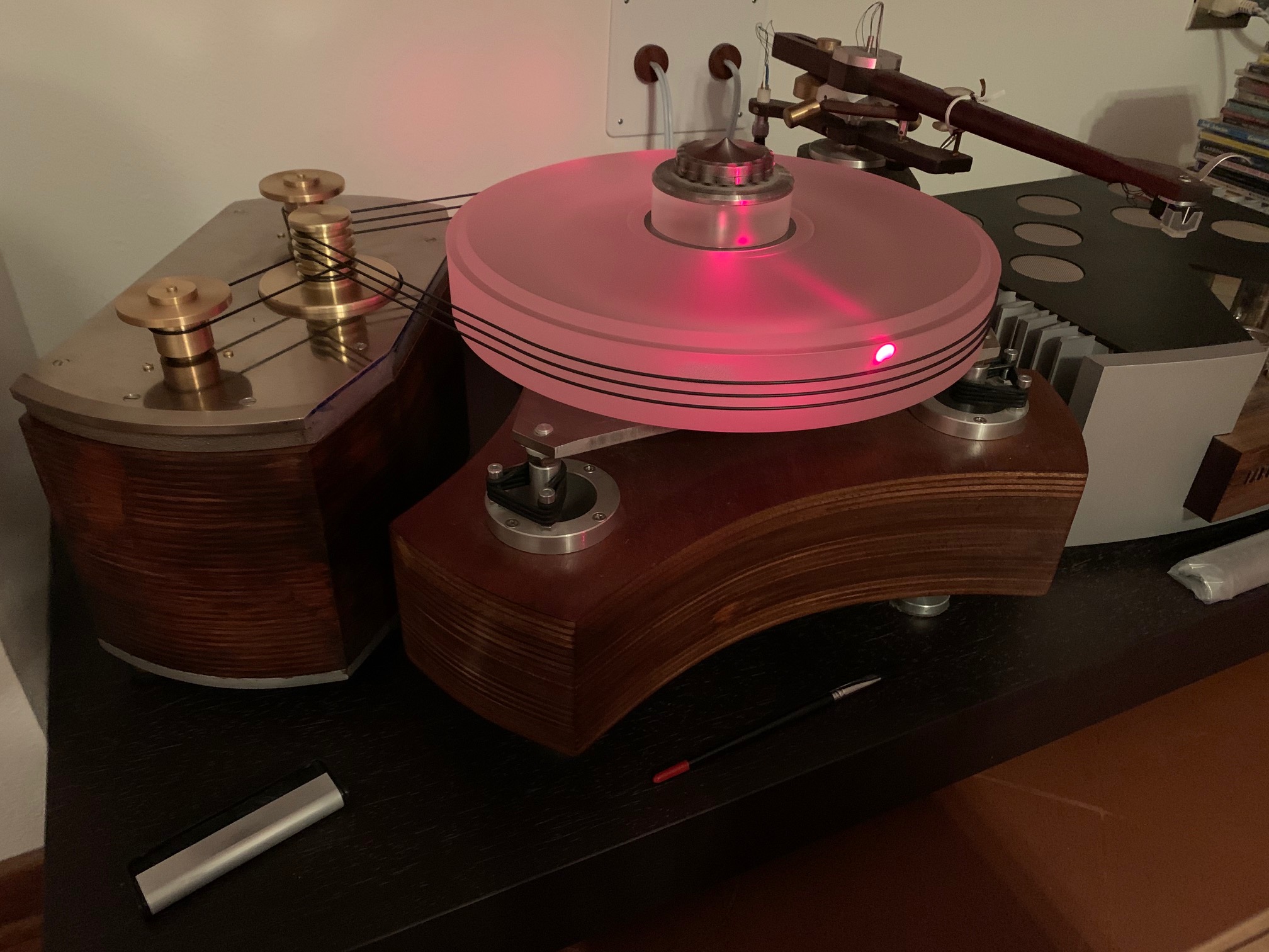

When start the TT the platter speed is 32.9 RPM
After 45 minutes get 33.3 RPM
After about an hour gets 33.33 Rpm. I like the sound of my TT, generally speaking at 33.33RPM or a bit higher.....
I like the RPM Steady. Just to give you some sound info:
At 32.9 RPM i do not like the sound, is pretty shabby
At 33.1 still is shabby and not acceptable
At 33.2 high side you can start to play though not so nice
At 33.3 is getting better and you notice a difference
At 33.33 you say : now sounds well
At 33.36 or 33.38 I prefer with my TT and generally speaking any type of music. Classic music need 33.33 especially with some instruments.

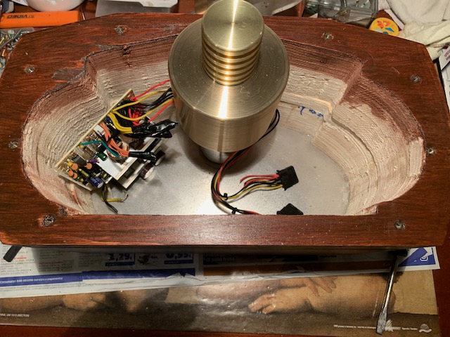

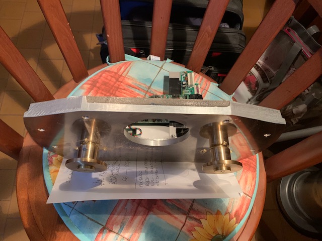

Regarding construction of the fly wheel bearing ( main problem is here ) :
Out body of the bearing is made in aluminum
Bushes made with bronze, but not sintered one
Thrust plate body made with aluminum, thrust plate made with bronze, thickness of the bronze thrust plate 6mm.
Diameter of the shaft 19mm
diameter of the thrust ceramic sphere 5mm
By the way, if you lathe a hard steel shaft with 19mm diameter at the temperature of 20 degree, you check its diameter at that temperature, later you check the diameter at 28 or 30 degree what would be the diameter difference? Because there is a difference and this difference might give the RPM variation I got. Loosen allowance could be but I do not like it in the long run.
In a very precision coupling between shaft and bushes that difference ( that is due the metal expansion ) may change the RPM of around 1.5%. I do not think the temp difference change so much the oil viscosity in fact.

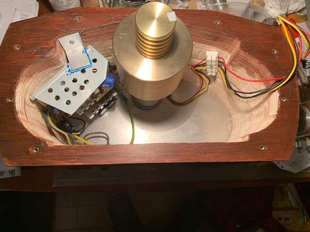

As latest tweak to this TT I made a Motor pod with fly wheel and 2 motors.
The idea was to get better sound and possibly get closer to the Lenco dynamic without its rumble. Rumble I got pretty good, platter bearing I am satisfied, Speed reaching I am not satisfied as takes to long to reach. I cannot play immediately LPs. Therefore I am encountering some problem as above. Why I do not give up? Easy to swap from single motor to fly wheel pod as they are not attached to the TT. Well DIYer likes to make things otherwise they would not be DIYer.

I have a laser tachometer with its fixed pod to check the speed continuously while spinning either the motor s pulley or the platter or play music as well to see if during the dragging of the cart there are any speed change.
Question: has anyone of you with your TT system ever checked the sound related to the TT RPM to see either you are doing pretty good or could be improved? If not you might be surprised of the out coming result. Also checking when you just start the TT and after 10 or 20 minutes of spinning what are the RPM. If you have a DD drive as my friend he did not notice anything with the tt strobo, but once we compared the two TT and mine sounds better than his.
I mean check with a precise tachometer that give numbers and not the standard strobo.
I do not use the cell App to check the speed as it is not that reliable and precise in my opinion.

Hi Wiseoldtech,
If you like to talk to a super super individual picky guy I introduce you one of my friends and by the way you shall listen to one of the best sounding system I ever listened.
I believe that in the DIYer community there is a normal attitude to make things good, though sometimes we built things that economically do not worth to be made, but we still make them. A commercial good Fly Wheel is costly, I suppose few thousand dollars... But also there are guys that think a turntable do not need to be precise, need just to turn, as far as it turns is ok. These guys might even use the Chinese restaurant TURNTABLE to listen LPs, I suppose....
However even I do not have so good ears anymore due to my age, but it is still possible to spot the different sound as I described above even for a modest system as mine and using the cheap Denon DL 103 cart. When the system sounds good I clap the feet following the music ...... good feeling indeed.
I do like quartz locked DD unit especially the Yamaha GT 2000 from the 80s, but too costly indeed and not DIY fun after all. My SCARRAFONE ( Italian slang to say when even an ugly thing i believe it is the most beautiful one ) have some nice solutions and after all except for the Fly unit, for the time being, my TT perform pretty good and is not too ugly as well!
AS DIY i do not have knowledge to make electronic things, especially a quartz locking unit that if not a good one provide musically worse result compared to the fixed speed one. My knowledge is more mechanical and for other solutions.
Tks n Rgds
Adelmo

Hi HIten,
My Motor Pod it is separated from the TT therefore I doubt that the heating reach the record.
Tks n rgds
Adelmo
