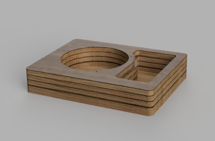

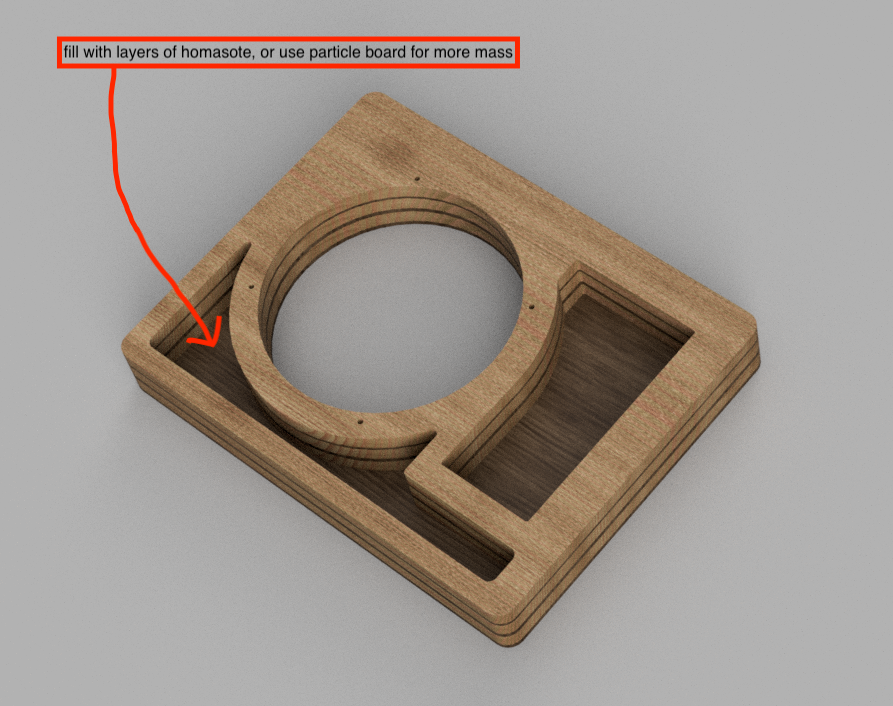

For the OP the following is a deviation from your initial inquiry, but as you are inquisitive about this subject, I have offered a further contribution.
To get the project underway, choosing the Material for the Plinth is maybe not the most important consideration.
As there are already material choices on your list that are known for their valued properties as a Plinth Material.
If a home built plinth was produced from easy to acquire material,
it will be a good exercise to refine a few machining skills and help in producing a Plinth to be used with the intent of learning about the environment that is to be produced for the TT be set up in and function in.

There is a school of thought that ideally the turntable bearing and tonearm should vibrate (or not vibrate) in UNISON, that is, tightly coupled. If they vibrate independently then their contact point when the stylus meets the groove would create a chasm and vibrate more than the sum of the two components, hence the use of grommets at the tonearm base a la SME is not ideal. The COMBINATION of tonearm and turntable bearin should be isolated or decoupled from extra vibration such as speakers and footfall noise, etc... This adherence to tight coupling leads to some extensive measures such as using the same mounting material machined as one piece from bearing to tonearm base to ensure if any possible vibration generated they would vibrate in unison.
Thank you directdriver. Are you also of the opinion that in a good direct drive table that motor vibration is not an issue of concern - and that external vibrations are the main concern? That opinion is has been stated by several users on this thread.There is a school of thought that ideally the turntable bearing and tonearm should vibrate (or not vibrate) in UNISON, that is, tightly coupled. If they vibrate independently then their contact point when the stylus meets the groove would create a chasm and vibrate more than the sum of the two components, hence the use of grommets at the tonearm base a la SME is not ideal. The COMBINATION of tonearm and turntable bearin should be isolated or decoupled from extra vibration such as speakers and footfall noise, etc... This adherence to tight coupling leads to some extensive measures such as using the same mounting material machined as one piece from bearing to tonearm base to ensure if any possible vibration generated they would vibrate in unison.
One reason I continue inquiring is because of some communications I've received on a different thread. For example:
"Direct drive has this challenge as you note, the motor shaft is coupled to the platter directly, hence the name. Most of these systems mount the motor to the plinth and then the tonearm to the plinth without a third brace or casting to couple them more rigidly. The idea being that the plinth should be designed to be rigid enough to keep alignment and also to provide damping. Belt drives, when properly isolated, do not require damping and it is actually another benefit of that system since damping effects playback. In a DD system where it is unavoidable to have some coupling of vibrations, creating a feedback loop with the stylus and record (platter), damping is often a topic of much design concern."
See in bold. It sure reads as if this contributor believes that direct drive motor resonances are worthy of some consideration. Either that or I've misconstrued his intent. I've sought clarification.
But you can imagine that for a newbie like me, when what appears to be inconsistent messages are offered by folks who seem to be experts, confusion quickly ensues.
Thank you again for your input. I think the shorter version of this is that you recommend I use an established material(s) and focus on quality of build and then experiment next with a variety of setup variables. Then once I've acquired some first-hand experience and knowledge of my own, I can start to expand. And that this makes sense because in the big scheme of things, the plinth design is only one of many variables and not the biggest area of concern.The options available to come to understand how changing a material will change a Resonant Mode within the TT>Tonearm>Cartridge is relatively easy to achieve.

I've been pondering the same question here, trying to design a plinth for an sp-15 that will be (within reason) as good as I can make with the tools and materials I have and the energy/time that I have to invest in the project.
My biggest concern is separating out footfalls from getting amplified, since my room does not have particularly rigid floors. the smart thing to do would be reinforce the floor from underneath, but that's not happening any time soon.
Regarding using resin/bentonite, don't count that out. It doesn't have to be touched by your woodworking tools. I imagine you can build a box to use as a form out of the wood of your choice, and then cast the resin mix directly into the form and leave it there. nothing to machine, no worries. I'm tempted to try that in my design, but probably won't be bothered with this particular iteration.
for what it's worth, I'm going to go ahead and make mine using alternating layers of hardboard and MDF, partly for ease of manufacture, partly because I already have the materials I need, and partly for looks. Sandwiched together in layers and finished with oil/urethane, the hardboard gets a chocolaty brown color, while the MDF will stay a nice golden brown. I'm vacillating between making this a solid chunk of material with hole for the motor board and tone arm, and having the solid chunk hollowed out in spots that can be filled with newplast/Plasticine/resin with bentonite, sand, lead, or whatever else strikes my fancy. Another option would be to sandwich in pieces of particle board in those voids.
I have the benefit of a CNC router at my disposal, so my design is going to follow somewhat within the capabilities of the machine to make things easier for me.
Here some pictures of the basic design. there will be a board mounted for the tone arm in the semi-rectangular hole on the right. I'm going to need some kind of isolation feet with this, so will either do sprung rubber feet of some sort, or maybe make some cones?
I'm curious to see what y'all have come up with, or been thinking about.
I really don't think there's any sadness in making a plinth from particle board. other than being moisture sensitive, it's supposed to be pretty good stuff. of course you'll need to fill and paint it, or veneer it to make it look nice. seal it well to prevent attack from moisture.
the above are quick renderings from my 3D modeling program, but finished product will look similar.
