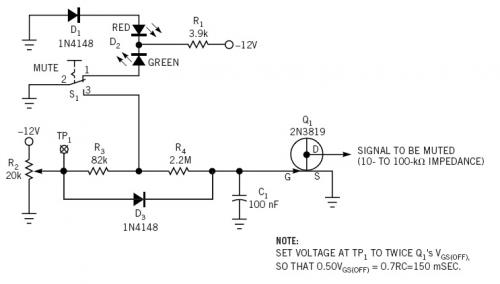

Granted I don't have the degrees that most people do that frequent this forum so take this with a grain of salt. As I have mentioned in an earlier post in the early days of this thread the simplest thing is to exercise caution as to how the system is being shut down. Unfortunately most preamps, linestages and such have problems with their supplies decaying uniformly and I would assume thus a noise is produced. Most commercially produced preamps have some type of muting circuit or relay present in the circuitry which masks the whole thing is similar to a dog chasing its own tail. What I have done in the past was to install a small cap across the power switch, install 100K resistors across the supply and use a relay across the output of the preamp to short it upon turn off. While not 100% effective it has partially worked in most situations. The only action that works 100% of the time is to simply turn off the power amp first and then power down the preamp/linestage.

As Enzo often notices, a thump is just an Audio signal, which worst case will reach either rail for a fraction of a secon/d, and as such not different from any other audio signal the amplifier is rated and expected to handle.
Or as a practical example: if the amp doesn't die or get damaged by a loud kick drum kick, (and it shouldn't) , then why would a thump damage it?
Even more, you can have *one* thump at turn on, *one* at turn off at most, while you can listen to drum solos or mi,itary music with cannon shots included for hours.
