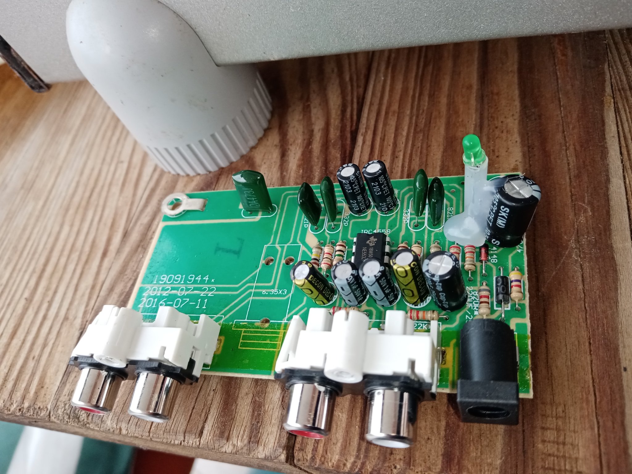

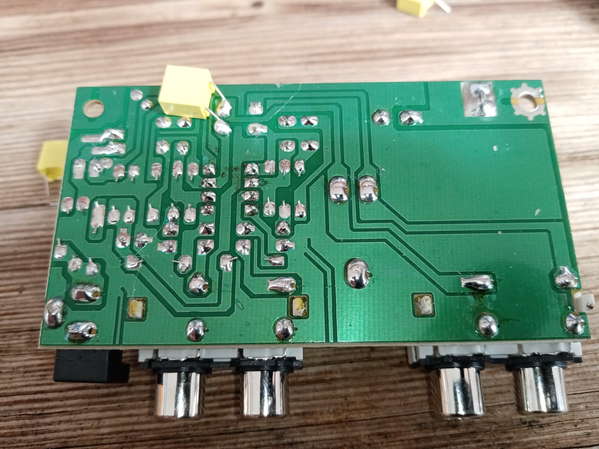

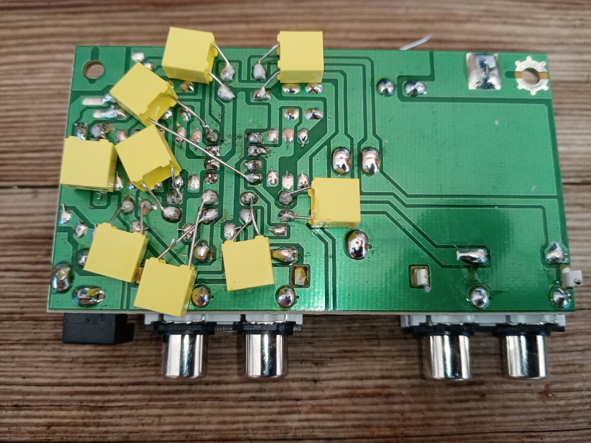

Here some pictures modding Phono Preamplifier
Dynavox TC20.
In this forum there is a modding of a similar but different version:
https://www.analog-forum.de/wbboard...gegen-ear-834-clone-oder-david-gegen-goliath/

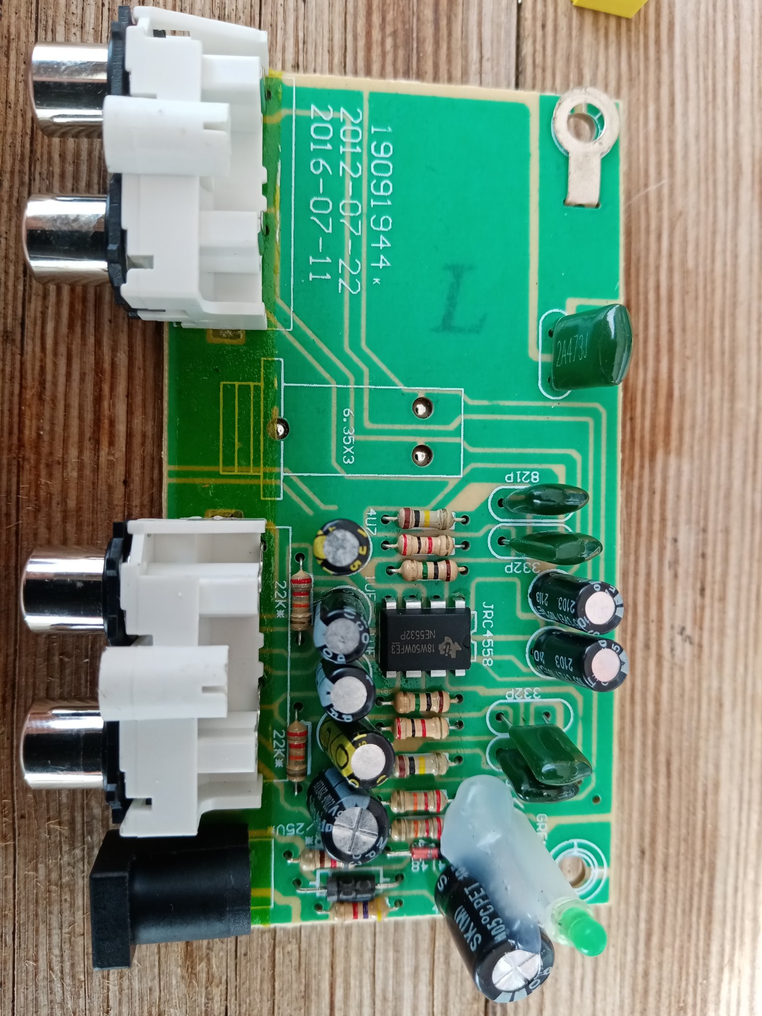

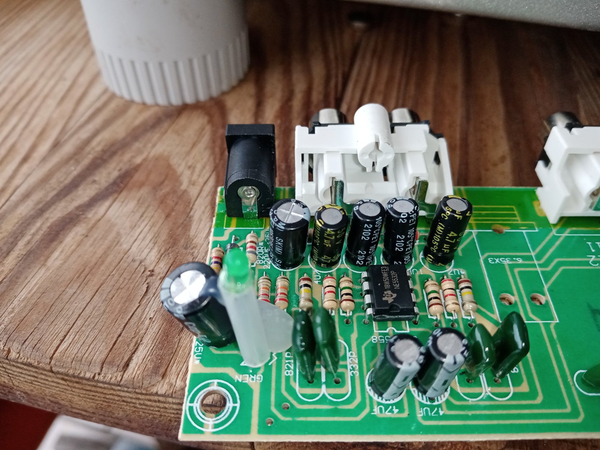

In my Preamp is a NE5532 op amp instead of the 4558.
As this component is good enough my mods only concern putting to the electrolytics foil capacitors in parallel.
One cap is across the rails of the op.
I think I will buy another preamp of this type to make a listening comparison.
And later putting an LM4562 in it. The 4562 is an op which I liked a lot in an old Nad CD player and made it sound very good.

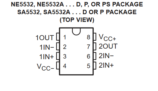

If I would like to transform the NE5532 to class A.
From which leg(s) of the op to which leg I would have to wire a resistor of what value? 10k?
I did not change the wall wart of 12v.

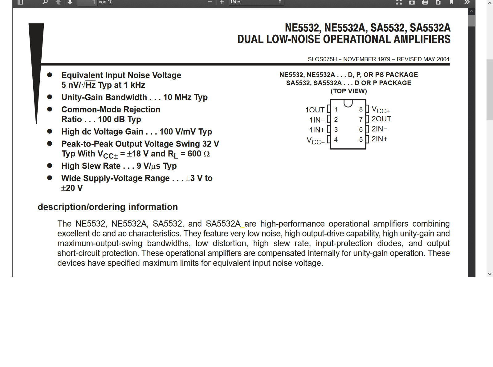

Would a power supply of 15volts instead of 12 volts bring more dynamic sound or dynamic headroom? The caps are all rated 25volts.
The max power supply for the NE5532 would be 18volts? Or can it stand even more?

I do not mind this Phono amp has + - 2 dB from 20hz to 20khz.
I would not modify it to be more linear as I would use it for not EQed fun type fullrange loudspeakers which deviate in response much more.

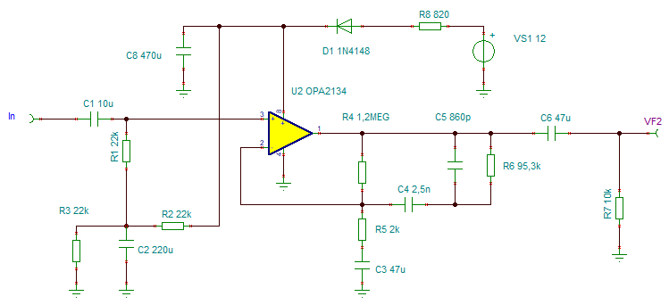

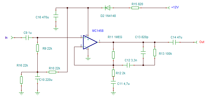

Ah, in the other Dynavox TC-20 was an MC1458 which was changed to opa2134. I added here the schematics so you can see what was changed in order to make it more linear.

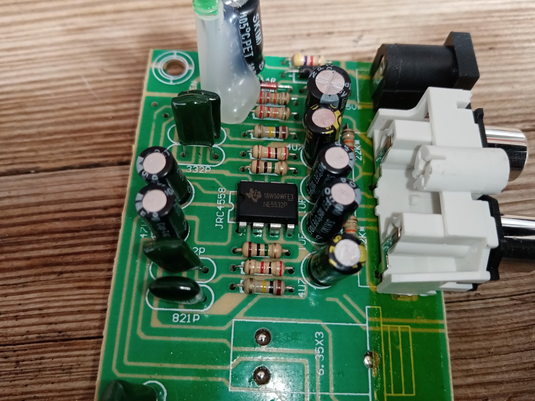

On my board of the Dynavox is written 4558 to be put in but there is a good NE5532 in it. Not worth changing it. Already very good specs.

I do not think that putting the IC into class A mode would bring any result. The NE5532 has very low distottion.
If you are a loudspeaker guy than it makes much more sense to tweak your loudspeakers which are the weakest link in the audio chain.
