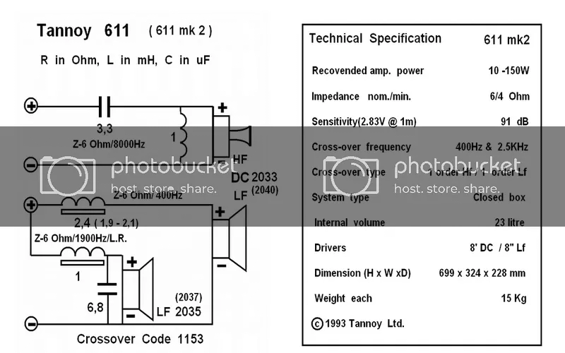

You'll find a larger copy of the Tannoy 611 crossover schematic here: Tannoy DC1000/2000 Crossover
This should put the crossover wiring into perspective.
Thanks a lot! It's a bit hard to read, though: is that a 6.8 uF in the 2nd order lowpass?Compare this Tannoy crossover (8" dual concentric driver / 8" low frequency driver) which has crossover frequencies of 400Hz and 2,500Hz.
This speaker appears to be at least similar to my D500, looking at the drivers. Just the highpass section is a 2nd order type, while I found a 1st order in my D500. One similarity, though, is the 3.3 uF (correct value?) in the 611 highpass and the 2.2 uF in my D500 highpass. This leads me to another question: could it be that originally there was a 2nd order highpass in my D500, just modified to a 1st order and stopping work on half way? Just adding a 1mH coil to the D500 layout should result in a 2nd order highpass somewhere around the crossover frequency of 1700 Hz, as reported.
I think this is something I should ask the guy who modified it nearly 20 years ago. Maybe he will remember.

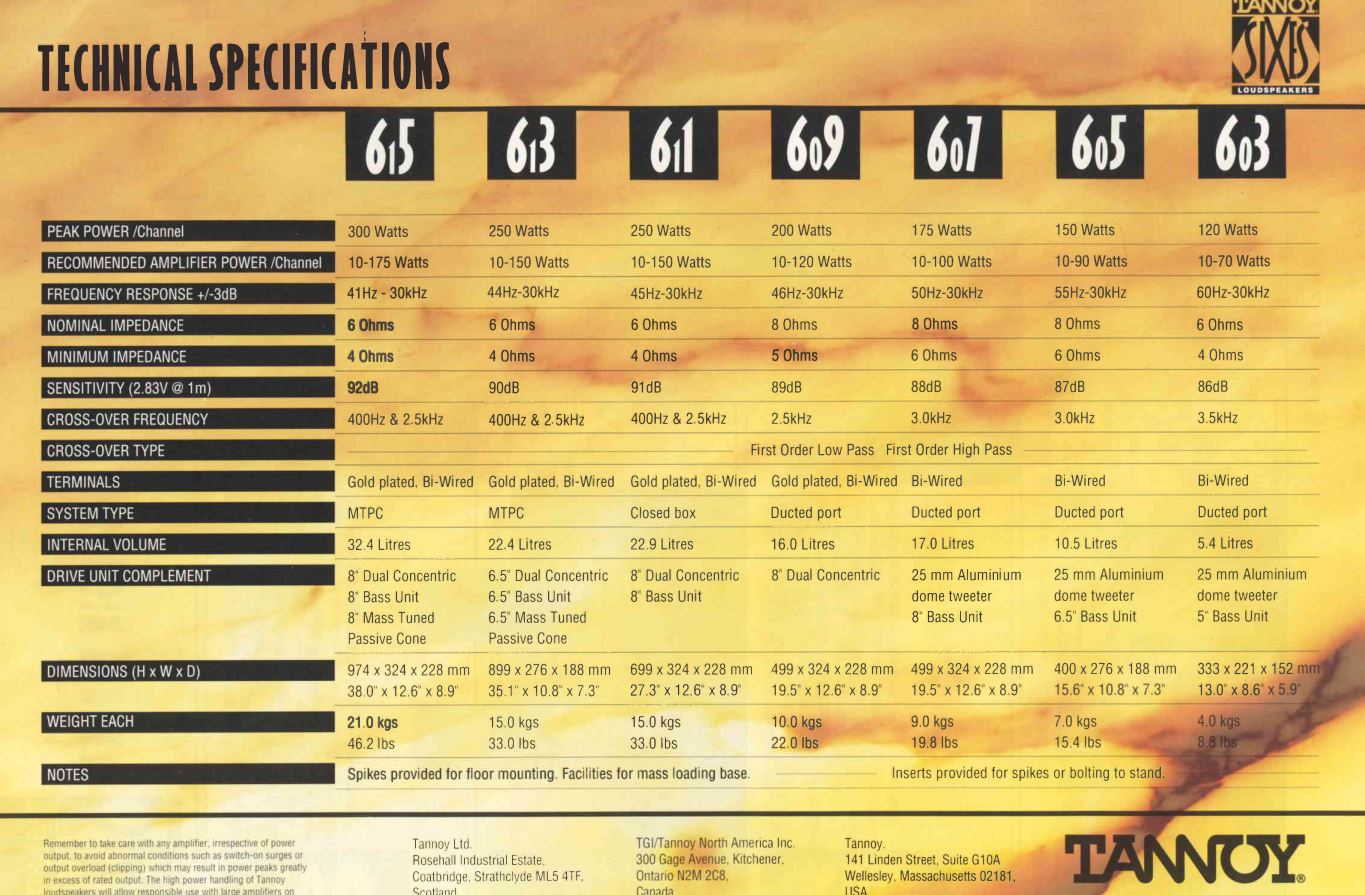

One discrepancy between your schematics and the flyer I found: the flyer states 1st order highpass for all Sixes, while your schematics for a 611 Mark 2 shows a 2nd order. Maybe this is what was altered in the Mark 2 series.

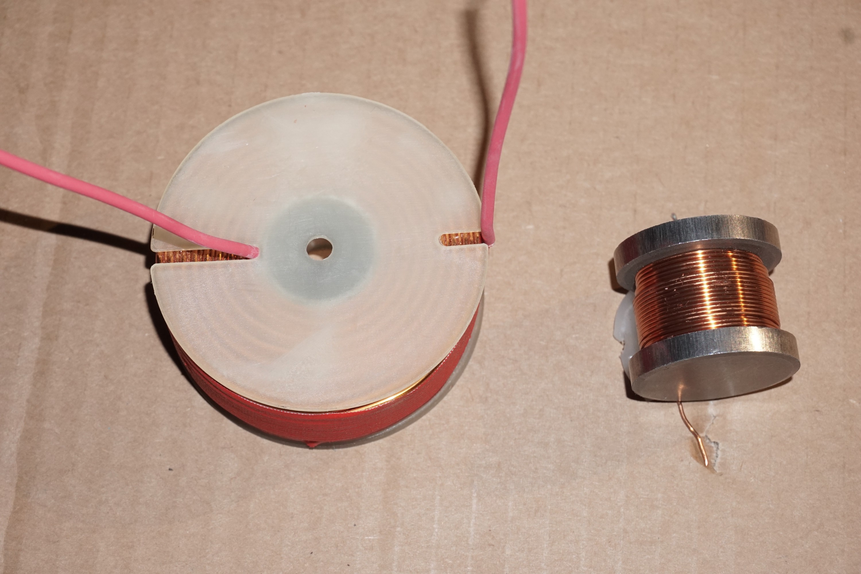

For the next step, I ordered a pair of Mundorf 2 mH / 1.4 mm air coils for the 1st order low pass. These are too large for board assembly, so I'll probably place it close to the bass driver. This will also free some space on the board for those 'stacked' capacitors (see photo). I don't like this sort of 'stacking' at all.

So I'll replace those iron core coils by Mundorf air core for now, and will try to attach my new wiring properly after getting rid of that excess glue around the contact points.

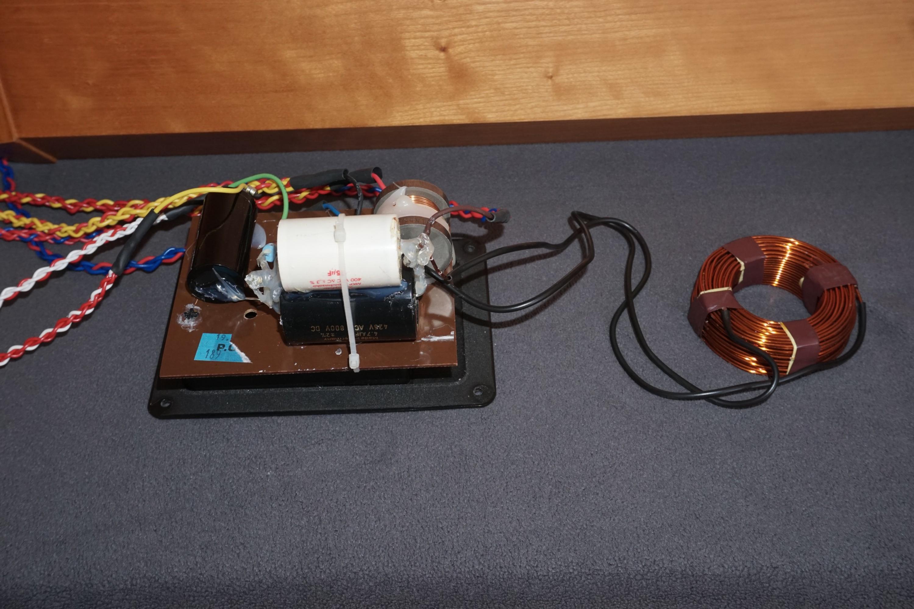

Ok, I did it. Last step working over my Tannoys, at least for now!
I can assure you: unsoldering can be kind of a nightmare when masses of hot glue are used on the crossover network.
For some time I considered to make a completely new crossover, but all parts are absolutely ok, and in the end I only wanted to get rid of that iron core coils and implement those Mundorf air coils I had bought for the bass section. So I decided to go the relatively easy way and perform only those steps necessary.

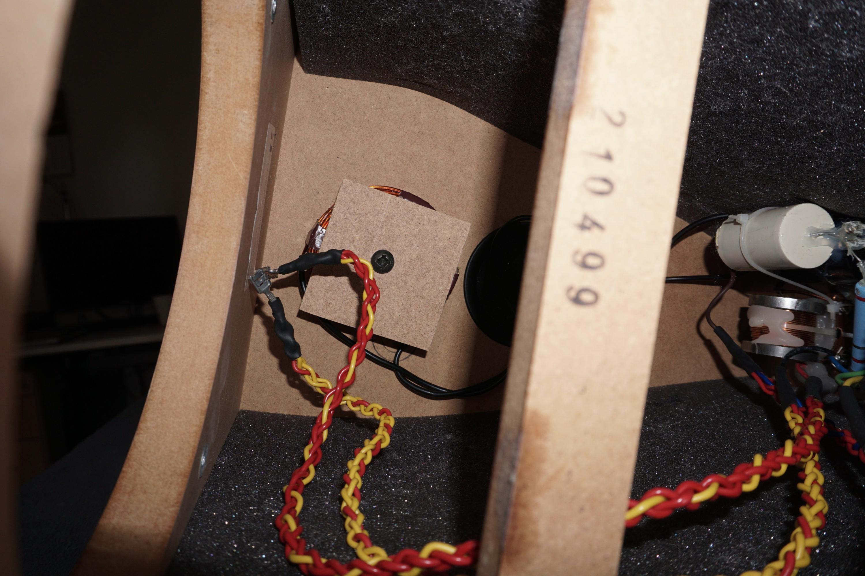

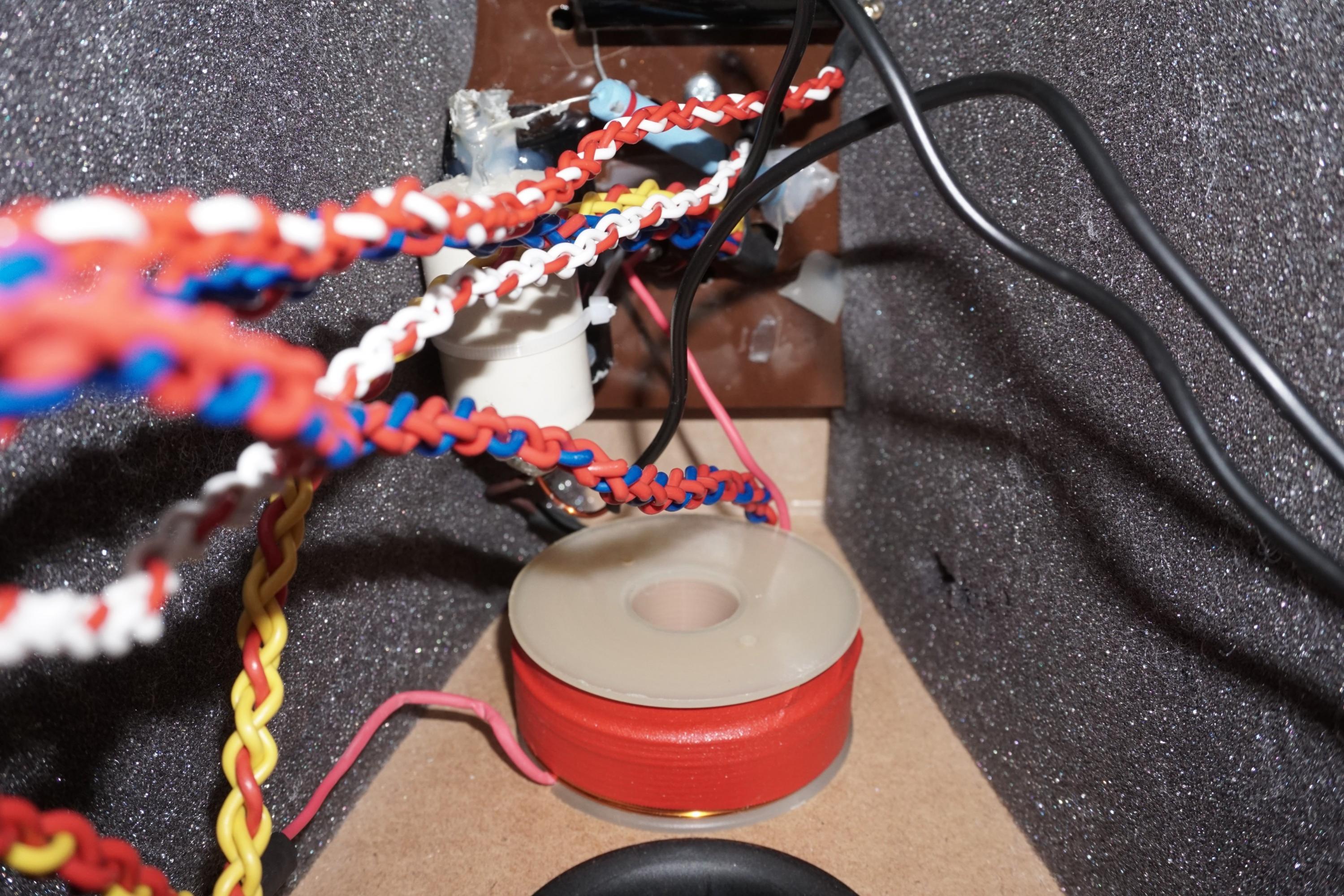

Old and new situation inside the cabinet.
I left the air coil for the midrange section where it used to be and placed the new one close to the crossover network, tightly screwed to the cabinet. This was the easiest way to do it.
