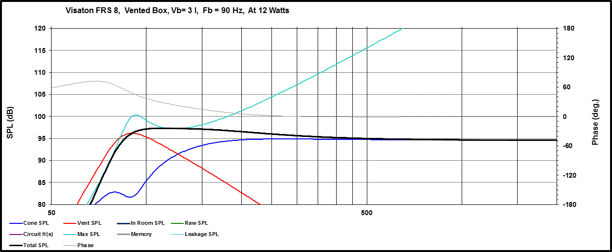

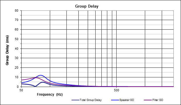

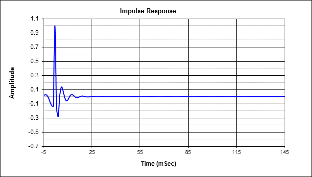

The attached vented sim is based on Vb 3L, Fb 90Hz, Dv 1.12", Lv 2.92", HP BW4 75Hz, EQ1 (-2dB, 72Hz, Q2) and EQ2 (+3 db, 90Hz, Q1). F3 is 83Hz, F6 is 78Hz and F10 73Hz.
Problem with tuning as low as 85-90 Hz is the limited power handling (mecanical/Xmax limit). Max power to hit Xmax+15% in the sim is 12W. Max SPL is 97dB allowing about average listening levels of about 80dB (1m).

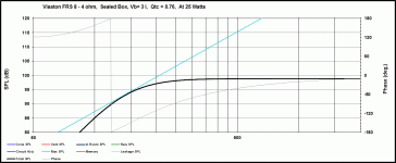

With a Qts of 0.69 you will find it difficult to get away from the hump in a vented enclosure. Could you go sealed and use a sub instead? Or FAST? The attached sealed sim is based on 3L and HP LR4 140Hz (after equalised flat to 30Hz with LWT). F3 is 172Hz, F6 is 139Hz (xo point) and F10 is 115Hz. You hit Xmax+15% with 25W for max SPL 99dB.

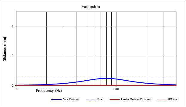

The Visaton FRS8 has an Xmax of +- 0,5 mm (taken from Boxsim), so the sound pressure level will be even lower. The value of +-2,5 mm refers to the Xmech. I own a set of these drivers and they start to distort badly beyond +- 1 mm. Distortion at frequencies below 200 Hz is high anyway.
