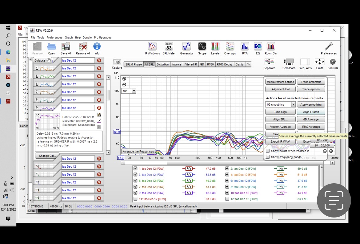

I take 9 gated FDW 15cy measurements around my head. I use REW and shift IR, smooth , time align and vector average…
Send average to rephase for work….
Result is fantastic… my goodness it sounds stunning…

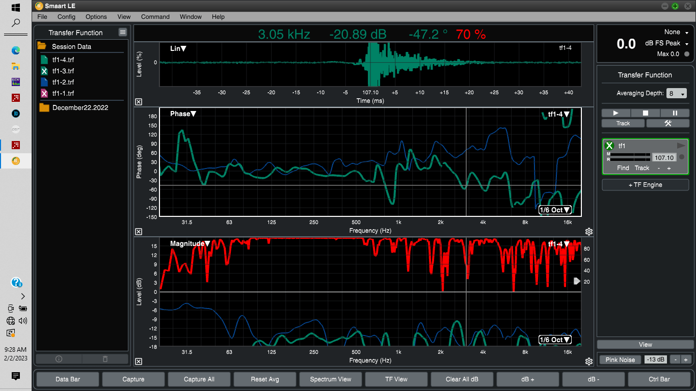

So , in my quest for accurate fast mag and phase data , I bought smaart (v9LE) and I also bought the Roland octa capture as recommended by @Rational acoustics.
I also bought works M23R mics… so I have a nice array of very expensive nice mics…
I spend a month getting it to work right, finally getting decent data…. (Except smaart crashes like crazy) watched all 12 , 1hr trainings for smaart on you tube many times for a few of them.
The smaart tunes do not sound anywhere near as good as my REW tunes…. It’s close but it’s not near as good….
RA says to use 1 mic for phase , although I can use up to 8…. All I want is very clean phase data and quickly…. That’s it , I can do the mag stuff in REW, that’s easy,..
Does anyone know how to get smaart to work like REW in this example? I’m not sure it ever will….
Should I ignore RAs recommendation and do multi mic TF for phase anyway? Or what is the key to get the same results as REW or close to?
I got the measured phase preferctly flat on both side to match exactly, following same rules (phase changes only between 100-1600hz)…. The center image is spread out and blurry… it’s still mostly a good center , but I would expect perfect being mic is directly between my ears. I did all the work on same session, same settings, same volume, same mic placement… same everything… did left and right separate on an OpenDrc..
I hope it’s a setting I’m missing….

Hi Andrew, sounds like you've made a ton of progress ! You're going to be our resident expert at measurement avering before long !
Good to hear the results you're getting with REW; sorry to hear Smaart hasn't been going so well.
Since you're building your FIR files manually in rePhase, it does seem like any difference in results is all about the measurement averages.
(I haven't made many measurements since our last PM exchanges, so I don't know if the new version of Smaart crashes on Windows have been fixed. I've been deep into non-audio projects since turn of the year. Just this moment Updated to v9.1.1. See plenty of bug fixes still, uhg.)
I'm surprised the RA folks said to use a single measurement for phase. I think if they knew the extent of the work you're doing with REW, they wouldn't have advised that way.
Complex averaging in Smaart is needed for phase averaging, like vector averaging in REW. Under 'Options', Measurement Settings, Transfer Function: set Mag Averaging Type to Complex.
If you're comfortable and confident going though all the steps in REW, I don't see how that can miss.
That said, the whole purpose of using Smaart imo, is to make it easier to grab multiple-mic captures, and their averages, nice and quick..

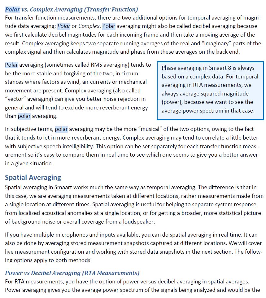

Complex averaging, I’ve seen that in there, and I also think maybe you can clairify if using periodic noise (think they call is psydeorandom) would give better results

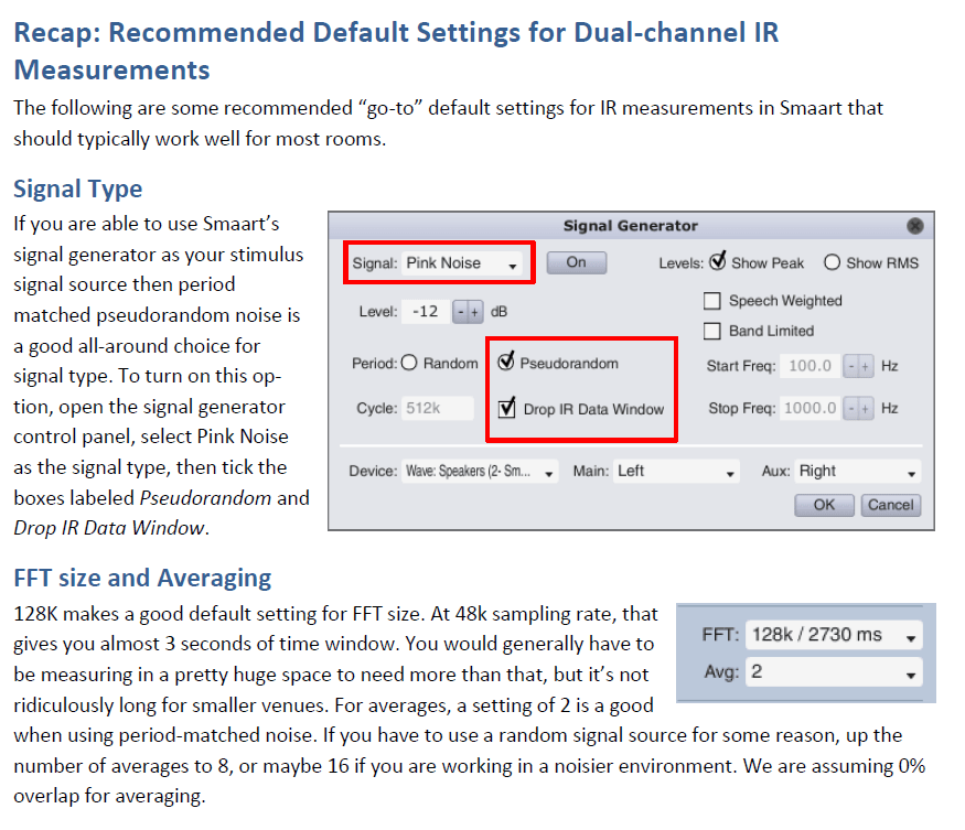

Pseudorandom pink is recommended for Impulse Response work, so I use it for transfers too.
Here's a snip from the v8 user manual (which is still my goto reference for v9. I imagine we will see a v9 manual before long)
Oh, and make sure the FFT size in the Sig Gen, matches the size in the IR Measurement panel.
I’ll try complex averages! Do u think I should apply that globally? Perhaps maybe leave the center mic on polar?
I'd use complex on all mics, as the relative phases of all are important to get right.
The complex is like a FDW isn’t that right? And I can’t find the exact terminology description for both, like what exactly do they mean by “polar😋” averaging? Is that the equivalent to measured phase in REW?
Complex is all about phase, whereas FDW is about how many cycles per frequency get into the display of the measurement.

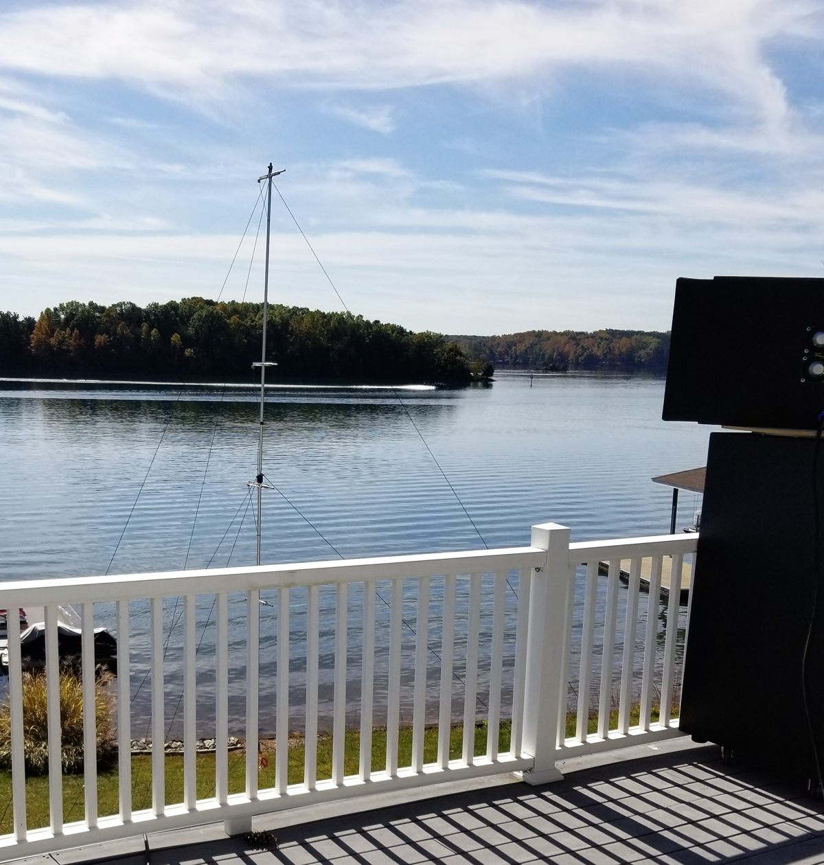

Turn table is just a lazy susan marked for degrees on the circumference. But with it and multiple vertical mics, I can quickly grab more data than my mellon can handle.
The mic tracker, I have a eBay battery powered fan that oscillates 160 deg , I cut the fan off and mounted a mic clip to it so it can silently move a mic from left to right, I was using that before the array, do you think that single mic with the tracker on would do better? Then it’s a single mic but gets averages (not sure how that’s different from a mic array but maybe)
Dunno, but I'd try it further. I've rotated my syns back and forth on the turntable, and captured doing so for 10-15secs.
Then, using FirD to auto-generate a FIR file correction for that moving average, go back and measure with FIR in place for the same rotation.
Measurement comes out perfect mag and phase....which just says to me, be careful what you ask FIR to do, because it will do it ! lol

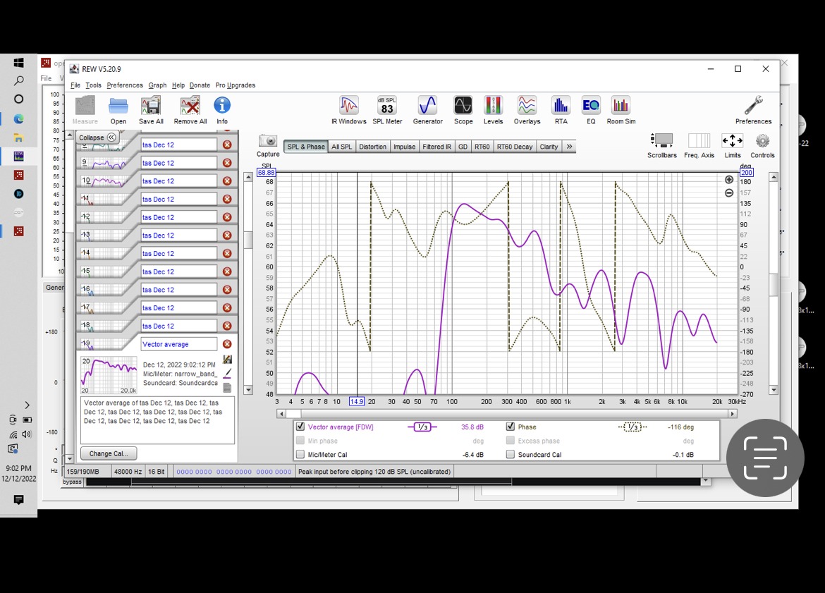

Edit , on a side note , I was measuring and looked at my REW tune , on REW it showed flat phase from 100-20k , on smaart get this , it showed -180 from 100-4K then an incline , but the impulse still showed positive polarity… that was strange…..
That's just a function of different constant delays being in the measurements. Polarity won't change with ToF, but the apparent phase curve will.
Try manually bumping the transfer function delay time up and down, to see how the phase curve responds.

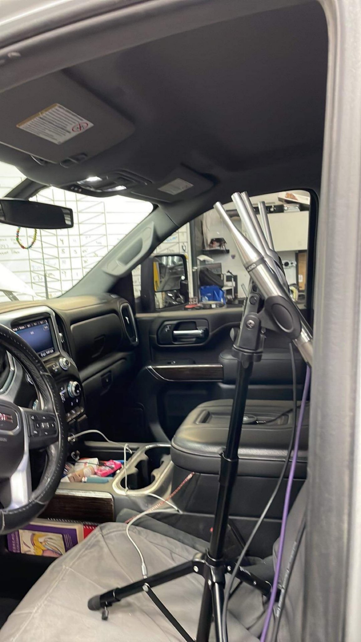

Edit : if I average all my mics should I have them straight up and down? So they’re all in the center… because I have a mic bar in a row…
There’s just a couple random pictures of the set up, I’ve posted a couple of these online in various places but I should take more screenshots I suppose

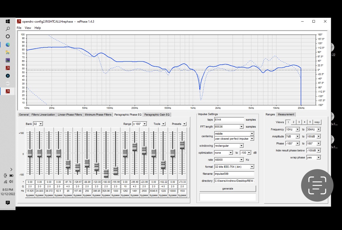

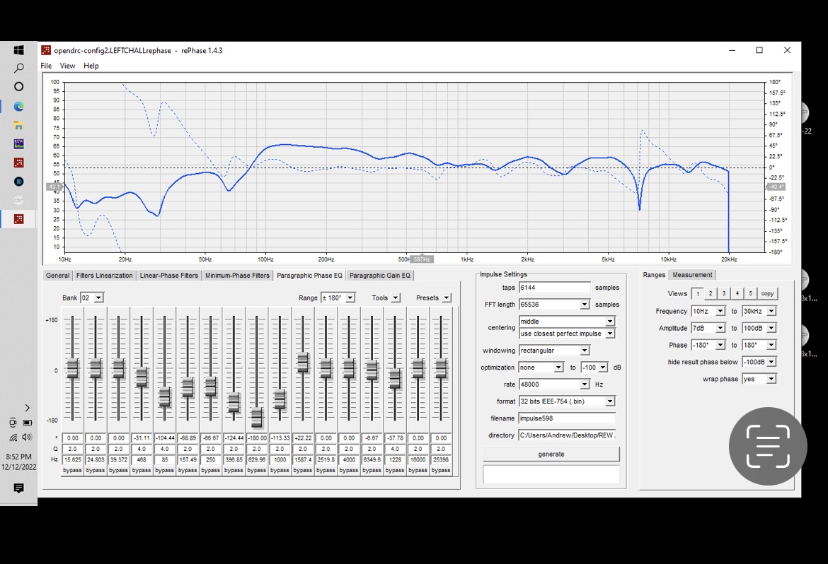

Yeah and see in the pic , the magnitude is all wonky because it’s a single position, which affects phase
The average is flat
The right has sub left doesn’t (don’t ask why)
These filters sound amazing , the phase is flat also …… same tune on smaart (pic in Prost above) totally strange
The high frequency response of an omni mic will reduce slightly off axis, and reflections from the sound bar may affect the HF response as well.
Examples here:
https://www.jochenschulz.me/en/blog/which-angle-is-correct-for-the-measuring-microphone
At 8kHz the differences between 0 degrees and 90 degrees range between 1.3dB for the EMX-7150 and 2.7dB for the ECM8000. At 10kHz the deviation grows to 3.3dB, at 12kHz to 4.0dB with the ECM8000, and with the EMX-7150 1.75dB at 10kHz and 2.2dB at 12kHz.

It looks great, and talks to smaart live…. Okay I see what the fuss is about yeah I am liking that a lot….
Okay so sweeps….. I see what you mean… so you think for driver tuning I should stay with sweeps… like , in my pics above those were sweeps of left and right
In MmM it’s dead flat, the dip at 1k and 6600 are not there in the sums…. But each respective channel in sweeps I can weird dips (that’s a 30 position average also) no matter how many averages I take those dips are there …. Pink noise . Not there and pink noise mmm sounds better so I was thinking no brainer
Okay I’ll revisit that…. Maybe I could use minimum phase eq , make the dip last flat and then do the phase correction only on the modified response. I don’t know how to get rid of the dips otherwise in sweeps and when I tune with them , like that 1k , wow it’s super obvious 1k is way too loud….

If the frequency response corrections you made ahead of time (let's call them mag corrections), didn't fix phase too; then you have to find out why.
It won't be hard to figure out the "why" when doing measurements in a car...
Probably the worst environment one can think of to do measurements, save for a closet or bathroom.
