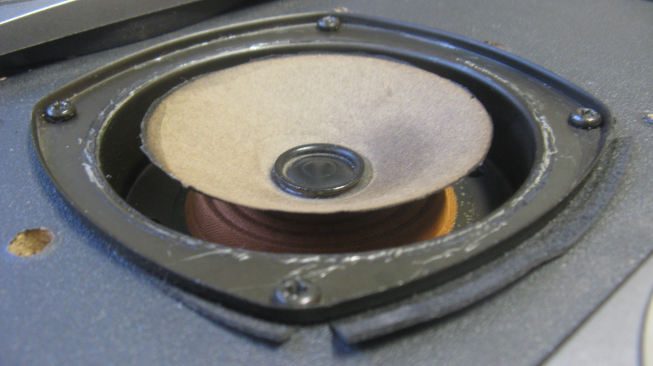

the new coil did not change anything. i guess the problem will be the 40y old rubber edge on the mids speaker. it did get hard.

Just don't be tempted to continue playing the mid without its rubber surround as you don't want the voice coil to go off centre and start scraping in the magnetic gap. 😱

i played only silent and it is glued also on bottom (yellow/brown on picture).

The yellow/brown part is the rear, or bottom, suspension of the cone, also known as the 'spider'.
It has a major part to play in keeping the voice coil centered.

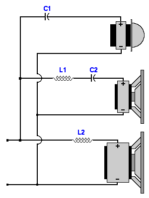

See attached 1st order crossover circuit.
If you are going to rely on your ears to select a tweeter capacitor (C1) then why not rely on your ears to select a bass inductor (L2)? I suggest you buy a selection of crossover inductors and a selection of crossover capacitors and enjoy some happy experimenting!
P.S. The midrange band pass filter (comprising series inductor and capacitor, L1 & C2) really has to be calculated. Here's a suitable calculator for this purpose: Band-pass filter 6dB per octave

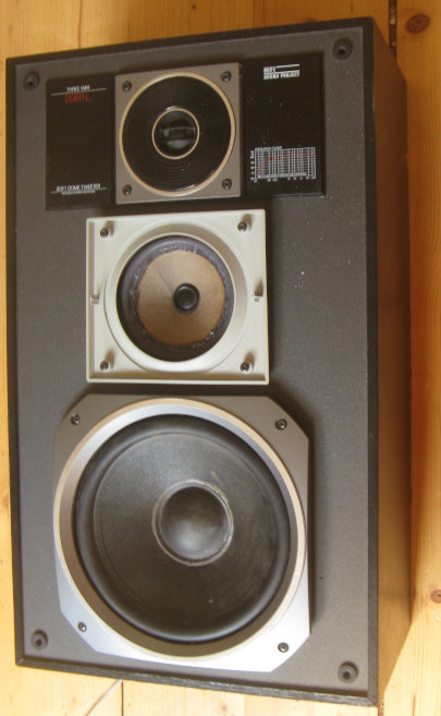

the 4,5 inch ring did not fit either. must be because of the metric system in Belgium i guess. I glued it anyway but got to use of lot of it as i had only 1-2mm contact between the ring and the cone.
plays nice and i hope i do not have to touch it now for at least 10 year now. (did not expect that project to be so time consuming)
here is the photo and even a short video as promised.
