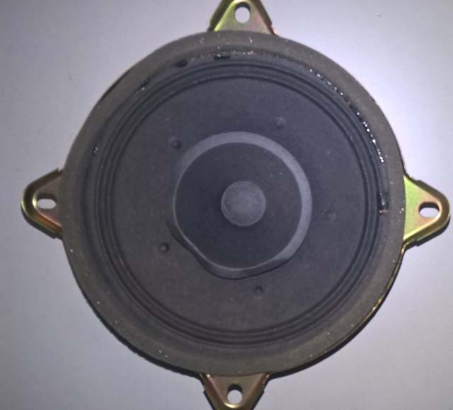

This is likely to be the original, matching Philips 8" driver. AD 50800 M8. It is a full range driver
Here's the data sheet: Breitbander

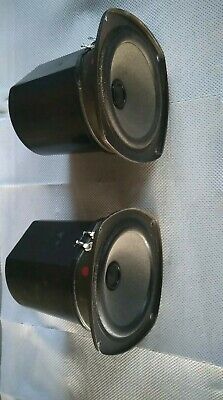

Mid drivers image attached for good measure! 🙂

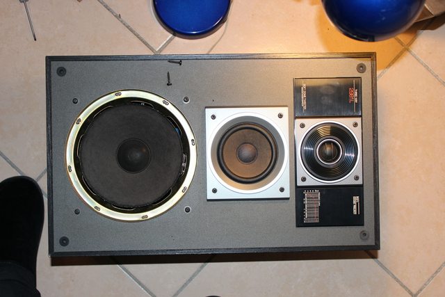

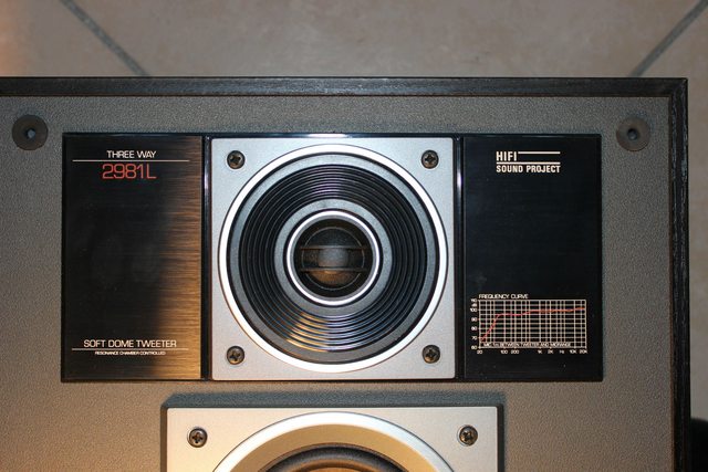

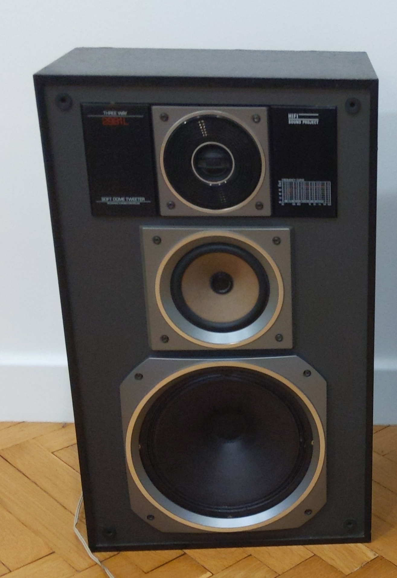

here a pic of the box. by the way i already ordered this bass speaker as replacement.
Yes, not what I expected either! Since you've already ordered the replacement, I can only suggest you try it and come back if any problems result.
Am I understanding you correctly - you've only got one speaker cabinet, not a pair?
Would still be interested in more photos, particularly of the crossover network.

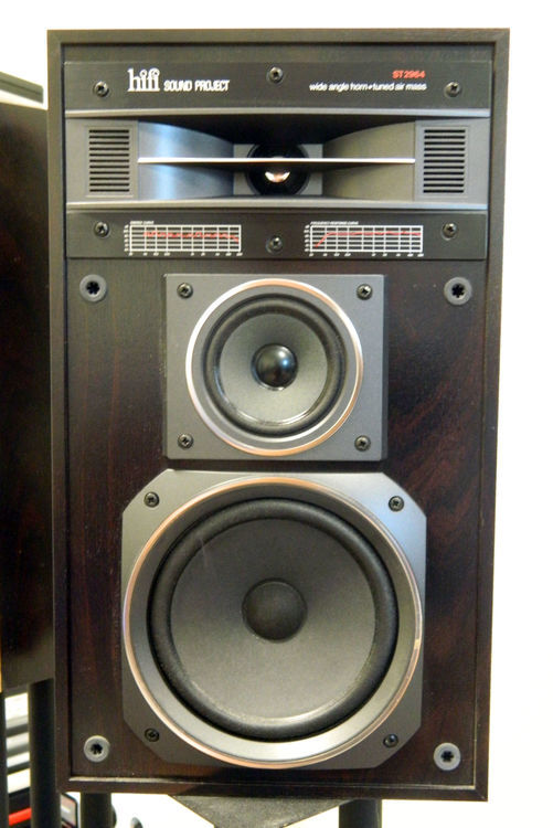

Seems there was more that one Hi-Fi Sound Project loudspeaker model!
Attached is a photo of the ST2964/OOP.
I'm not finding information re the manufacturer which only intrigues me!

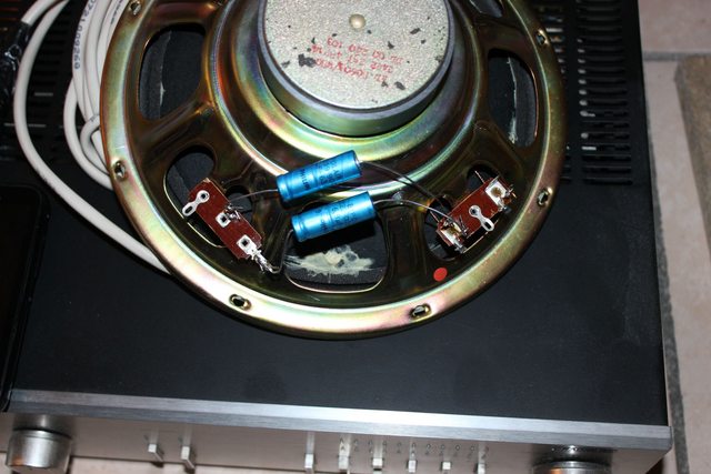

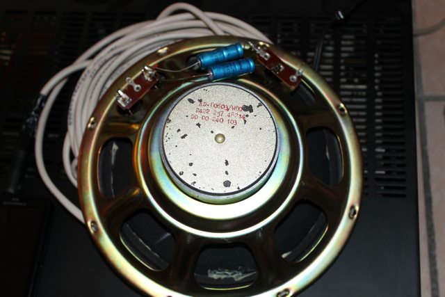

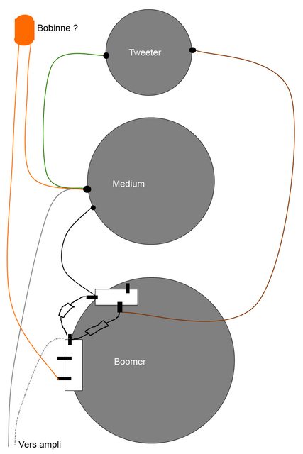

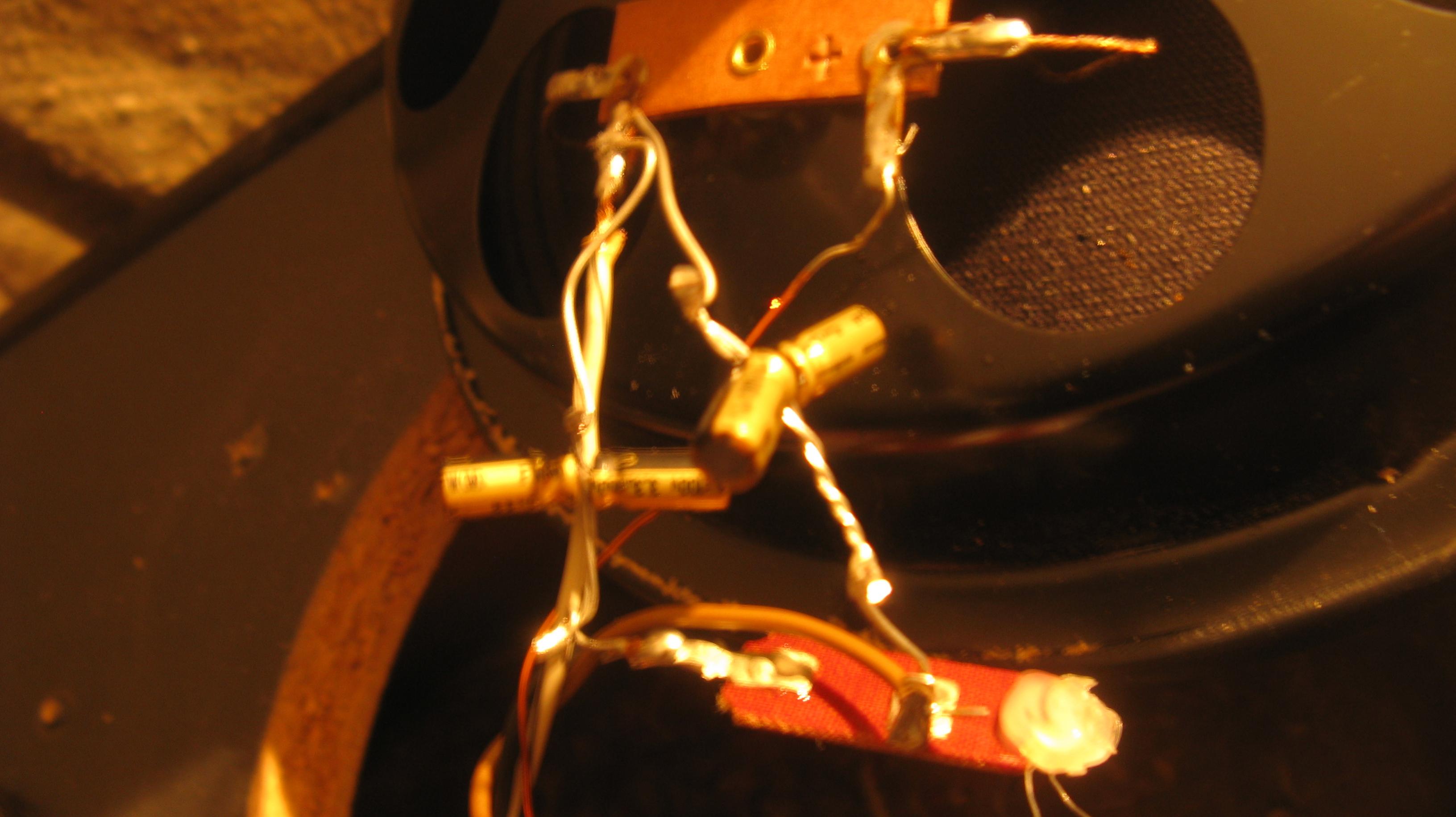

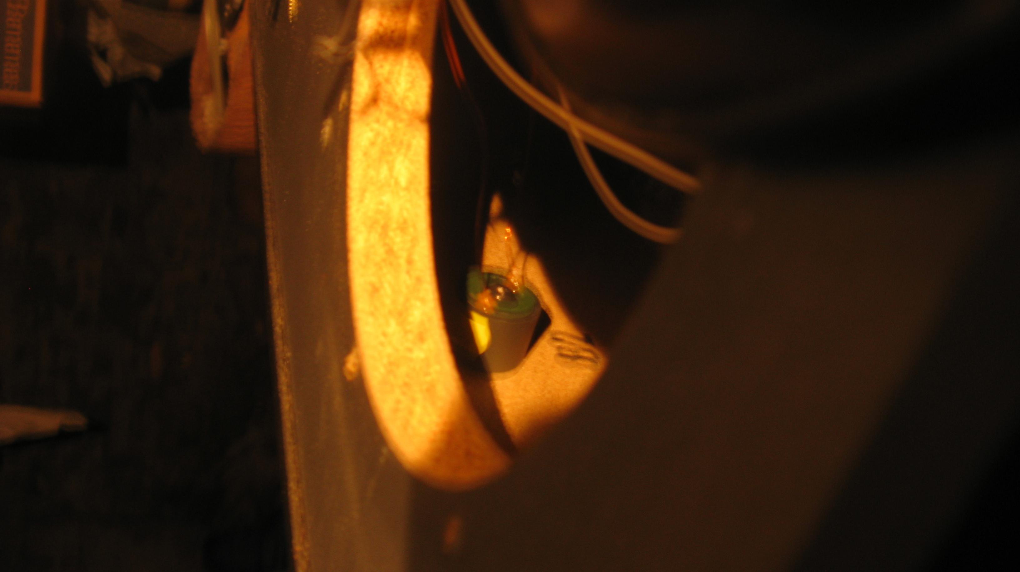

crossover pic. description:
on the top you have + of the low speaker. there is a copper wire connected which leads to the coil (other photo) and then to mids i guess?
on minus a white cable.
a brown cable with 2x1uF capacitors (originally it was one with 2.2uF)
a black cable with 2x3.3uF capacitor (originally it was one with 6.8uF)

Looking at that wiring, perhaps you need to wait for more advice before fitting your replacement bass driver! The manufacturer's original one had a peculiar arrangement. Can you show a photo of how the current replacement is wired - a mistake there may account for why it doesn't meet your expectations. What do you make of it Dave?
EDIT: Got your photos, just saw your edit!

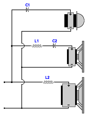

Looks like the original bass driver just had an extra set of terminals to hang the capacitors on and I see an extra set of terminals in your photo. Looks like the big cap goes to the mid and the small cap goes to the treble. Can you confirm?
Not a very satisfactory crossover and the cap values don't seem to make sense.
Ideally, your crossover would include two inductors (coils) as shown in the attached diagram. However, your wiring appears just to include the capacitors - no inductors.

1. the wiring looks like a mess because the crossover was mounted on the lows speaker and this was replaced by somebody who did rip it off the speaker.. but as far i can see nothing was changed on it. it just hangs loose. no short circuit visible when i checked it.
2. it looks like your first diagram with just one coil but to be sure i would have unmount the mids and tweeter also and that means 16 screws out and in. maybe i will do it but i guess your diagram is already the correct one.
3. replacing the mids capacitor to 12uF. thank you for that idea. i can give it a shot but i have only electrolytic caps (nichicon golden caps and some nichicon regular ones) at home and not sure if i have exactly 12uF. would have to put some in parallel again to get something close to 12uF.

The two coils are usually needed in the two LP points: one for the woofer and one for the midrange, as you'd never want to let the speaker run full bandwidth.
