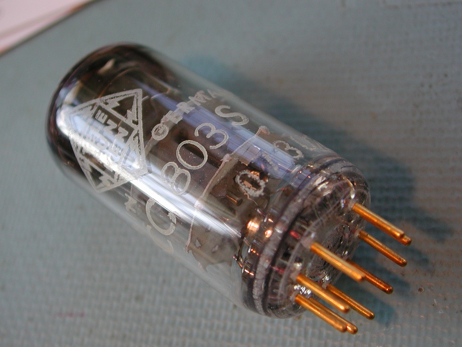

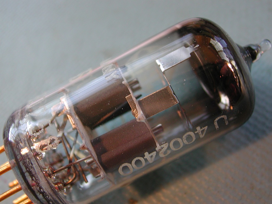

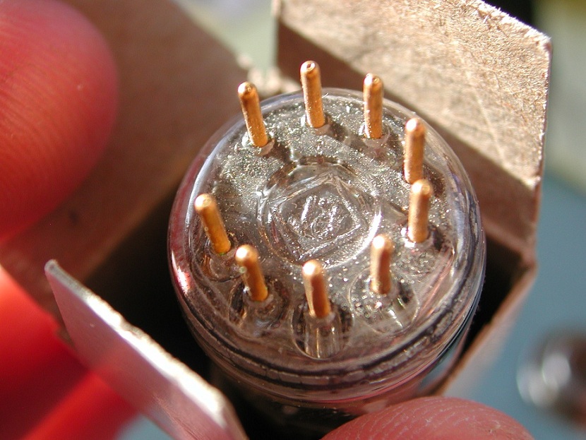

Well, now I had to look again.....and it appears to have a diamond....but the printing on the glass is clearly not the flakey stuff typical of the other Telefunkens in my stash.
What a lucky guy you are, boywonder!
With the diamond at it's base it obviously is a TELEFUNKEN ECC803S! Counterfeiting the diamond takes that much effort that no one has tried it yet.
Congrats!
Congrats!
Well, thanks! (I think....) before I break out the champagne....there area no seams in the glass either.....and the gold pins are mighty shiny for a 50 year old tube.
I only have one of these, so it won't do me much good in HiFi anyway......if it's authentic I'll probably sell it to fund other projects.
IIRC there shouldn't be seams on a Telefunken tube (I have a number of different types), and the gold will look as new in 3000 years as it does today providing the plating is thick enough, and it hasn't been plugged into a socket frequently enough to wear it.
Thanks Kay, DF & Kevin!
I checked a few of my other Tele's and no seam.....
Usually the owner of the item in question is attempting to convince others that the item is not a fake.........:eek:
I'll have to test it on my Hickok; it looks new.
now back to our regularly scheduled programming....
Good luck! And don't forget to mention terms like "TELEFUNKEN", "ECC803S" (of course...), "diamond button", "famous frame grid construction", "special quality" etc. in your offer. These will bring you the money you desire!
