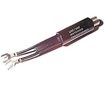

There is the simple Dipole which commonly came in the box of the tuner when new, it was an opaque white flat wire, T shaped.....which connected directly to the back of the tuner, at the 300 Ohm terminals.
The coax either had a screw in terminal, or one had to convert the 300 to 75...thru your cable & reconvert back to 300 at the antenna.
I found several DIY sites that build their own antennas...I found one that makes a DIY # Collinear Array# ..This particular antenna puts out a pattern similar to a flattened doughnut shape..........perfect for your application as no power is wasted coming in from straight up. Dirt cheap to build & really cool stuff.

I arranged a 300 ohm T-shaped "connected" to the coaxial one, making it simply an extension. Then, I put the 300 ohm part in an "L" (90 degrees) shape on the top corner of the ceiling leaving the rest of that cable coming down the wall like a "Y" shape. It's working slightly better than before, specially on the 94.30 MHz Classic Radio, which has usually an annoying "hiss" of background. For the other station it improved a lot.
As DF96 mentioned above, maybe this is the limit of receiving signal to my tuners. Since the stations are not far from the city and I live in the highest floor, only a "super tuner" (7-gangs or super aligned) could do better?

So, did you install the two impedance matching transformers when you arranged your antenna? one transformer out the back of the tuner, to the 300 ohm terminals, screwed into the 75 ohm cable, then another one at the far end, connection to the antenna???
If you didnt you have a big impedance mis-match, & it is not getting much signal power.
