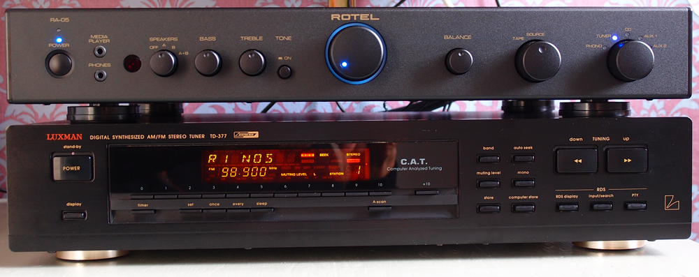

I have recently got seriously into stereo tuners since I found a Luxman TD-377 in good condition (pic attached) and cheap in a 2nd-hand shop: 10 euros. I thought why not? It's a really well-build tuner, has that RDS thing you can read what's playing, has 25khz tuning steps, etc... Once at home, I hooked it to the amplifier and I was astonished by the sound. Then I discovered several FM stations here in the Netherlands airing nice music...
Ok, other than listening CDs and music stream from the Web via an USB D/A audio adapter into the Integrated, now I'm also enjoying FM radio frequencies. Now, the thing is that I found another nice looking tuner for the same price in another 2nd-hand store. The Sansui TU-317. Having knowing that Sansui never did crappy (now vintage) gear, I decided to buy the other tuner, so I now have one digital tuning (Luxman) and one analogue. I want to keep both machines. I'm not a tuner expert but I think the price paid for them was good.
So my questions are:
