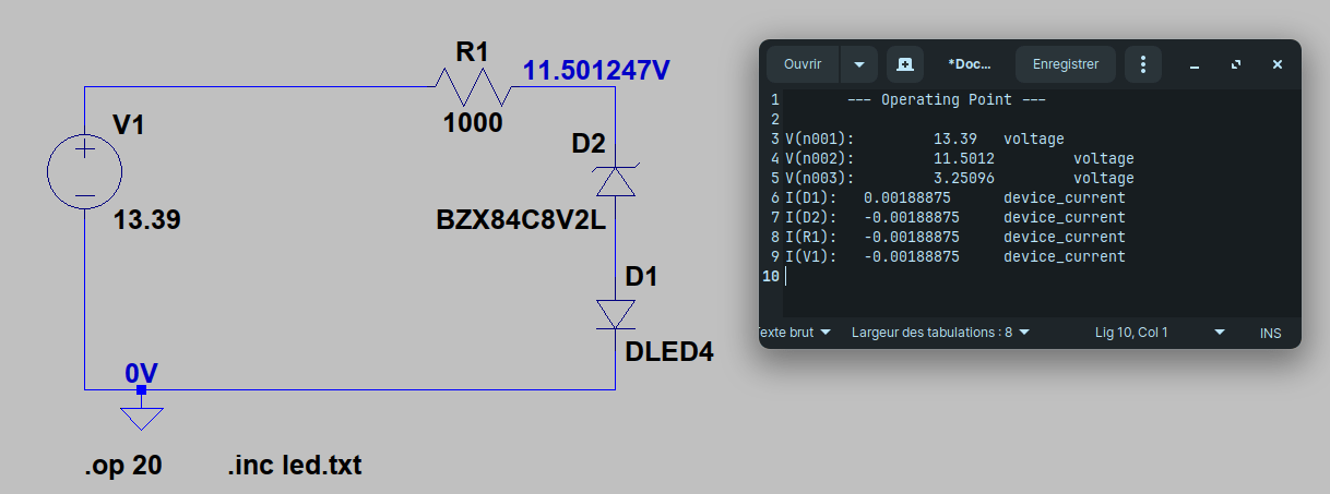

Osvaldo, let's explore your suggestions a bit. I used a resistor of 1000 ohms and then a zener diode to shut off completely the LED as there was always a bit of current bleeding. As below:
Should I have put the zener first then the resistor? Does it matter?

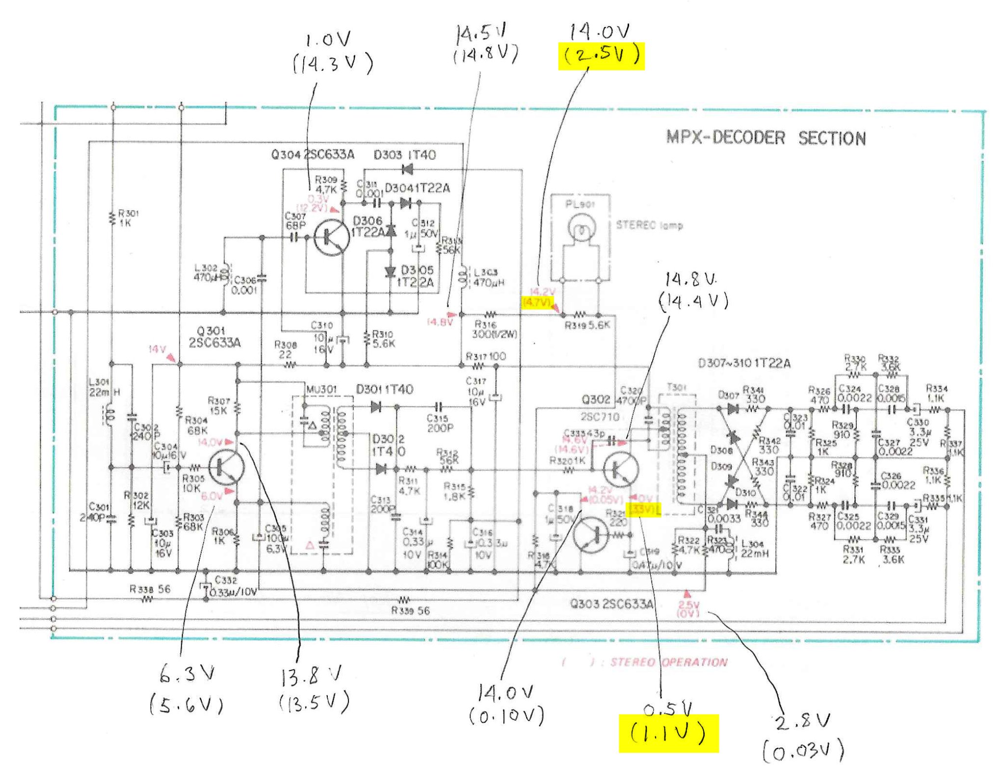

For the full circuit, you can see it here. Is the resistor you are talking about R319?

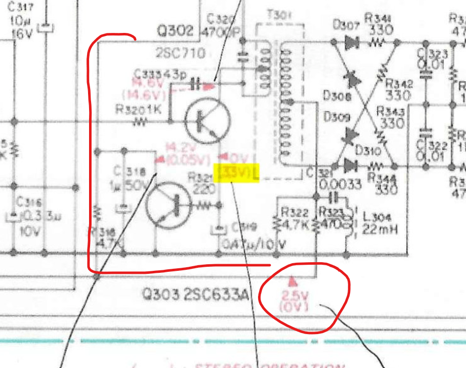

Just quickly skimming through this... and it looks to me like the bulb could be a vital part of the circuit.
I think an LED would light between stations because there is a conductive path via R318 (I think that's the number... its blurry)
From the original configuration of a bulb try replacing R319 (the resistor across the bulb) with a 150 ohm. That gives approx the same current as the bulb which seems to be about 33ma based on the voltages shown.
When Q303 is on and which is the state to light the bulb you will have about 4.5 volts across the new 150 ohm. An LED across that in series with a 470 ohm or 1k or whatever suits to get the brightness you want should work.
When Q303 is off there is only around 300mv across the 150 ohm which will not light the LED.

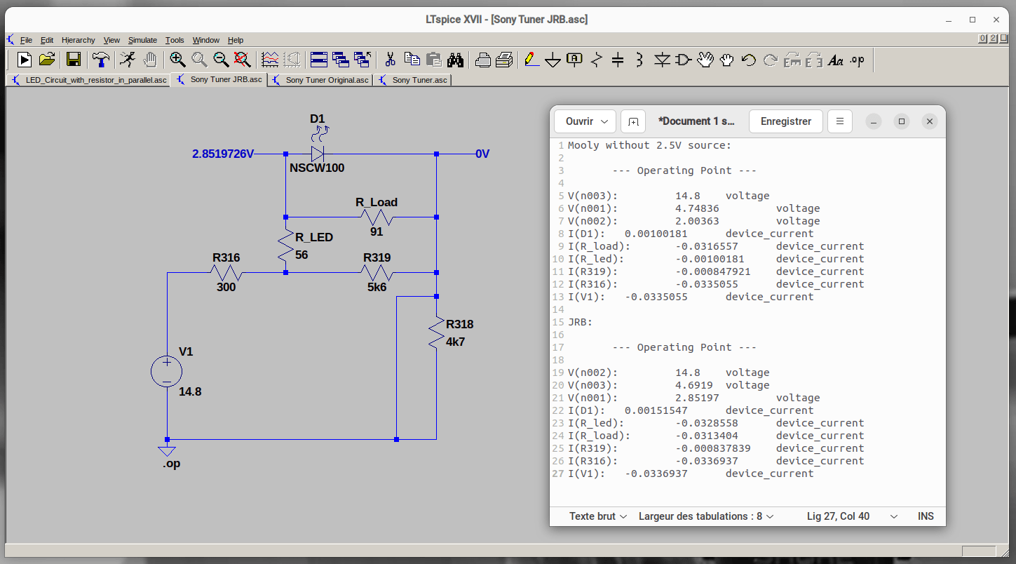

I looked at the voltages on the circuit which show 14.8v as a rail voltage applied to R316 and 4.7 volts shown on the other side of the resistor. Current has to (14.8-4.7)/300 which was 33ma. It may not be all that critical and I wonder if R319 across the bulb is to maintain a current in the event the bulb fails.
So a modified bulb might look a bit like this. LED current approx 1ma here:

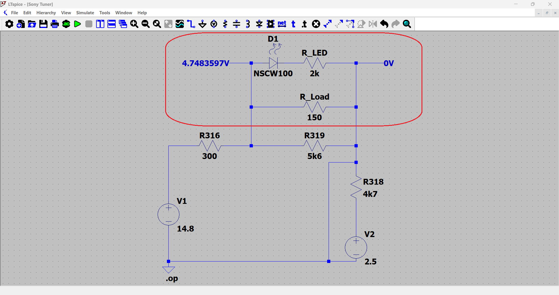

Thank you Mooly for this. You were a good teacher, I had already designed my own with LTSPICE. For understanding, I have modified yours so our designs look alike.
First, I was confused as to why R318 was short circuited but I assume it is because of conducting transistors. Right?
Also, I think that we need to remove the V2 source as it is 0V with the stereo signal on (value in parenthesis in the schematic). The design I had copied from the other forum was like this. Can you please confirm if it makes sense? This gives about 1.5mA to the led but can be adjusted by varying R_LOAD.
Not sure if both designs (yours and mine) work but the important thing is that it shuts off the LED when there is a bit of current bleeding.
Yes and the 2.5 volt source was just to recreate the voltage shown in the circuit when the transistor is off. The voltage across the LED is around 300mv in this case and so it will be off.First, I was confused as to why R318 was short circuited but I assume it is because of conducting transistors. Right?
Jrbastien, in your circuit, the current through the LED is very heavily dependent on the exact value of the shunt resistor - changing that resistor by a few ohms greatly changes the LED current. Mooly's circuit is much less sensitive to exact resistor values. I'd recommend using Mooly's configuration.
Actually, I thought it could be of some advantage to be able to change the LED current. If 1mA is too dim for instance. Anyhow, I will try both designs and will let you know.
