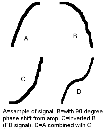

When going through the feedback dilemma personally, I drew what seemed a logical conclusion from what I had experienced. Feedback will do little damage to a signal that doesn't need it.
The more the fed back signal resembles the input it's fed to, the less damage, it would seem.
High frequencies are often subject to phase shift. I have attached a drawing. It might be conceptually illustrative if not typical.

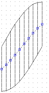

You didn’t say exactly what you had concluded from your sketch (post #108), but the implication of sketch D is that you’d get some sort of non-linear output or something “kinky” with higher frequency content than the original, simply by adding a phase-shifted and inverted sine wave (or a time slice thereof) to the original sine wave. This simply cannot be true because:
sin(wt) + sin(wt+p) = 2cos(p/2)sin(wt+p/2)
Where w = 2*pi*f, t = time, p = phase shift in radians (any arbitrary value)
The sum is simply a sine wave at the SAME frequency as the original, but phase shifted by p/2 radians, and the peak amplitude is now 2cos(p/2), a constant (this term is not a sinusoidal wave itself since it is not a function of the variable t).
I’m not jumping into the “feedback is good” or “feedback is bad” argument right now, but at least I wanted to suggest that your sketch might be misleading you. If you very carefully redraw the sum of two sine wave sections, maybe using Excel to calculate points along the way, you’ll see another clean piece of a sine wave which crosses through zero without the flat spot in sketch D.
Ok Brian, good call. I remapped using calculated values and cad. I should learn not to draw sinewaves by hand (at least without some kind of feedback 😀 ).
It reminds me of one of my teachers trying to draw envelopes. We used to laugh at them behind his back. Karma hey? :dead:
Anatech, I still live in a land of confusion, but what you said is starting to look good. Maybe its time to look at fixing that OPT rolloff.
