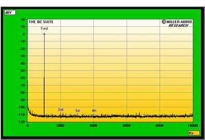

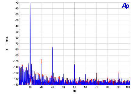

Thanks for the graphs. Interesting that H3 & H5 seem to be the same between the Push-Pull and the SET. It the H2 that's so much lower on P-P (as one would expect). So that low H2 offers little or no masking of H3.
Funny that H4 is MIA on both amps. That is also what I see on my little 6V6 SE amp.
You should've seen what P-P transistor amps typically show. 😱 I'm only saying it because this is tube amp section. 😉Thanks for the graphs. Interesting that H3 & H5 seem to be the same between the Push-Pull and the SET. It the H2 that's so much lower on P-P (as one would expect). So that low H2 offers little or no masking of H3.

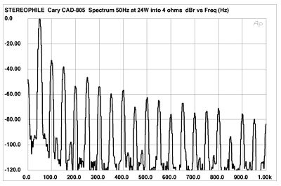

That's a bit unfair, SY. Look at the X axis. 😉
Might be pounding that OPT a little hard.
(Or it might explain why I've always had my doubts about the 845 tube.)
