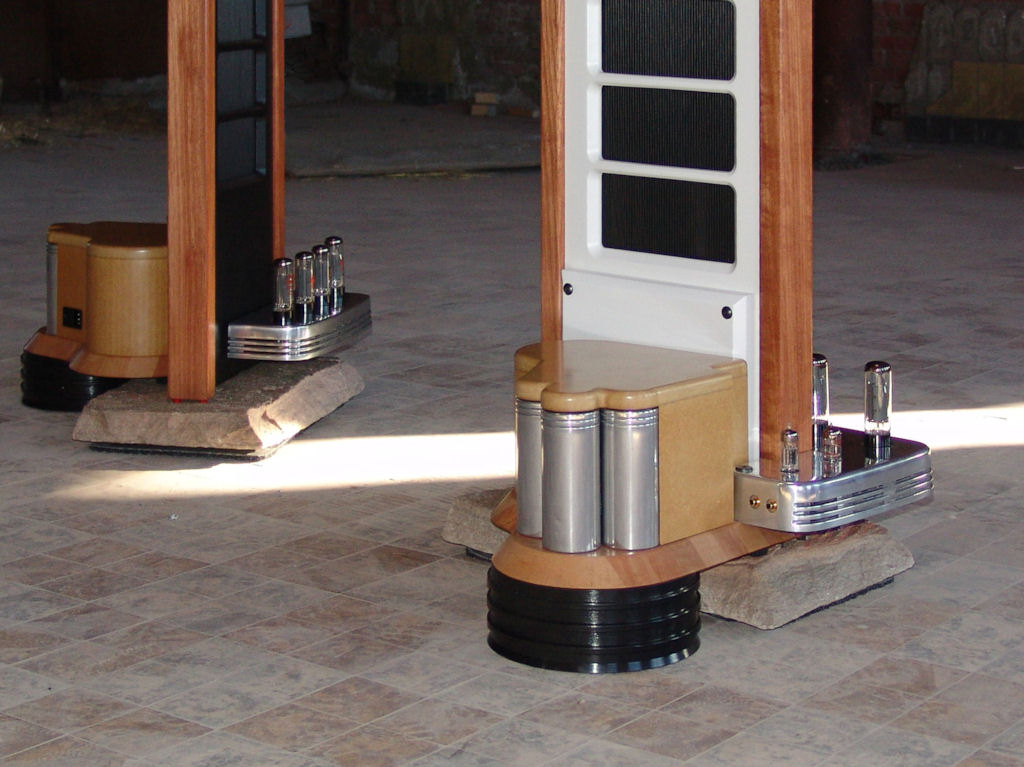

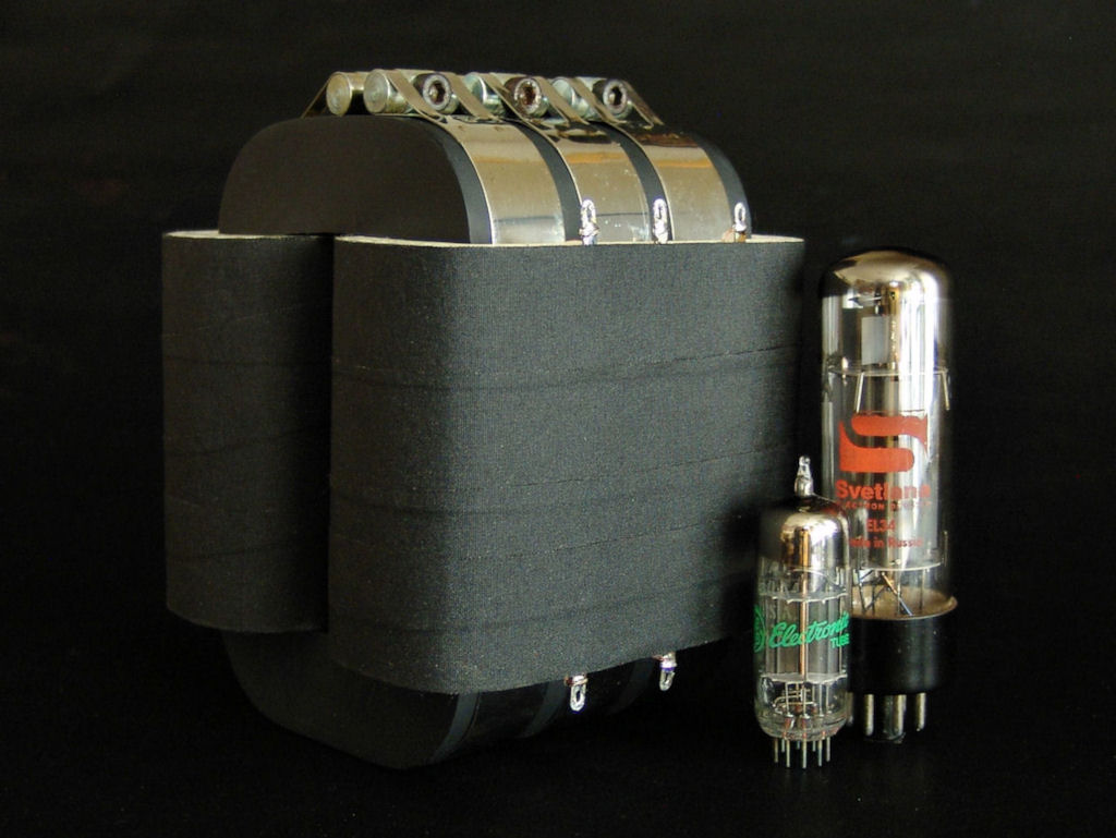

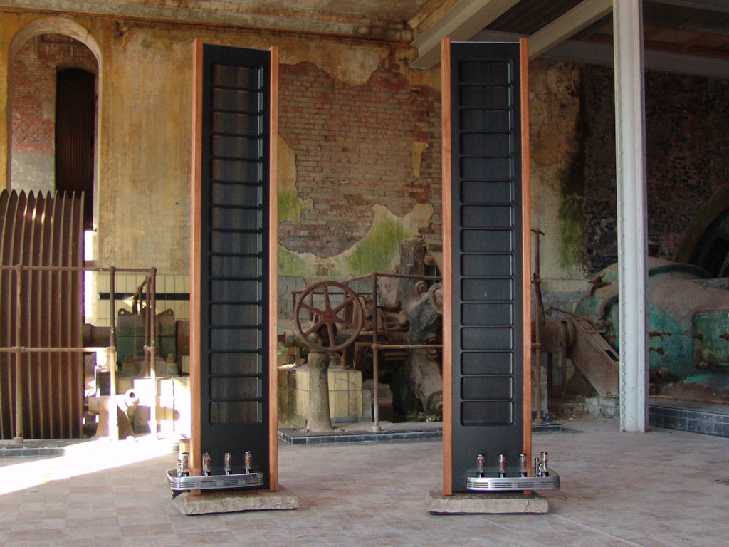

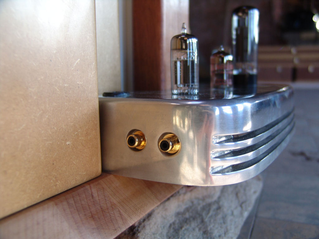

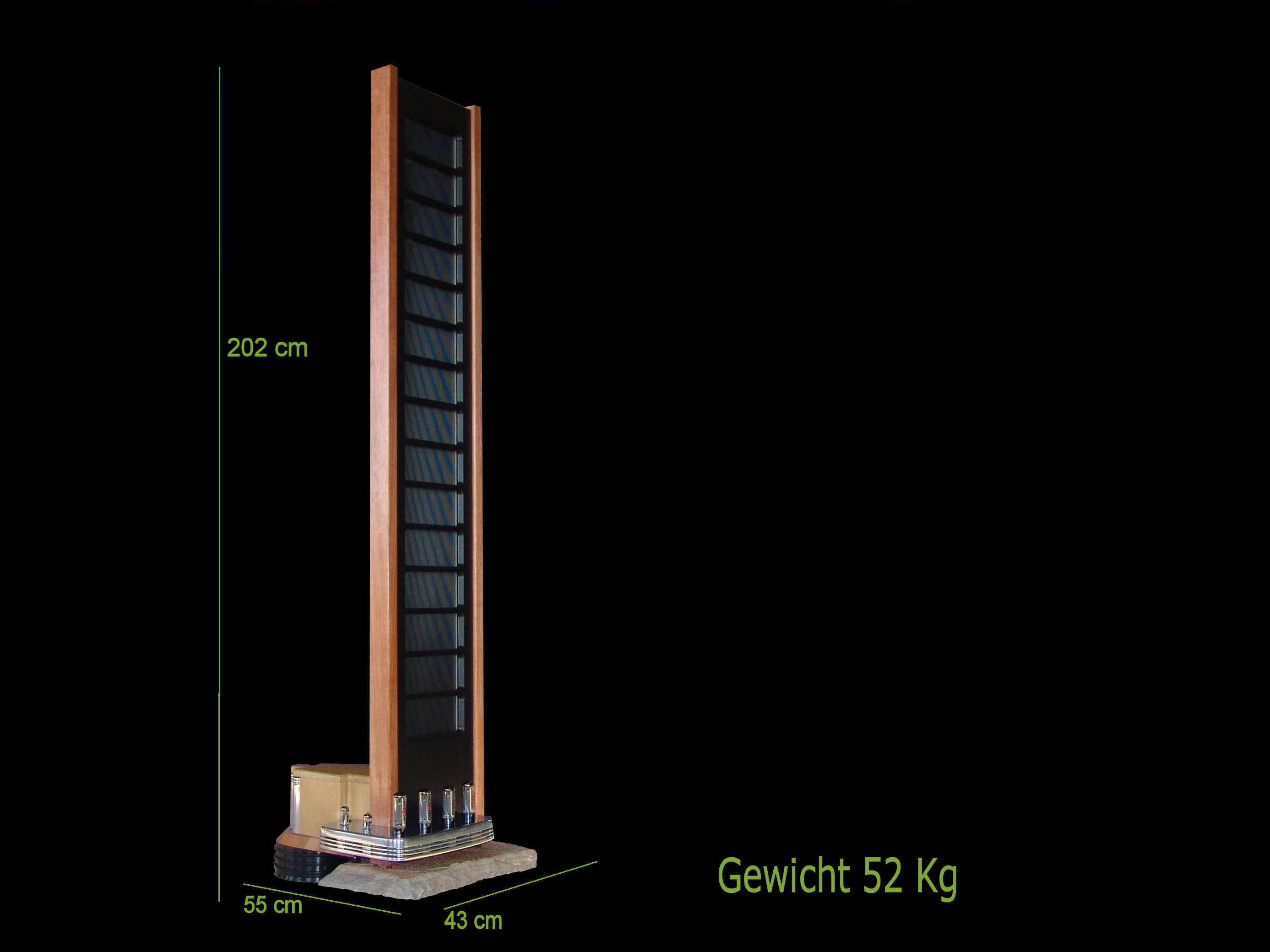

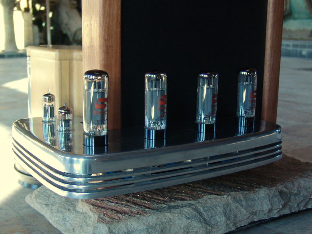

how about this trans......may be key.....
well there be feed back from the tubes......yes..in more way than one......cool look..........
