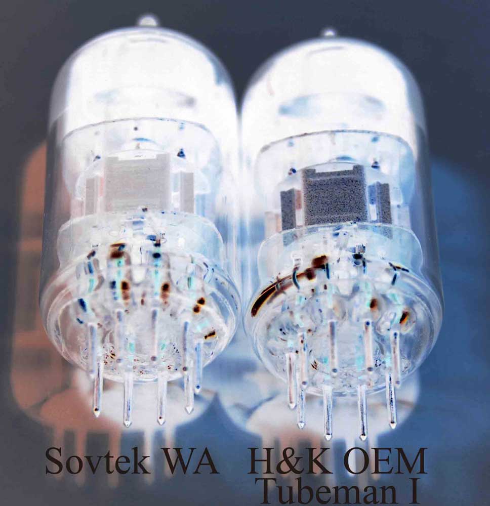

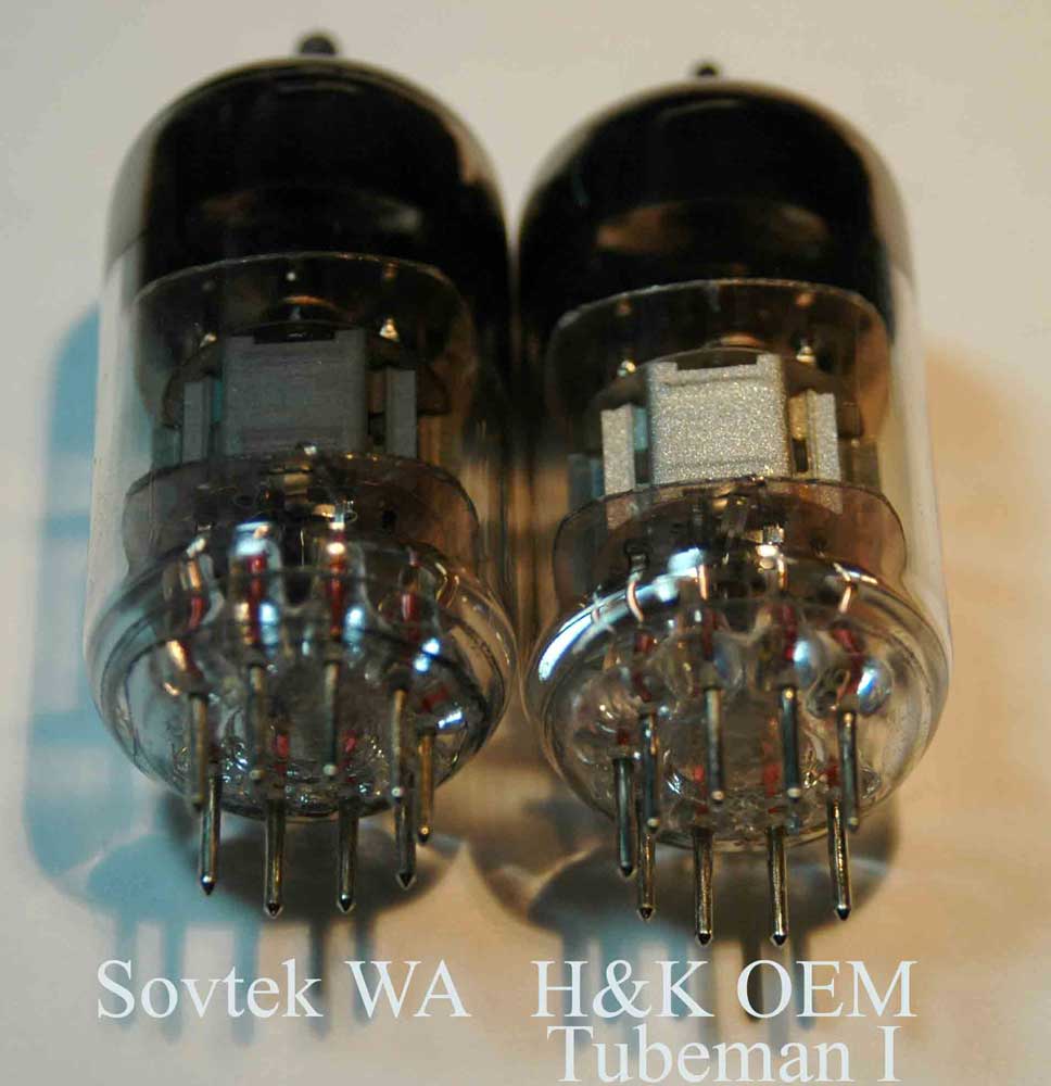

My original tube was totally generic and I think it is a Sovtek 12AX7 b/c I have other Sovteks without markings that look very close: it think the Tubeman tube was glossier on some plates than the Sovtek. My guess is that Sovtek made the tube and probably custom for the application. I still have it - I'll take some pictures and post later.

Pictures!
I've included the inverse for clarity.
I think I will try an old Mullard ECC82... I'll post my impressions
I gues the limitation to 100k is cumulative...
BTW ECC82 sounds really great - gives the pedal way more head room and makes the gain adjustment on Rock and Blues much more useful. Also, the pedal has noticably improved it's touch sensitivity. I think this is the best it has ever sounded.
