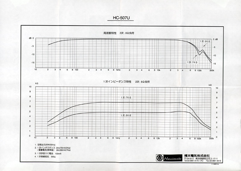

I'm currently planning to build a Tubelab Simple SE amplifier, and I'm at the stage of choosing output transformers.
My initial plan was to use the Hammond 1628SEA, but after some research, I'm considering other options that might offer better sound quality.
I've been eyeing the Hashimoto HC-507U and Iso FC-20s. Both transformers are smaller and lighter than the Hammond, they deliver 20 Watts vs 30W for the Hammond.
I'm concerned that they might not be powerful enough for my speakers, which are Monitor Audio GS20s rated at 89db (6 ohms). My room is quite small (4x5 meters), so I guess don't need an overly powerful amp.
I'm hoping to get some insights from experienced tube amp builders on this matter.
Would you recommend the Hashimoto HC-507U or Iso(tango) FC-20s for a Tubelab Simple SE, or would the Hammond 1628SEA be a better choice ?
Any advice or recommendations would be greatly appreciated. Thank you in advance!

Roger,
The interesting thing about the BIG Hammond rolling off the highs it that it is not due to it being low quality. Rather, it is simply too big for the power delivered by the SSE and typical tubes. The goal is to match the OPT size to the output power. In the case of the SSE, the sweet spot is "10-15" watts. I use quotes here because any wattage rating needs to be taken with a grain of salt. As George explains (and I am sure you have read) the weight says more than the wattage rating.
Example:
Edcor XSE15-5K is a "15 watt" OPT. It weighs 1.6lbs
Transcendar TT-338-OT is a "10 watt" OPT. It weighs 4.2 lbs.
What is going on here? Well, if you dig a bit deeper, you realize that the Edcor is rated 15 watts at frequency response of 70Hz-18KHz, +/- 1dBu. It can produce 20Hz for sure, but probably only up to 3 or 4 watts (if that). The Transcendar is rated to do 10 watts at full bandwidth, and it does.
The biggest downside of going too big isn't the rolled off highs, it is the price you pay in efficiency. You have relatively inefficient speakers, so you don't want a big OPT wasting a full watt or more of your power.
I suggest you look at the specs of the OPTs you are considering. Specifically the weight and the frequency response that the wattage is rated at.
I discovered that the Hashimoto weighs 4.4lbs and the frequency response at the full 20w looks good to me. Yes, they roll off on the low end, but you are only going to be pushing half that wattage (at the very most!) so these OPTs will do just fine. Most of the time you are probably going to be using 1 watt*:
I can't imagine you would be disappointed or be missing anything. I wouldn't hesitate to use them, that is for sure.

Thank you all for your answers and sorry for the late reply.
@cogitech that was exactly the answer I was looking for
The HC-507U turned out to be cheaper than expected, I ordered a pair.
