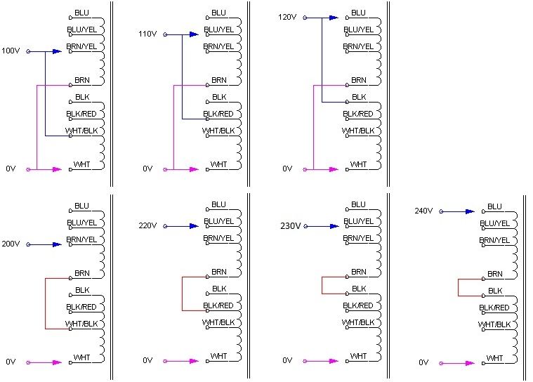

Hi there -- I'm building an SSE to work on UK voltage (nominally 230v). Apart from making sure I get the correct power transformer (thinking the Hammond 374BX), are there any additional modifications I need to make? Does the 50 vs. 60Hz have any influence, for example? Or is the output from the transformer identical regardless of the input voltage?

Different voltages are possible on the primary side.
This also changes the voltages at the output a little.
The behavior can also be used to make adjustments.
50 vs. 60 Hz has no influence.
