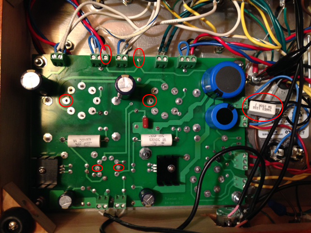

Yes, I'm skeptical of myself! Here's what I measured again tonight, with a bit more detail. Tell me if I'm either measuring wrong or if there are other things that could help...
B+ at 462 volts (seems to ramp up to around 460 then creep slowly higher). I am measuring this at the end of R4 closest to the edge of the board, or for more convenience I'm also measuring this using the T2-PRI connector (red wire to my output transformer).
Output tube cathode voltage 30.4, measuring using the octal socket pin closest to R17 or R27.
Does this sound right? It doesn't seem to be in the same range as George's simulation tables which seems to show cathode voltages higher for that range of B+. (As mentioned before, I'm using 560 ohm cathode bias resistors.)
I also tested the driver cathode voltage at 2.0 volts, measured at the pins horizontal to the board on each side.
I attached a picture of my amp interior, with circles hilighted where I tested voltage. Note also the extra resistor I added in line with choke to reduce B+ from high 470s down to 462-464.
Is there something else I can measure to help affirm things are ok or not? Where does plate voltage fit into any of this? I will say, the amp sounds great! So I'm happy, but still feel the question is whether something is off and I'll wear out the tubes or other components given the B+ and possible high temp.
For context, I'm using an Allied 6K7VG power transformer and Edcor GXSE10-8-5k output transformers. And all JJ tubes: EL34, ECC81, GZ34. I'm not using solid state rectification (don't even have the diodes on the board).
Thanks again!
All the other measured voltages and how you got them seem correct to me. PSUD2 predicts 455V of B+ with an additional 150ohm resistor, so 462V sounds reasonable. Have you checked the secondary voltage on your PT to see if it's running within tolerance?
In my very non-expert opinion, you're probably good to go. Sorry if I worried you. Perhaps someone else can suggest a way to verify everything, but I can't. Enjoy your amp!
