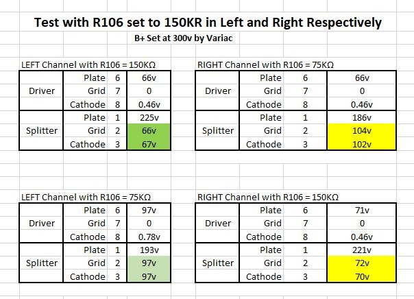

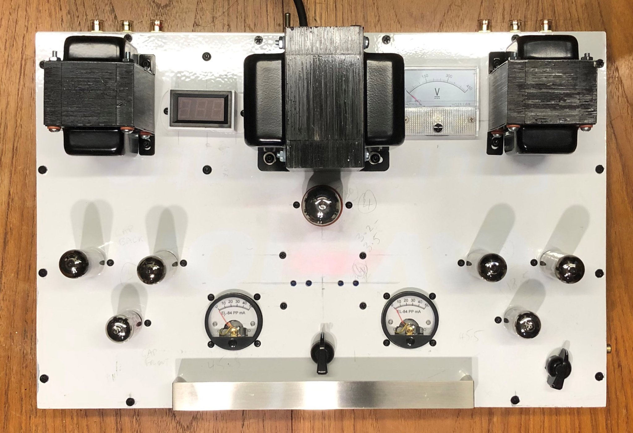

I have built a point-to-point version of Tubelab's SPP amp and had some difficulty understanding how the bias of the phase splitter section of the 12AT7 works. When first built, using the specified value 75K resistor as R106, the grid voltage on pin 2 was a couple of volts higher than the Cathode voltage on pin 3. For example, 72.2v on pin 2 and 70.6v on pin 3, when B+ is around 280v. I changed R106 to 150K ohms, which nicely turned this difference around. This approach was a suggestion by rknize on the SPP thread in the Vendor's forum. FWIW, I'm using new reissue Mullard 12AT7s
Is there a simple explanation for how this splitter is biased that anyone can offer, or refer me to, that would explain how the tube is biased and why changing the 75K resistor to 150K worked, and whether that's the best resolution of my bias issue? Thanks in advance for any assistance on this.

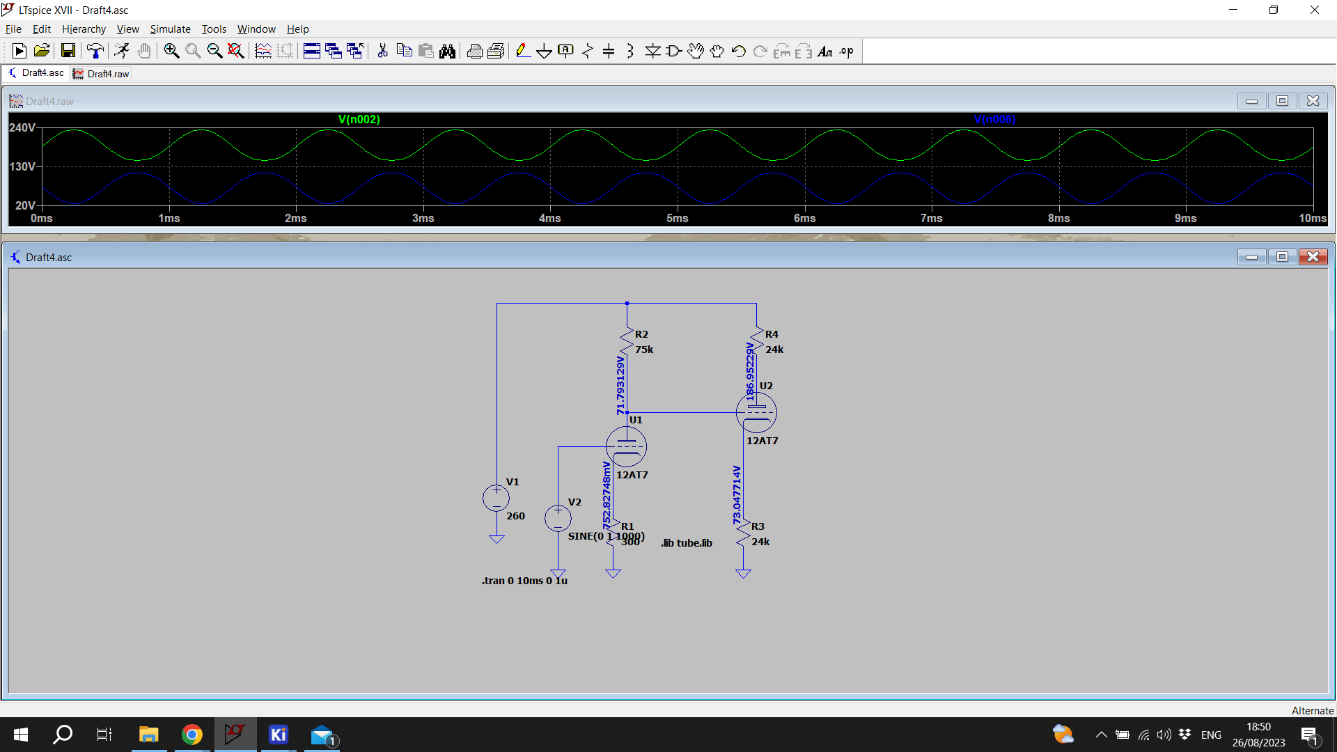

There is a good explanation of cathodine calculations at valvewizard site: https://www.valvewizard.co.uk/cathodyne.html
The first section of the 12AT7 is a typical voltage amplifier stage. Its plate voltage is determined by the plate load resistor (R106) and the cathode voltage which is determined by the total drop across the combination of R102, R103 and R104 which is grounded through the OPT. This should give you about 1/3 of the total B+ voltage on the plate (pin 6) which provides the bias for the grid of the second stage and eliminates a coupling cap in the signal path.

Thanks jcalvarez for the ValveWizard reference - and I see that there's a more in-depth and technical treatment at https://www.valvewizard.co.uk/cathodyne.pdf. I checked, double-checked and re-checked the resistor values, but baudouin0's LTSpice sim does not reflect the voltages I seem to get. See table below. So I'll have to check one more time.

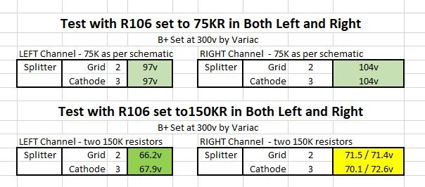

Just now, I've run voltages again on both 12AT7s, with R106 set to its original-spec 75K ohms on the Right Channel and the altered 150K ohms on the Left Channel. Then I reversed the situation, so R106 was 150K on the Right Channel and the original 75k ohms on the Left Channel. I tried to keep B+ close to 300v as possible. Results shown below. Although previously, the 150K substitution seems to fix the grid bias in the splitter, it clearly is not doing so now - particularly in the Right Channel, which is where I've had some variability before.
I also get fairly different voltages between right and left channels.
I also ran voltages with both channels using stock 75K R106s, and with both channels using 150K resistors. This further suggests I may have a slight intermittent fault somewhere in the right channel splitter circuit
So I think I need to go back and triple check for dry joints and correct component values .... again. Thank you very much everyone for interest and comments so far. Back to the building board! More later.

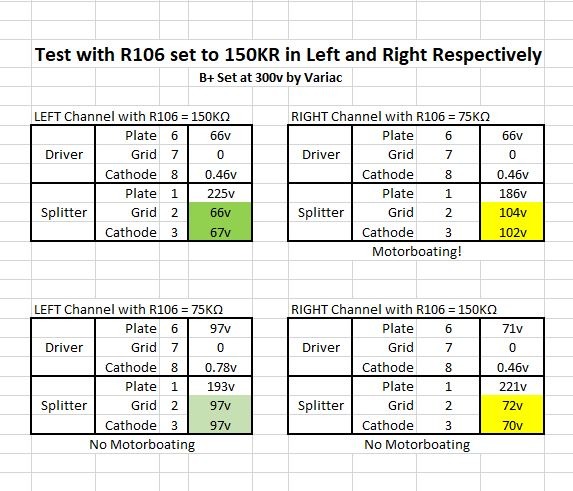

Interestingly, the amp sounds fine in my cheapo test speakers in all these
configurations (except when it motorboated badly with 75K R in place, when the the multimeter probe was connected to .

Thank you huggygood. The house mains voltage was around 235v - 240v, for all tests, but used a variac to adjust the AC on the PT primary to keep B+ close to 300v for the tests as noted on the results.
I can easily swap the 12AT7s around and repeat the test - perhaps tomorrow. I could even try some other (new) 12AT7s I have, if folks thought that would be diagnostic.
The RC values in both left and right FB loops are 5K1 and using 390pf as a starting point. Feedback uses the 16 ohm secondaries but speakers are connected to the 8 ohm taps.

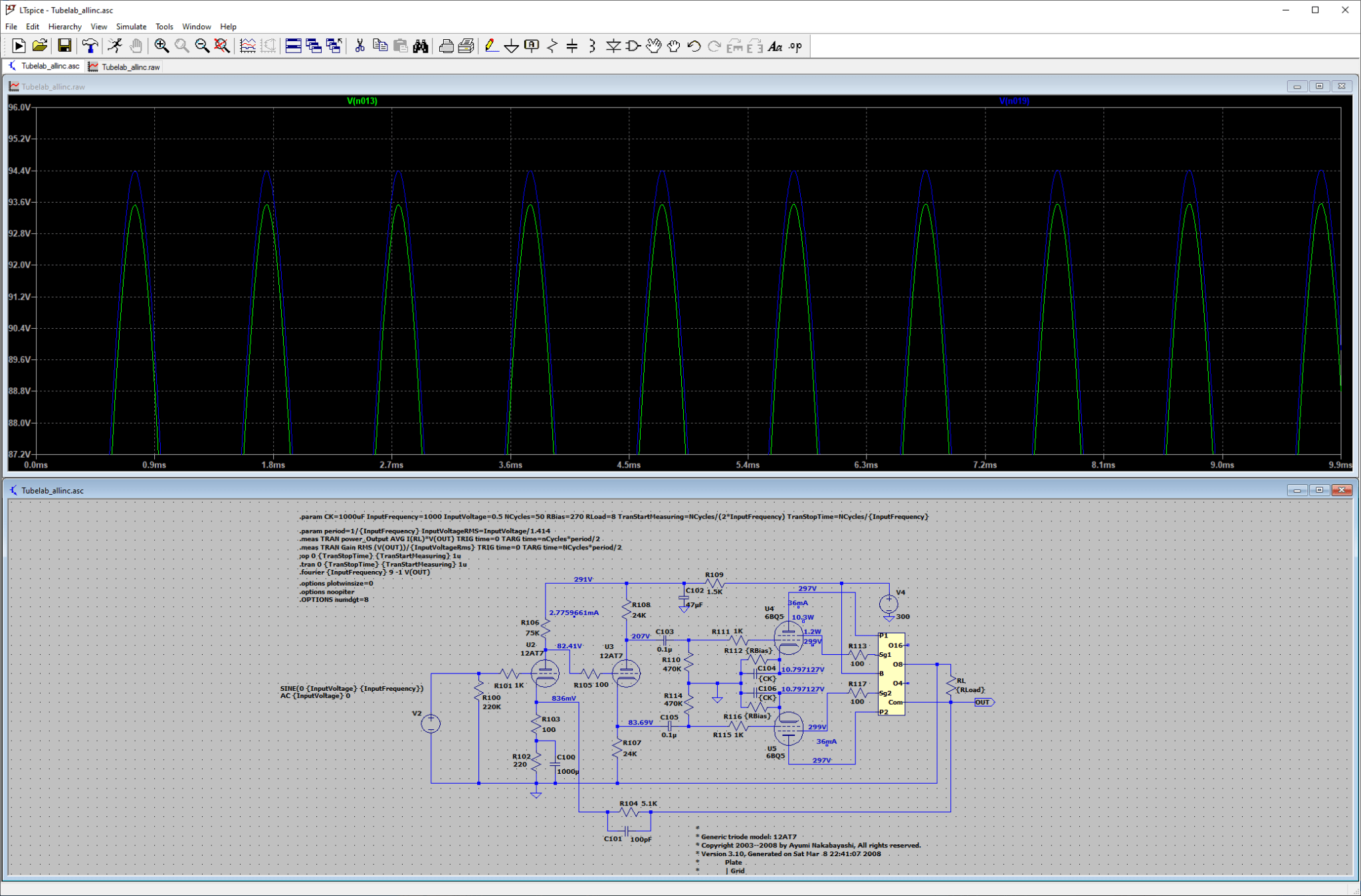

Using Adrian Immler's model of an Electro-Harmonix 12AT7 in LTspice, it looks like even with +320V B+ the 2nd (cathodyne) stage 12AT7 will be running with a little positive bias, guaranteeing grid current.
Substituting the Ayumi N. 12AT7 model, grid bias on the 2nd (cathodyne) stage is around -1V, which is probably OK.
Substituting Adrian I.'s RFT ECC81 model, grid bias on the 2nd (cathodyne) stage is -0.7V, which is better than positive bias!
It looks like that confirms the New Sensor/Russian 12AT7s bias up differently than vintage US and Euro 12AT7s, and that could be what is causing the zero bias condition here, especially with the lower than designed B+ of only +280V. Perhaps reduce the value of R109 to 820 ohms and increase the value of C102 to 100uF?

Looking at the voltage table for "Right Channel with R106 =75k" I see a pin 6 voltage of 66V and a pin 2 voltage of 104V.
That's not possible, rather those voltages should be essentially the same.
I suspect there's ultrasonic oscillation involved.
Oscillation is sometimes triggered by connecting a probe.
With oscillation most DC voltages might be off and meter readings are not reliable.
Oscillation in the PI circuit should stop when you pull the EL84s or when you disconnect the NFB.
Use your scope.
Reactions: Simonism
Thank you jcalvarez for the full sim - yes, I see the Cathode staying about 0.8v higher than the grid.
Thank you Rikaro. You have sharp eyes. I made a transcription error from my notes - I'm sorry. With "Right Channel with R106 =75k" pin 6 voltage was not 66V as I wrote - it was actually 104V, the same as the pin 2 voltage. I have disconnected the NFB lines to take that out of the picture; the amp plays noticeably louder now but I didn't really notice any loss of quality.
For the next measurements at 300V B+ with R106 at 75K, I swapped the 12AT7s around : pins 2 and 3 in the left channel both close to 105V now (grid bias Vkg about -0.01V) and on the right both pins 2 and 3 were around 98V (Vkg about -0.06V) - so the slightly higher/lower voltages changed channels with the 12AT7s. So ... this negative grid bias is still very small using 75K R106s.
I also tried R106 at 150K with the swapped 12AT7s and got much better bias of about 1.6 - 1.7v, which is nice.

I mucked around in LTspice for a few minutes with the stock SPP circuit using 320V B+ and Adrian Immler's (Russian) Electro-Harmonix 12AT7. It looks to me like this particular 12AT7 requires higher plate-cathode voltage to get its grid bias away from zero volts. With EH 12AT7 I see -0.8V grid bias on the first stage, but slightly positive bias on the second stage. If I then substitute cogsncogs's (Ayumi method) GE 12AT7 model, the difference is dramatic -- the first stage biases at -0.9V while the second stage biases at -1.3V. That looks like what was intended.
George mentioned earlier that he designed the circuit using vintage US 12AT7s, and it looks like Russian and Chinese 12AT7s are different enough that they don't work well in this circuit. Perhaps find yourself a pair of decent American or European 12AT7 or ECC81 and try them out? That could be cheaper in the long run and a lot less work than re-designing the SPP to suit these Russian 12AT7-oids.
