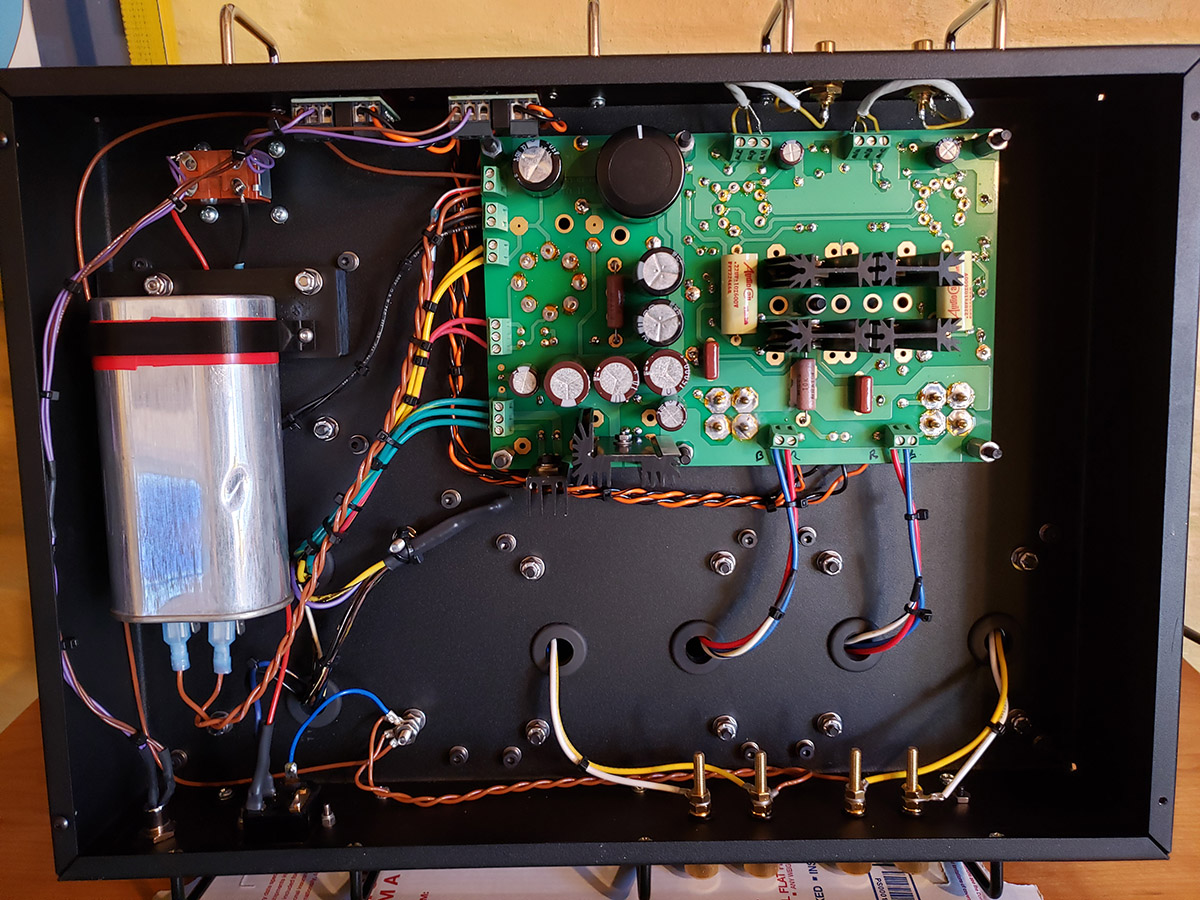

I had trouble with Hammond 276 and 376X power transformers running REALLY hot so ended up going to a B373EX which is HUGE, but runs really cool. Used Edcors for outputs and mil-spec Vishay-Dale resistors (Mouser) or matched ones from Sonicraft.
All of the resistors are mounted on the top and caps on bottom. Board is mounted with 1/2" long standoffs to give clearance for the resistors and put the tube sockets about flush. All the board mount and transformer mount screws are 10-32 button head screws.
Super oversized heat sinks on the mosfets and power IC which resulted in this chassis arrangement with digital current meters for bias monitoring.

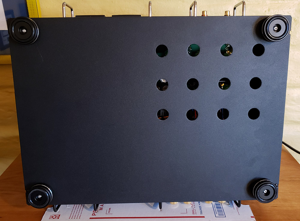

I used Greenlee chassis punches for the tube and switch holes as well as a bunch of vent holes in bottom cover.

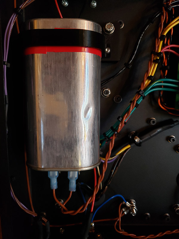

I have large motor run cap set in the underside of chassis in a 3D printed clamp.

Well you caught me on a not lazy day. Here are pics of underside. The layout meant that the transformer leads were long enough without having to extend them. I used shielded mil-spec 16g for the inputs and hum in 94db/w speakers does not exist. The rest of the wiring is stranded 16g mil-spec except AC power which is 14g.
The run cap is a Dayton - dont remember part number but found it at Grainger and its oval rather than round so it fit perfectly underneath.
And I learned - drilling a lot of holes in sheet metal kinda sucks but if you drill small holes and use a step drill things are faster and cleaner.

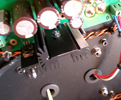

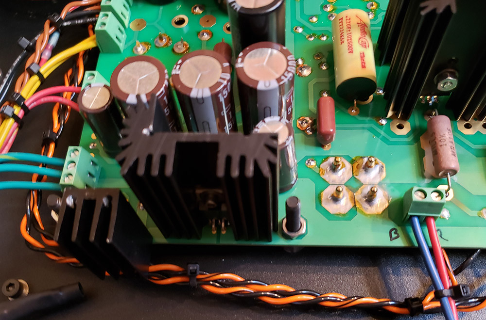

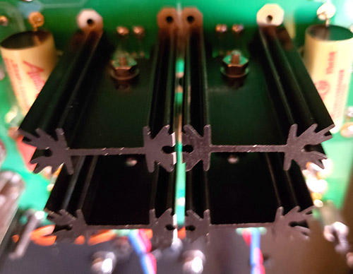

So here are better pics of heat sinks. The tall ones on mosfets had to have fins where they come together milled off so they were not in contact. The mount pins dont fit the board holes so they are potted to the board and the traces on board were cut to keep them all isolated. Used thermal paste on them.
The regulator IC sink is even bigger and had to be milled to clear caps. All those heat sinks are like 2" tall and have a lot of mass. Havent had overheating issues yet.
And the orange and black twisted pairs are how I am feeding the current to the front meters.
