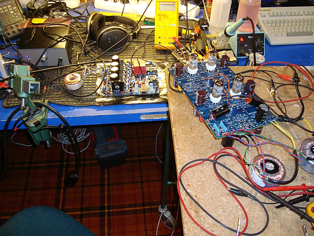

No improwement. I think it's finished more or less. I had the intension to make a nice box and get it i shape for use, not only on the workbench.
Thats when my energy went lost. It has it's place on the project shelf.
I guess the most fun is the road until the project is finished. The last part gets boring.
