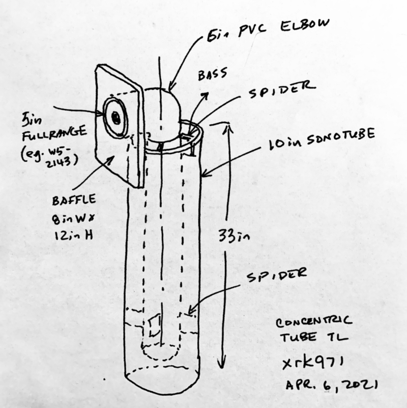

I'm still intrigued about the angle the rear radiation would hit the side walls, I think they'd reflect off down the tube and not be directed back towards the cone.
It could well be an issue with a FR as with the P7.
Note that given the typically large bezels on the MAs (smaller on the new baskets), the appearance of being close is a bit more deceptive than something like FF85/FR88ex/FaitalPro 3FExx.

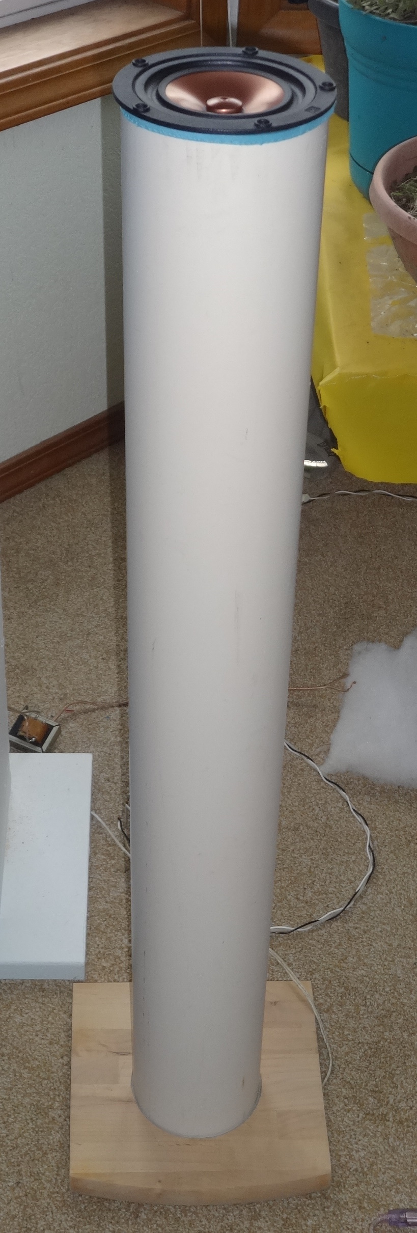

But with a 4” FR i would not use less than a 5” pipe. 4” is for 3”.
He is using it for braekin, an dwill provide a bit more loading than sitting on their magnets on a shelf like i do.
It should only get better once switched to the intended boxes.

New drives
Well my new markaudio CHR 70 gen 3 drivers have just turned up, and I have to say on initial inspection I'm not that impressed with the build quality they look very flimsy, I know the basket was plastic but I was hoping for something a bit more rigid. Let's hope they sound better than they look.
Just need to decide on the cabinet for them now.
The plastic baskets are quite stiff if not quite as refined as teg Alpairs,
Do keep in mind\d the CHR is the “inexpensive” MA line.
dave
dave
To answer my own question, they do sound better than they look. I housed them in the end in one of your designs ( mini tower) It has whetted my appetite for a driver higher up the markaudio range for the same cabinet, 7HD maybe??The plastic baskets are quite stiff if not quite as refined as teg Alpairs,

That is the Trike Voigt pipe from HiFi News & Record Review back in the early 1960 you have reinvented.
http://drboar.blogspot.com/2012/01/trike-from-hifi-news-record-review-50.html
https://www.diyaudio.com/community/threads/rex-baldock-trike-voigt-pipes-hfn-rr-1961.184774/
Interesting pipe DrB. A simiar project (2 sections) was shown in Speaker Builder.
The microTower Herb built is a straigh peope ML-TL.

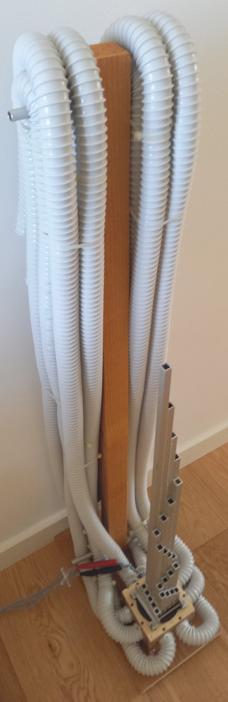

We built the Ypsilon L50 "daline" loudspeakers from PVC pipes in 1982. Maybe nice for inspiration. After 3 decades the PVC becomes brittle when unpainted (the natural light grey color was liked by many) so not many of them around anymore. The series filters were very uncommon at that time but they made the loudspeakers an easy load for the small Class A amplifiers by the same designer. Sound was excellent and I do miss them. Less than a year ago I recapped an old Class A amplifier by the late John van der Sluijs (nickname: "the audiotollah" 🙂 ) and when returned to the owner he said it outperformed his Hypex amplifiers. Nearly all designs had exemplary performance and clever design ideas. Some ideas to be relatively unknown even in 2022.
https://gh54.jouwweb.nl/techniek/geluid-uit-de-pijp
Building/drawings and magazine by the designer (so both the magazine and the loudspeaker were by him):
