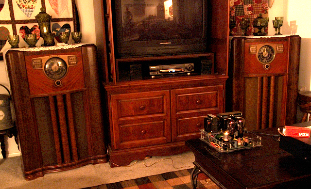

Picture shows the radio / speakers with the 2 watt SET on the table.

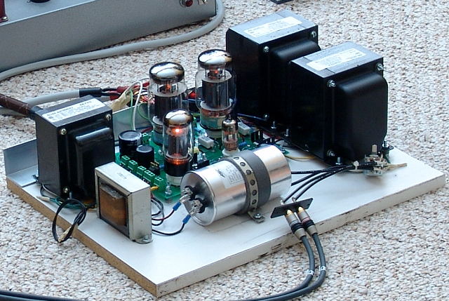

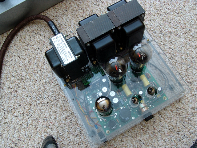

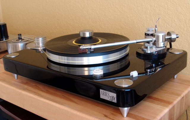

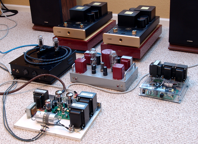

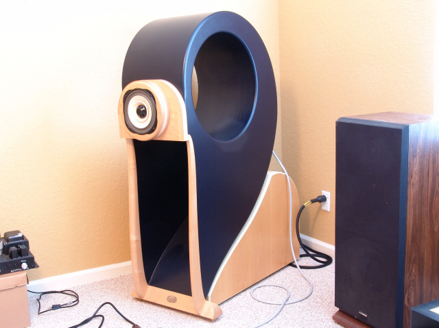

Some pictures of an amp test session
