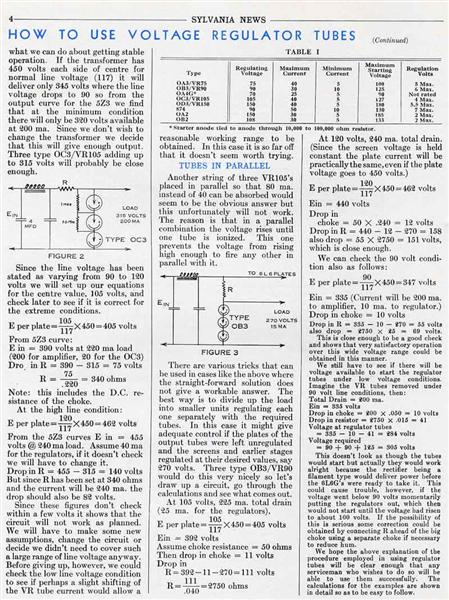

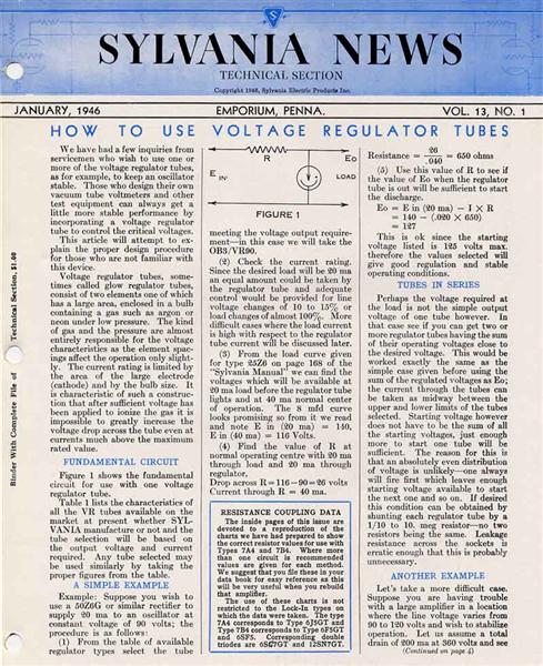

There is a technical paper Sylvania News dated 1-46 and this does a good job explaining.
I tried to paste it but I come up with the file is too big.

Mr. Anatech,
Actually I received the Sylvania information from a gentleman on this site. He deserves the credit not me. I'm sorry that I'm not able to find the link he set up for me in a post he answered.
