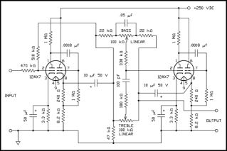

Well, I don't have copyright permission to post the AX version, but here's a schematic of one I built last summer based on the same overall principles; it has some improvements over the original. Performance was quite good, but it just didn't fit into the needs of my current system, so the "nice" build has been shelved for the moment.
That circuit looks a hell of a lot like a Baxandall tone control.
I would highly recomend this circuit. I have used a passive version of the Baxandall circuit before, and it has very impressive results, offering a very wide range of tonal variations considering just two controls, bass and treble... and set bass and trebble both in the middle, and in theory you're getting a completly flat frequency response from the circuit.

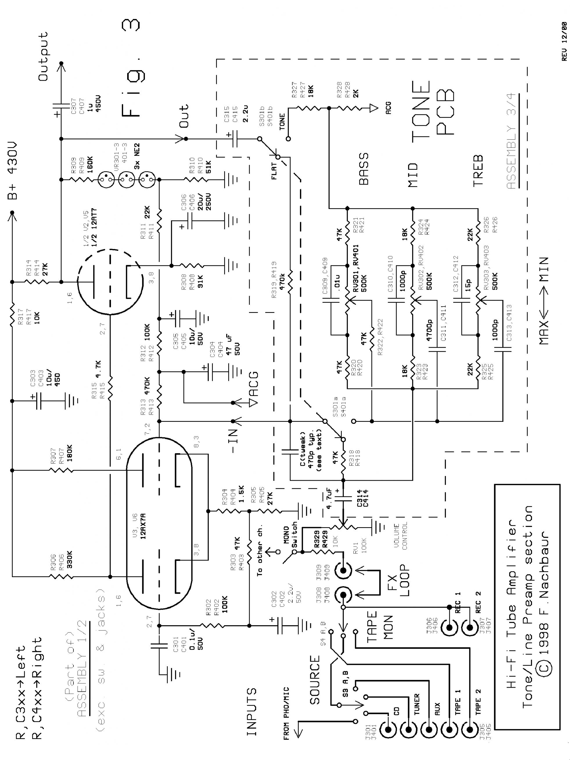

i attached a schematic from an old article i have that is acutually about anode followers... but it discusses Baxandall's tone control in there as this utilises an anode follower, so therefore, in the article, there was provided this highly simplified version of a Baxandall tone control.
I say you should build it... my 2 cents
cheers

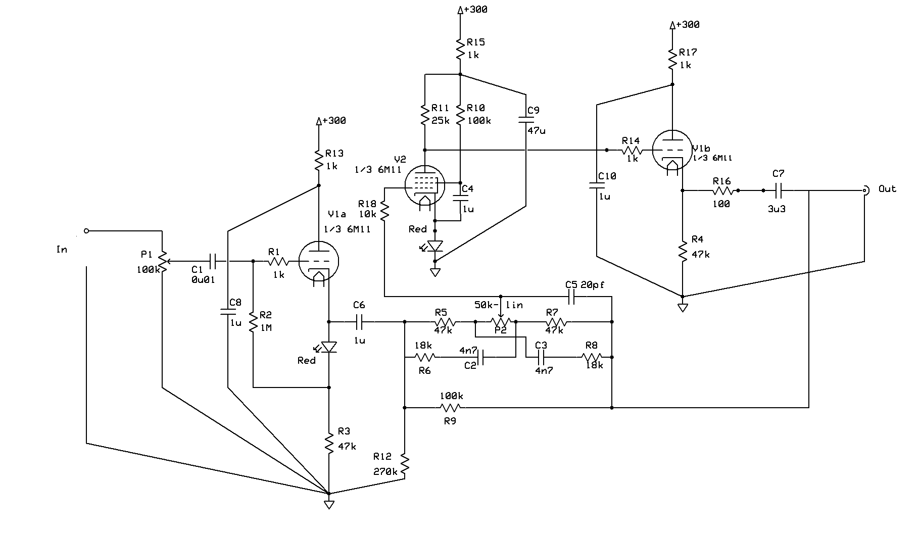

can you please send a picture with values?
Max Robinson's design is "unity" gain. As I have stated previously, the large bottle count (4 for stereo) can be dealt with by replacing the cap. coupled cathode followers by DC coupled ZVN0545A source followers.
Max indicated DC heating. I think AC heating is OK, IF the Sovtek 12AX7LPS, a genuine 7025 equivalent, is employed
